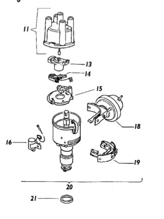

OK, you need an 039 905 271 for that distributor according to the number you provided...
~$150 used (great condition).
Better picture of what it should look like is below...
Dave

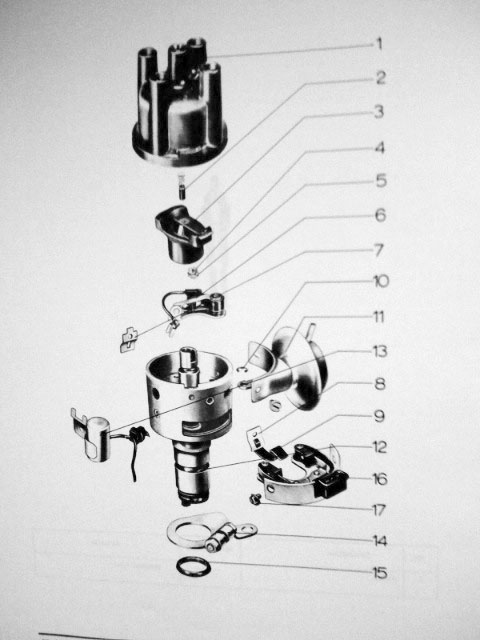

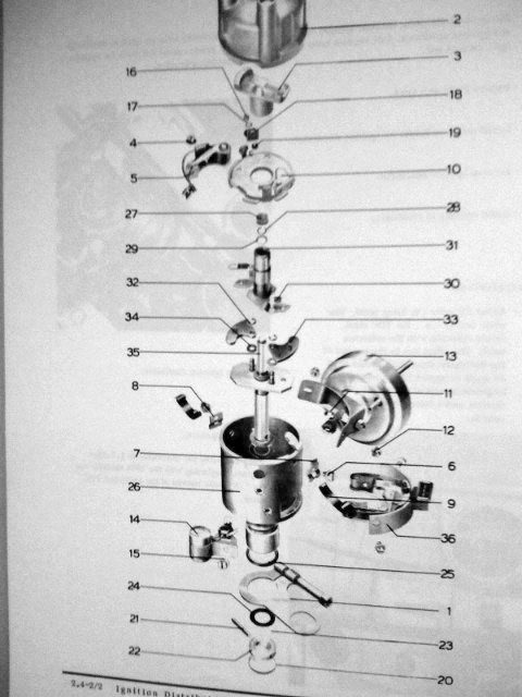

I see what you are saying, but these are from the Factory Service manual,
Early dizzy
Late dizzy
As you can see the photo shows only a single port for the vac unit, and it is on the advance side, I also read in the Factory Service Manual that "late 74" and up did not have the vacuum advance, just vacuum retard ('75 USA Model Year).
So is the second image a generic photo, or is it the correct config?
