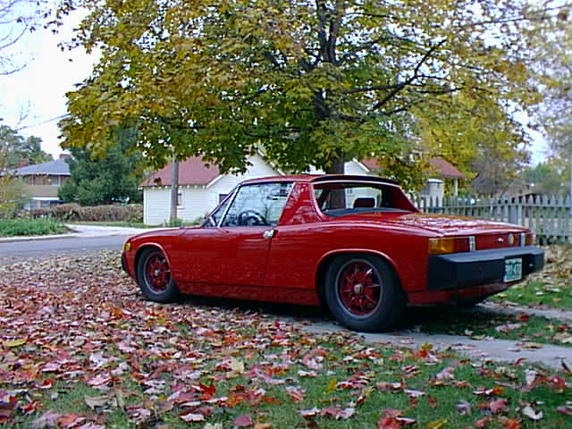

attached is a pic of my new 914 (IMG:style_emoticons/default/driving.gif)

here's a pic (IMG:style_emoticons/default/rolleyes.gif)

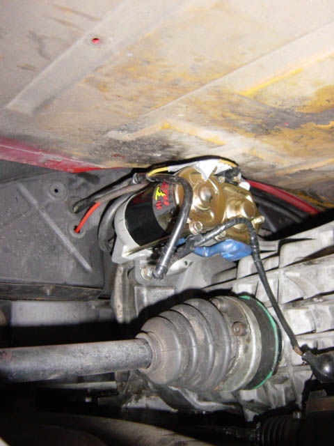

starter is slowly going bad. hot-start relay might help for a while but you're better off investing in a new (or rebuild) starter.
mine did the same, i just bought a brand new high torque starter and it works great now ...
(IMG:style_emoticons/default/wink.gif) Andy

First of all, I missed some detail here I guess. That sure looks like Jon K.'s 914. I didn't know he was even selling his car. Let alone that you bought it. But congrats!
You've got the common, dreaded, "hot start problem". Clean all of the ground points first. Because that could still be what it is despite the fact that you have voltage at the solenoid. If that doesn't cure it, a new stock starter, or a new 911 starter probably will. As others have suggested, you can do the Ford relay thing OR a high torque starter. The latter would almost certainly cure the problem and would be my choice.
I'd ask for pics of the car, but I might actually have more pics of that car than you do. Nobody ever tells me 'nothin.
