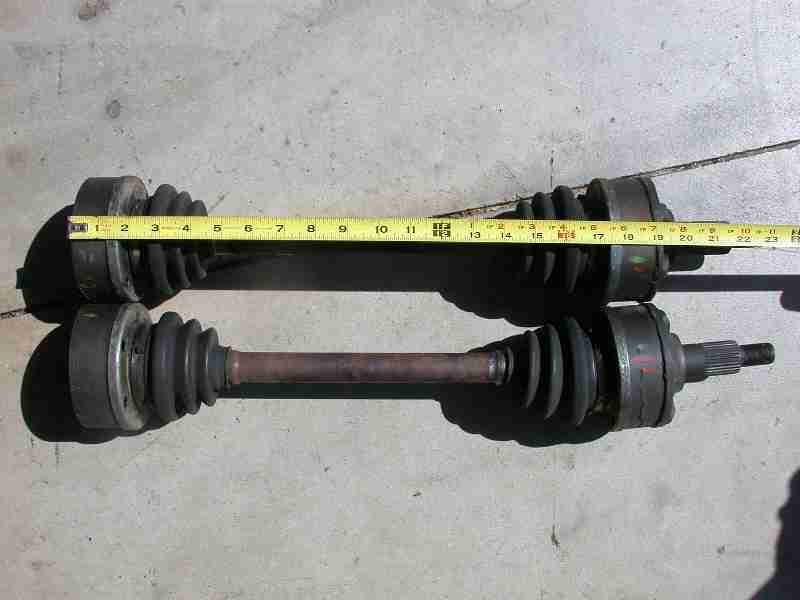

> Custom axles for my 1.8t 914, where can I have them made?
914_1.8t
post Jul 4 2004, 11:59 AM
Posts: 302
Joined: 3-June 04
From: East Bay
Member No.: 2,149
I'm doing a Audi 1.8t conversion into my 914. I'm using a complete engine/tranny out of a FWD a4.
I've got the engine/tranny into the 914 and the transmission lines up perfectly with the rear hubs.
Now I need to have a set of custome axles made.
Anyone know of a place (preferrably in the Bay Area, CA) that can make these for me.
I've found a place on the east coast but feel more confortable being able to take my car to the place and letting them do the measurements. Also, I only know of the one place right now. I'd like to know of other places (even east coast) that may do it so that I can compare/shop for the price.
Thanks in advance.

Wouldn't it be cheaper and easier to make up an intermediate plate between the output flanges of the trans and the CV joint?

Are you going to weld each axle half together to make the custom? Sleeving it for strength of course. (IMG:style_emoticons/default/wink.gif)
The problem is, the axles need to be a little shorter than the stock ones since the the a4 tranny is wider.
At first I considered doing this...but don't know if it will work out.
Firstly, I've got a 5 bolt rear conversion with either a /6 hub or 911 hub (i guess that would make it an early 911 hub). So, the stock axles/stub axles don't fit. With this approach i'd have to go out and get 911/914-6 axles and a4 axles. Plus I don't know if welding them together will how the 350whp i'm expecting to make.
For that reason I was looking for custom made axles that can hold the power.
I've spoken to the the Driveshatshop about getting some cutoms made.
So, i'm looking for other places (local hopefully) that can do this for me.

If you have the 911 hubs that you can use the shorter 911 axles, IIRC. If you have the original hubs then you can use stronger, shorter bus type axles.
For idas check out this link to an axle upgrade:
http://www.pelicanparts.com/catalog/shopca..._pg4.htm#item22
You could likely have these adaptors made thinner as these were made to take up the length difference as well.

Here you go:
SmartRacing Products, custom axles
also try;
Mark Williams Enterprises and sway-a-way(??)....i might have a few more bookmarked at work
welding is a bad idea with a part such as this, you want one piece axles.

Count the splines and measure the diameter on the axles and CVs. There is a good chance Lobro makes something that would just happen to work. Like the VW bus axles above using the same 930 CV...
Sway-a-way probably has all the measurements of everything and could be a good resource.

Welding Axels, bad idea. BTDT got the pile of broken parts to prove it. How much shorter are you talking. The stock axles have a pretty decent amount of plunge.

What year A4 are you swapping? AFAIK, there are two styles of flange on the trans. One with external ears for the bolts, and the other style has the bolts contained within the circular ring. The one's contained within the circular ring may fit the 108mm Porsche CV, but you'd have to check. Do a search for Raxles. They are very knowlegeable, and may be able to put together a mix of parts to fit your particular application.
Please keep us posted on your progress, as I am adapting an Audi/Getrag 6 speed to my V8 conversion and would be interested in youroutcome. Do you have any pic's of your conversion?

What Doctor Evil said
The 911 axles are already shorter and use adapters.

I'll conunt the splines and take some measurements (length...ect...). The two axles will be slightly different lengths because of hte way the engine fit/centered. Hopefully, like you guys mentioned, I can use the 911 axles with adapters (I can probobly have these made). How much can I get a set of 911 axles from a salvage/junkyard?
The engine is out of a nDBW 98 A4 w/ 5spd Tranny. The bolts are contained inside the ring on this tranny.
