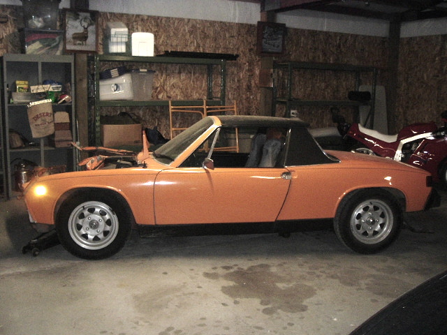

It's leaning on the right side...both front and rear....at first it was only the front until I started pulling on the car to straighten the windshield. Then the rear (same side) also just kind of went flat.
I am going to work right now...I will get some pics up. I pulled the wheel off and took a look and nothing jumped out as odd at all.
i.e. The wreck was on the front right...It did push the front suspension around.

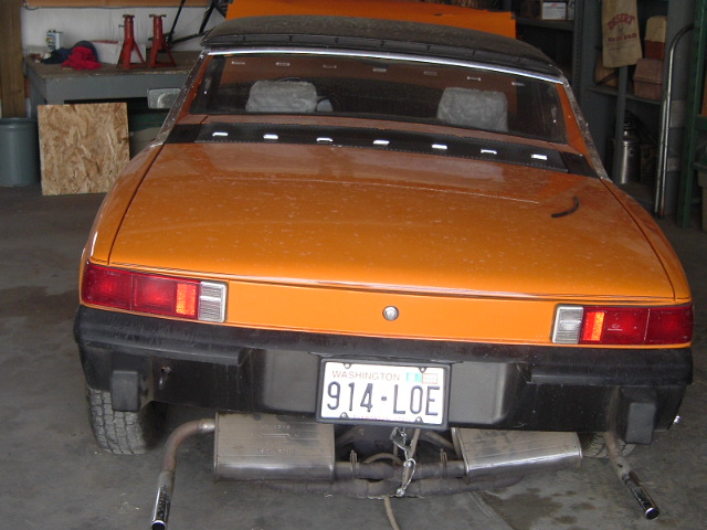

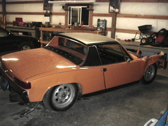

86motoman
post Jul 9 2004, 11:13 AM
Posts: 200
Joined: 13-May 04
From: Walla Walla, WA
Member No.: 2,064
drivers side
86motoman
post Jul 9 2004, 11:15 AM
Posts: 200
Joined: 13-May 04
Member No.: 2,064
pass. side
86motoman
post Jul 9 2004, 11:17 AM
Posts: 200
Joined: 13-May 04
Member No.: 2,064
rear

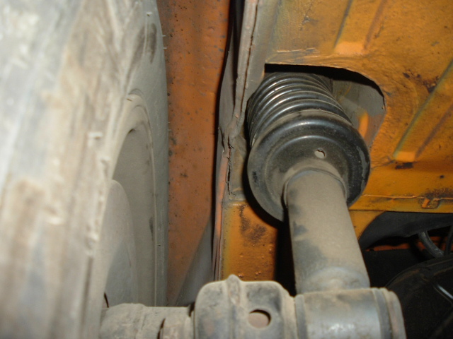

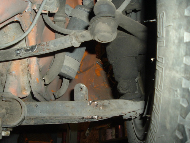

86motoman
post Jul 9 2004, 11:20 AM
Posts: 200
Joined: 13-May 04
Member No.: 2,064

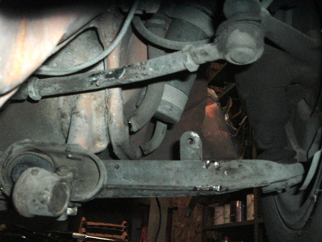

front suspension
86motoman
post Jul 9 2004, 11:23 AM
Posts: 200
Joined: 13-May 04
Member No.: 2,064
Front right suspension
bondo
post Jul 9 2004, 11:26 AM
Posts: 4,277
Joined: 19-April 03
From: Los Osos, CA
Member No.: 587
Ouch. It could just be from the front suspension damage. I have tried to jack up just the front of my 914 to work on the brakes. I put the jack right behind the left front tire hoping I could lift both front wheels.. I ended up lifting both left wheels. It seems these cars like to lean more side to side than front to back. Try jacking up the front until it's level and see what the back looks like.
Are you really going to try and fix that? it doesn't look easy!

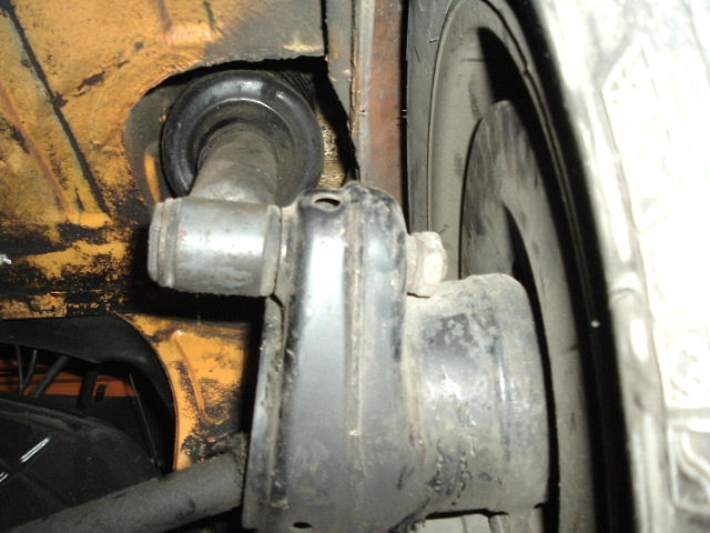

86motoman
post Jul 9 2004, 11:28 AM
Posts: 200
Joined: 13-May 04
Member No.: 2,064
another front right suspension
86motoman
post Jul 9 2004, 11:31 AM
Posts: 200
Joined: 13-May 04
Member No.: 2,064
right rear suspension
I see nothing out of the ordinary here except the strut is compressed

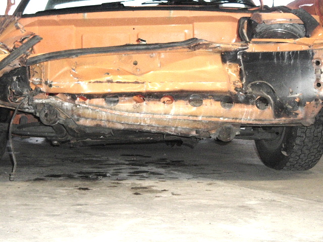

86motoman
post Jul 9 2004, 11:33 AM
Posts: 200
Joined: 13-May 04
Member No.: 2,064
Left rear suspension. This strut is not compressed..if anything to high??

QUOTE(bondo @ Jul 9 2004, 09:26 AM)
That would be great if it is only the front suspension damage tweaking on the car. I will try jacking the car up in different locations and see what happens...that is a good idea.
I don't know if I am going to get it going or not. One thing is for sure, it will never be a "914" again. (IMG:style_emoticons/default/sad.gif) I miss my little car. I love the configuration on this car, midengine, light, targa top. Depending on how difficult the damage is to fix, I will either:
1.) Get it to sit level and not wear out tires driving down the road and give it a playful custom bug eyed fiberglass front end. And hope it lasts until college is over.
2.) hack it up...eventually putting it back together on a tube frame with no body and ad a 915 transaxle (maybe zf) and a Big Block Chevy and have one hell of a go cart. hehe (This is one of my dreams I will accomplish someday)
3.) Part it out and find a different 914 or possibly a 914 tub.
But for now....let's see if we can get it level. (IMG:style_emoticons/default/boldblue.gif)
nebreitling
post Jul 9 2004, 04:20 PM
Member Emeritus
Posts: 3,314
Joined: 26-March 03
From: San Francisco
Member No.: 478
IMHO, there's no way you're going to get that level (at least correctly) without fixing the front end. looks bad -- what happened?
I believe you called it my man! (IMG:style_emoticons/default/clap56.gif)
I put the jack on the right front and it leveled out the rear. Unfortunately the front had to be jacked way up there...But the issue is in the front suspension!
Next step will be to cut off the crap and see what I can do up there to get it back close to where it was.
Anybody have any suggestions on how to approach this?
bondo
post Jul 9 2004, 04:33 PM
Posts: 4,277
Joined: 19-April 03
From: Los Osos, CA
Member No.: 587
Hold on, that may not be the case. Of course if you level the front (by wahtever means) you will either twist the car, or level the rear. If you had to jack the front way in the air, and the rear is way down, it could still be something in the rear, but now the left side is holding the whole rear off the ground. In theory if it's just the front you should be able to level it out by jacking the front back up to normal ride height, but you will have to do it as close to the tire as you can. (obviously if you jacked it up closer to the middle, you would have to go way up to add enough twist to get it level) Ideally you would want to lift the right front tire, but that may be hard.. maybe jack it up and set the tire down on some blocks?
