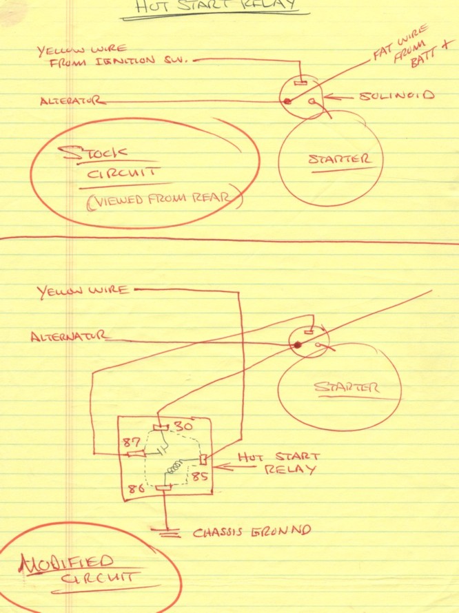

Define "new starter". They're all Bosch, but you're apt to have trouble from the get-go with starters rebuilt by anyone other than Bosch itself. Have you checked the wiring between the ignition switch and the relay board, the board itself, and from the board to the starter? Over the last 31 years of working on 914s, I have found that the wiring is most often the cause of such problems ("most often", following autoparts store rebuilt starters, that is!). In that case, I use a 6 volt Ford starter relay ("Standard" brand SS-571), mounting it on the end of the starter, and using heavy gauge wires to ensure the good flow of current. BTW, some real late '73s may have the seatbelt interlock logic relay under the right seat. Known problem spot. You might want to look into that. HTH, The Cap'n

I always thought the root cause was lack of voltage to the solenoid due to decay of the 30 year old wires from the iggy switch.
Esp. when hot, because the starter expands internally and requires even more juice to go.
What is the proper voltage at the solenoid for reliable starting?
The relay-add trick gives it full 12v plus, so that works. (IMG:style_emoticons/default/idea.gif)
I have the kit in my car and it ALWAYS turns over. (IMG:style_emoticons/default/clap56.gif)

Check the fat yellow wire connection under the passenger seat to insure that it is solidly connected. Add a hot start relay, it's cheap, it works, I put one on all my 914 cars.
