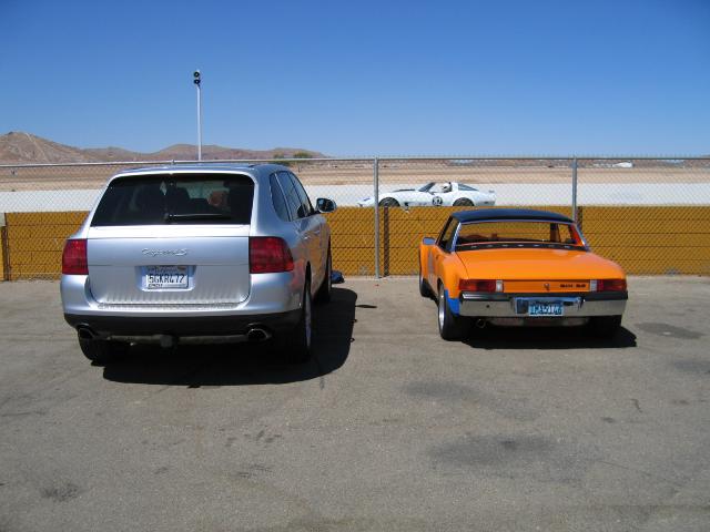

I was there spectating on Sunday. A friend didn't show at The Streets, so I went over to the big track. Looked over the teeners (in the pic's), but no owners/drivers in sight. Just as well I suppose, as it was too hot to work on anything anyway. Amongst the exotics (ok, roadrace oriented types) were the stockcars which brought back fond memories from a past series I was involved in, in the late '80's/early '90's (The Toyota Sportman Stockcar Series). Anyway, these guys were running 1:25's/1:26's with stock (spec motor) ZZ4 crate 350's with 390 four barrels. Pretty inexpensive way to go fast, and they are fun to drive! BTDT.

Looks like a Damn Bus sitting next to that SWEET GT Look Car.

> re: Looks like a Damn Bus sitting next to that SWEET GT Look Car.
Ha! I know. I didn't really notice it at the time but that picture really emphasizes things, huh?
