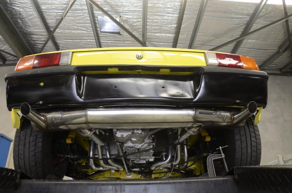

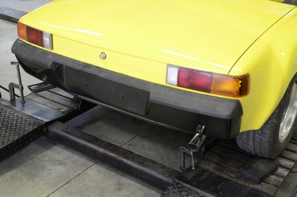

New Wevo'd 915 from the boys in Phoenix and Tangerine Racing Evo 6 exhaust system all bolted up.
Fired up the engine today after not being run for 12 years! Got oil pressure after a couple of cranks and then she sputtered into life. Webers were dismantled, cleaned and new gasket set fitted beforehand they still need tuning though.
Couple of questions re: transmission. What is the recommended oil to use with the 915? Diff is a Wave Trac torque biasing unit.

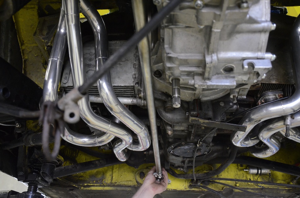

The clearance between the rear shift linkage rod and the headers appears to be very close. Although I haven't bolted it in yet, I fear the rod may contact the exhaust when attempting to shift.
Anyone else running this set-up?
Thanks again and all comments welcome.
Phil

Interesting header pipe guide/direction
What are the reasons for this?

QUOTE(DEC @ Sep 12 2011, 06:10 PM) *
I'm not really sure but I think this design gives a longer primary pipe by comparison to the type that go out to the side.
Definitely improves the ground clearance and allows for easier removal of the driveshafts. It looks pretty cool too.
Phil

QUOTE(phillstek @ Sep 12 2011, 04:18 AM) *
Phil
Both the primaries and secondaries have a tuned length, as opposed to most -6 headers which are designed for convenience and don't have optimized secondaries.

Headers are Tangerine Racing Evo 6. I'm using their dual outlet muffler also.

Here is a picture of the linkage clearance issue I refer to. Thoughts and comments welcome as usual
Phil

I put the 4cyl car with a WEVO (that I mentioned in an email) up on the lift this afternoon.
As far as I can tell, at the tranny connection, the WEVO shift rod is a couple inches higher than the stock sideshift.
It isn't any farther to the left though, so there really should be no interference when both ends are connected.
The linkage ended fitting really nicely without any modification. No issues with fouling the exhaust and I can actually shift through a tight 'H' pattern now rather than the giant, vague 'O' pattern of the old 901.
If anyone is requiring an exhaust system for their /6 they would be hard pressed to find anything that comes close to the TR Evo 6 in terms of value, quality, appearance and design.
