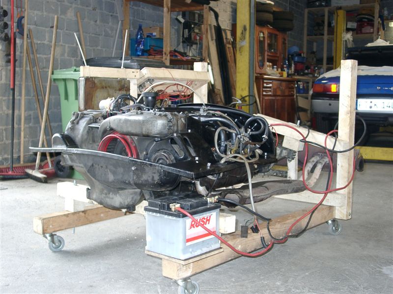

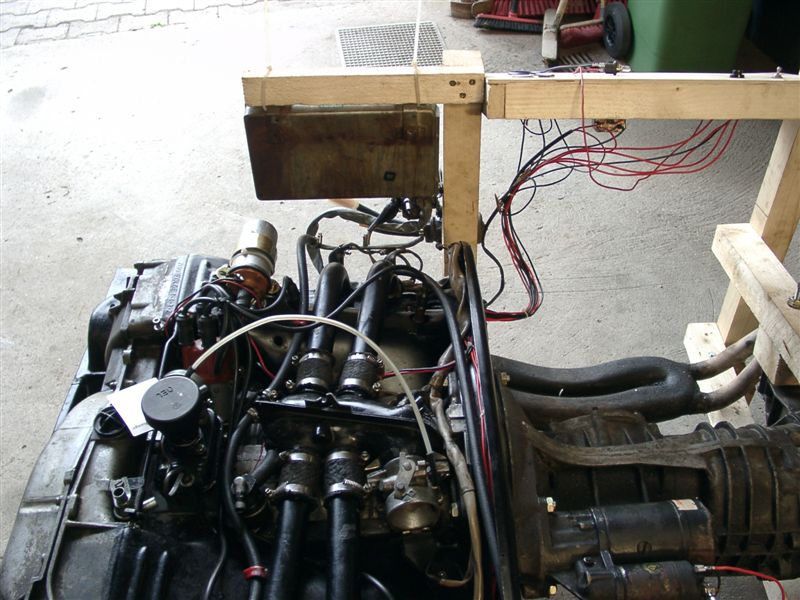

Hi everybody,
this is my high quality (IMG:style_emoticons/default/biggrin.gif) self made engine stand. Not ready yet, but i hope the engine runs the next two or three weeks.
:gerflag
michelko

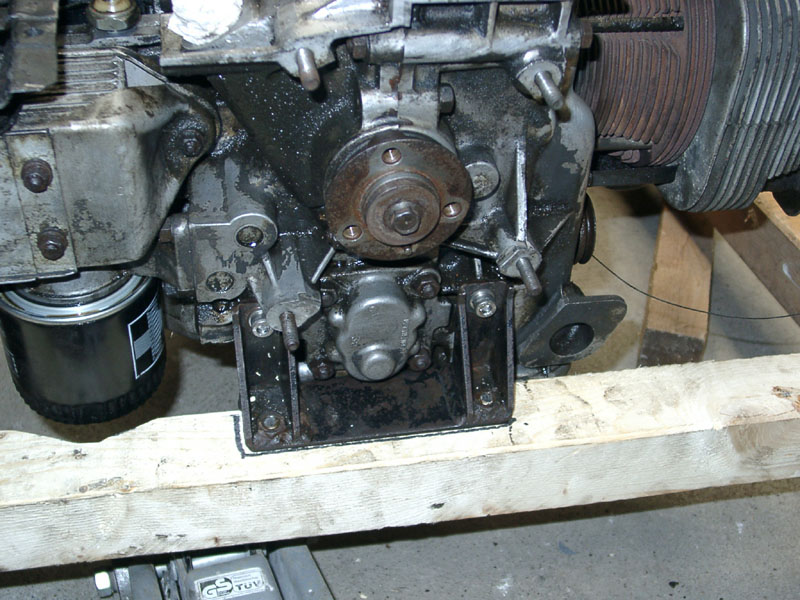

nother one

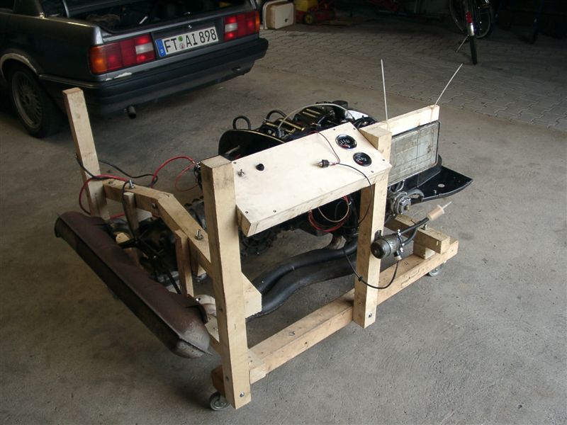

#3

This looks great, but what about hook-ups. Battery + to starter, Trans ground to ground, what else

Michelco, your stand looks good, but I would just use the stock front mount bar. You will have to remove your fan housing, etc. to get that mount back off.
Yep, you will need to connect a battery, fuel pump, tach, oil pressure warn light, power to the coil and FI, etc...Just like it was in the car.

Hello,
unfortunately i don´t own a secon engine bar. The wooden bar in the picture has to be cut out to mount the blowerhousing. I fixed that last weekend.
Removing the bar is no problem, you can unlock the screw from the underside witout removing the blower.
The electric is ready (in my brain) (IMG:style_emoticons/default/biggrin.gif) this should be no problem. Will post pics of it whenn ready in the real world.

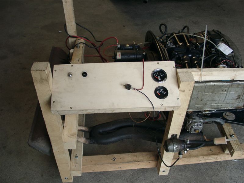

Hi Guys,
worked a little on the engine stand yesterday. Did the whole wiring for ignition, oil pressure switch, connection for the brain, etc. Took me 4 hours to do it.
Works fine, no problems. Engine cranked at first try. Have to buy more fuelline (IMG:style_emoticons/default/smilie_flagge6.gif)

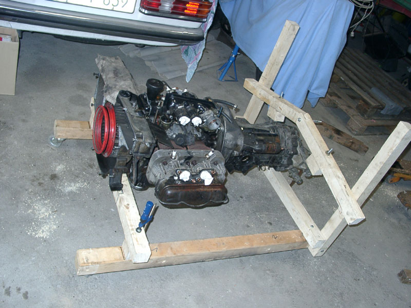

Member No.: 1,404
#2

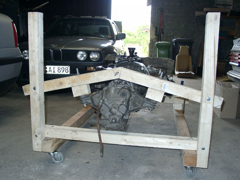

Member No.: 1,404
#3

(IMG:style_emoticons/default/wink.gif) #3 should ad a pic

#4

Did you use a relay board. If not, what is the best way to wire the motor to run. What are the necessary connections. Your framing looks nice and stable. I was thinking about building one out of metal, but I think I may have changed my mind.
