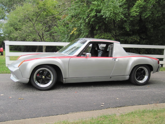

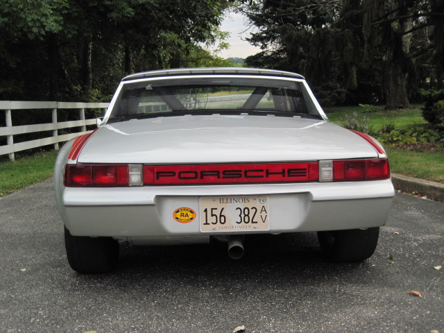

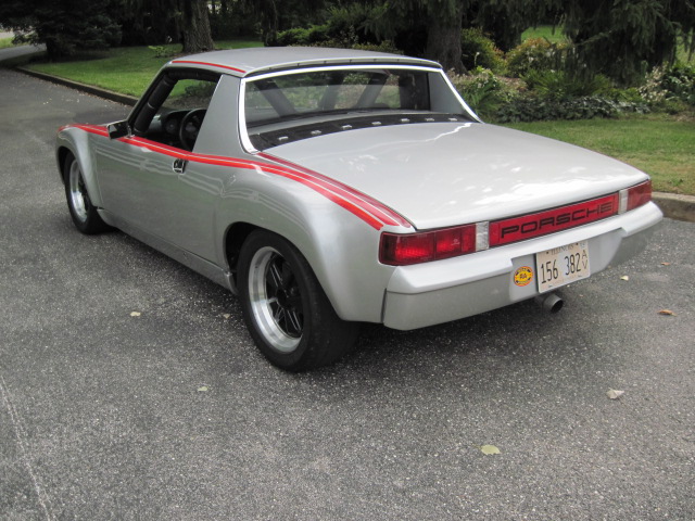

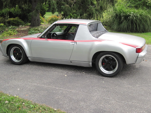

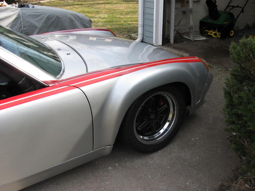

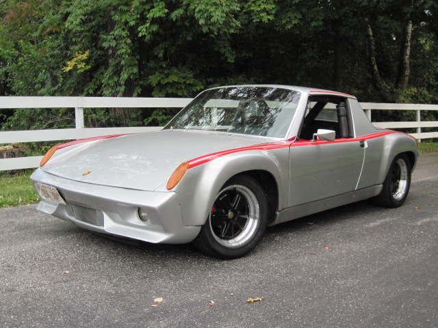

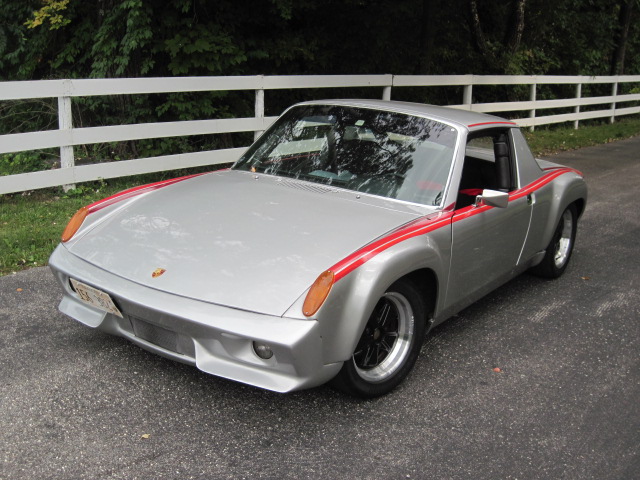

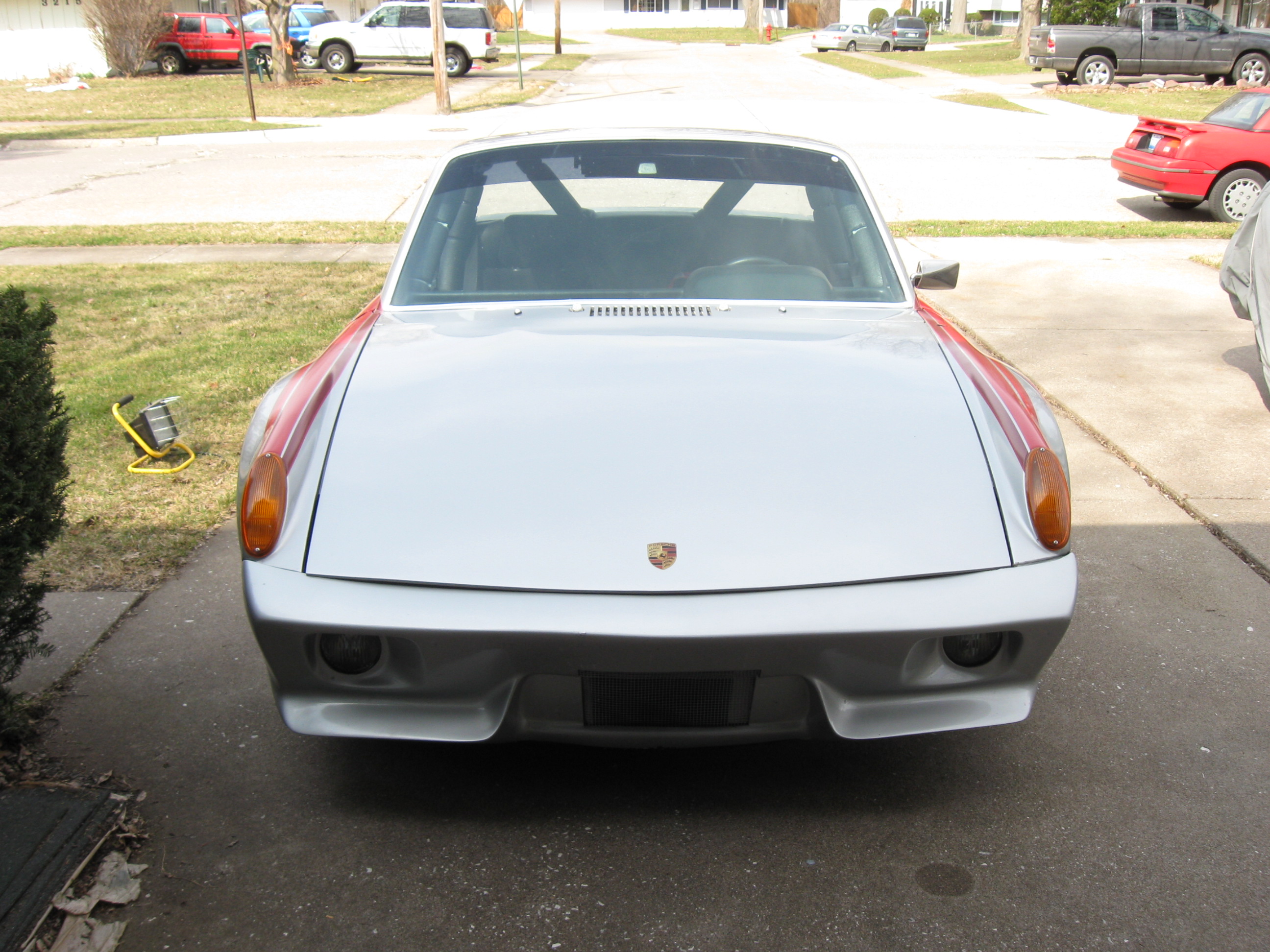

Exterior
Attached Image Attached Image Attached Image Attached Image Attached Image Attached Image

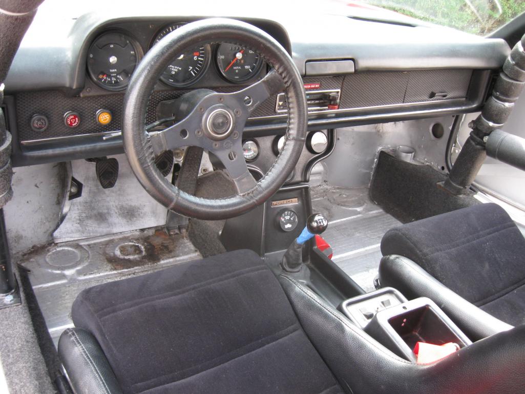

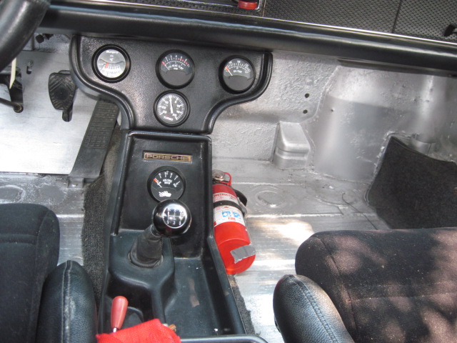

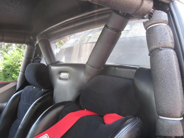

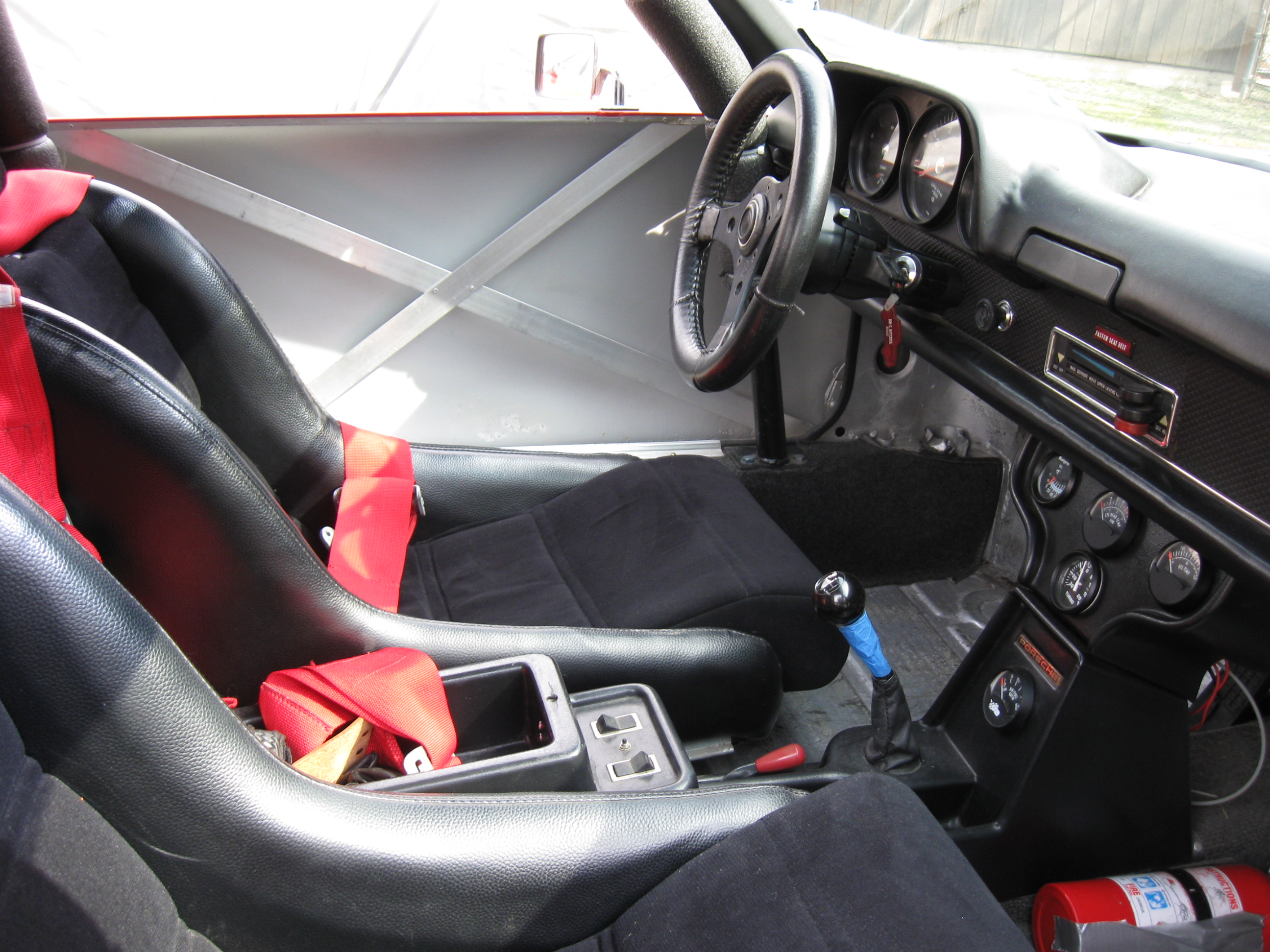

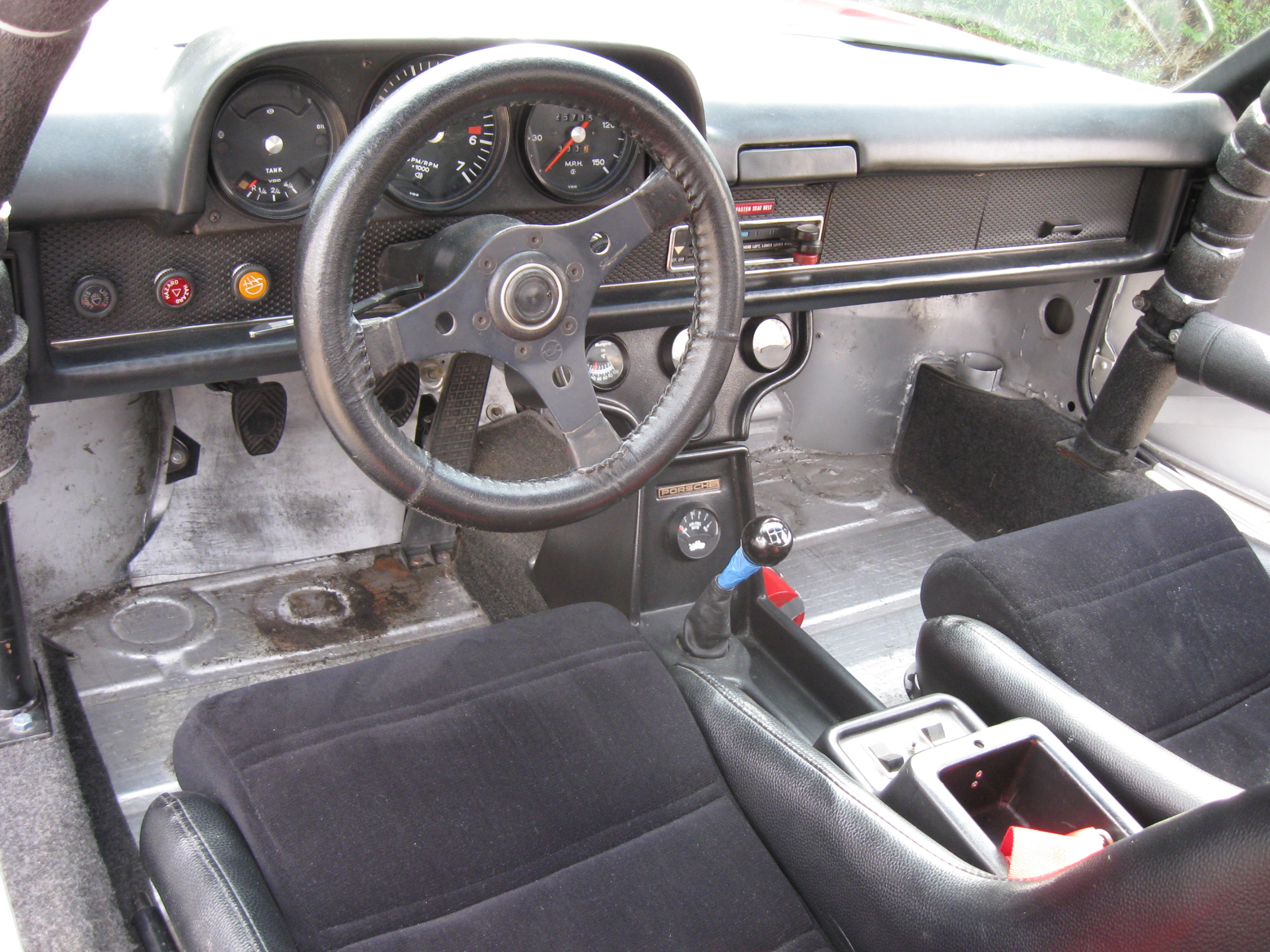

Interior:

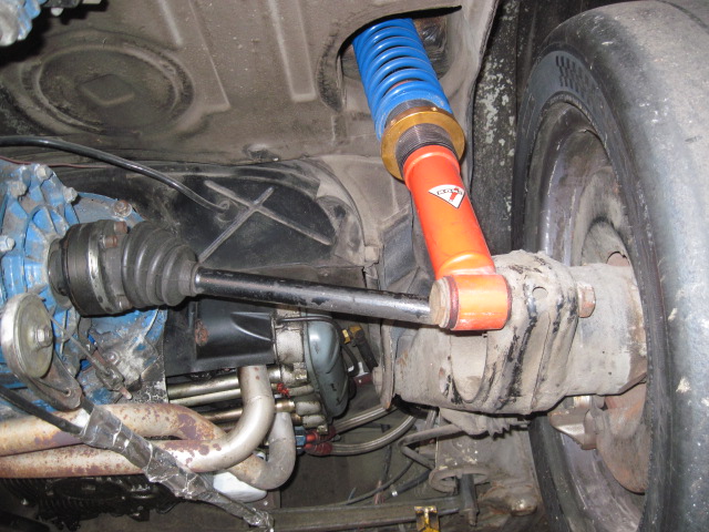

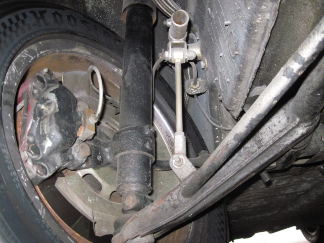

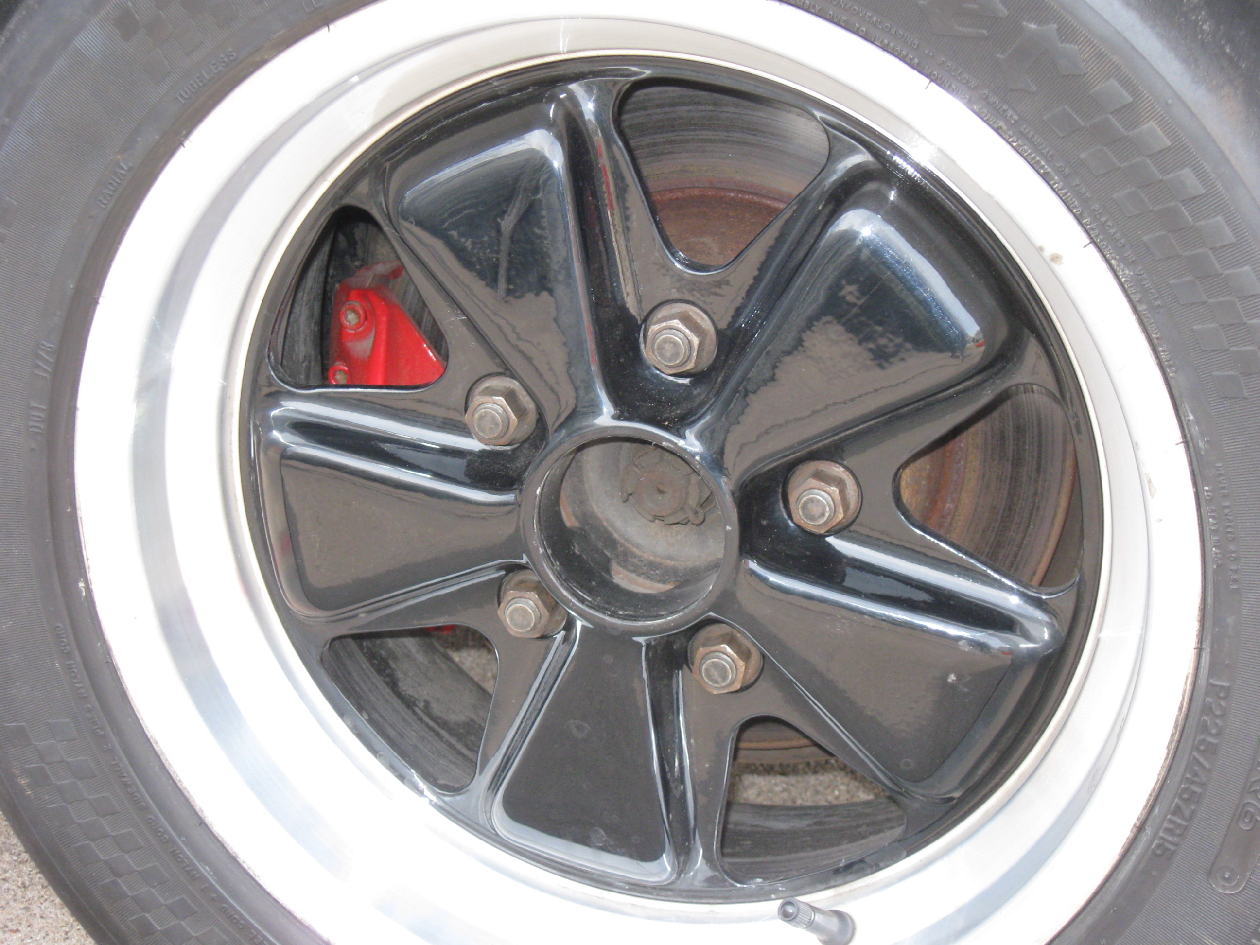

Suspension:

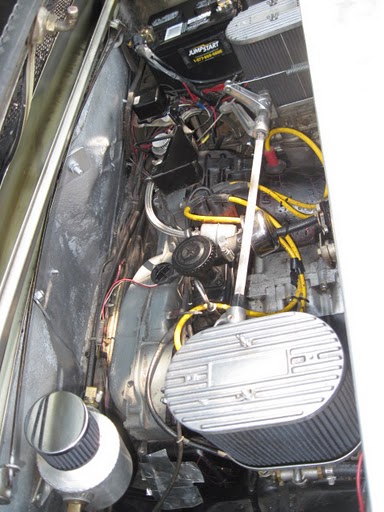

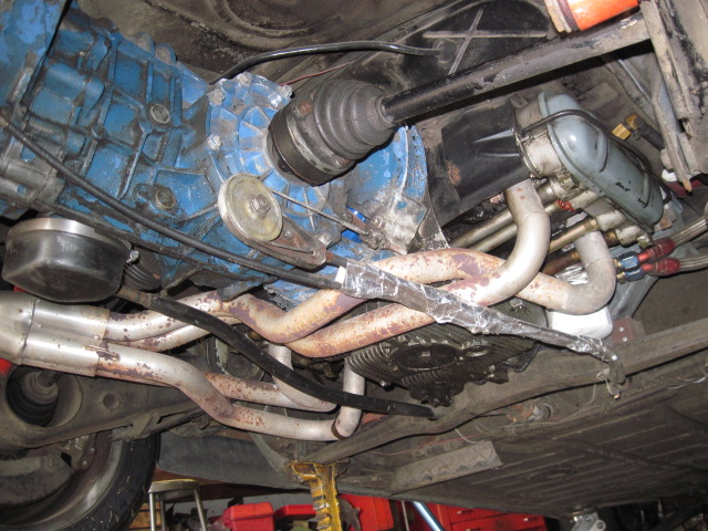

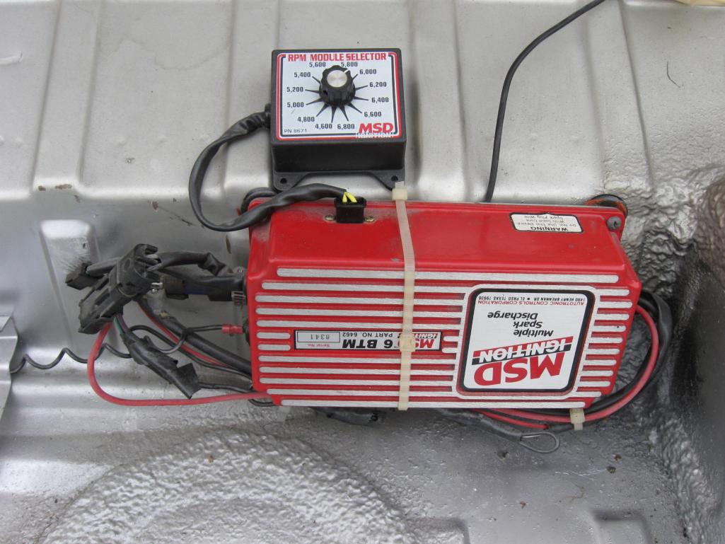

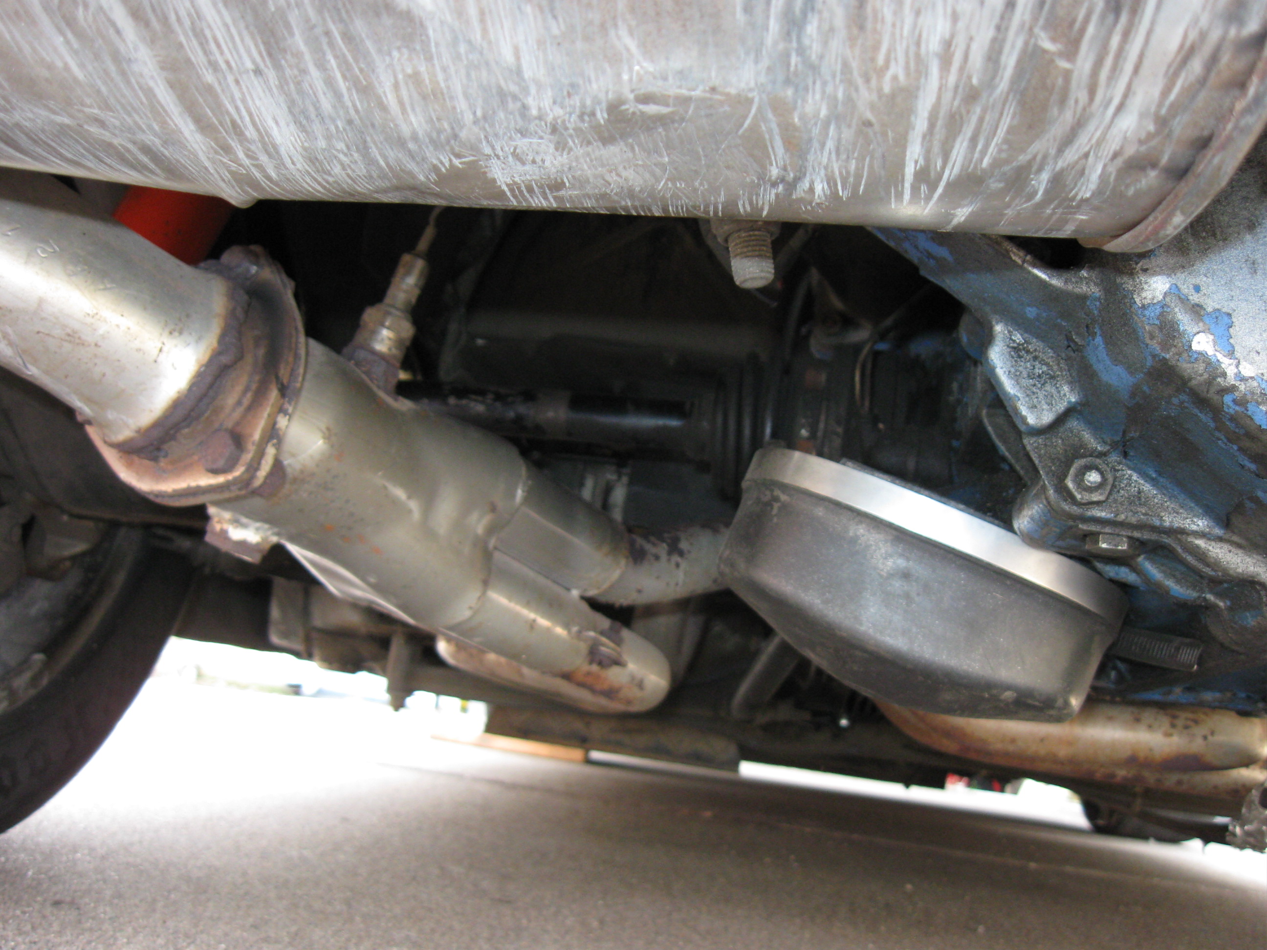

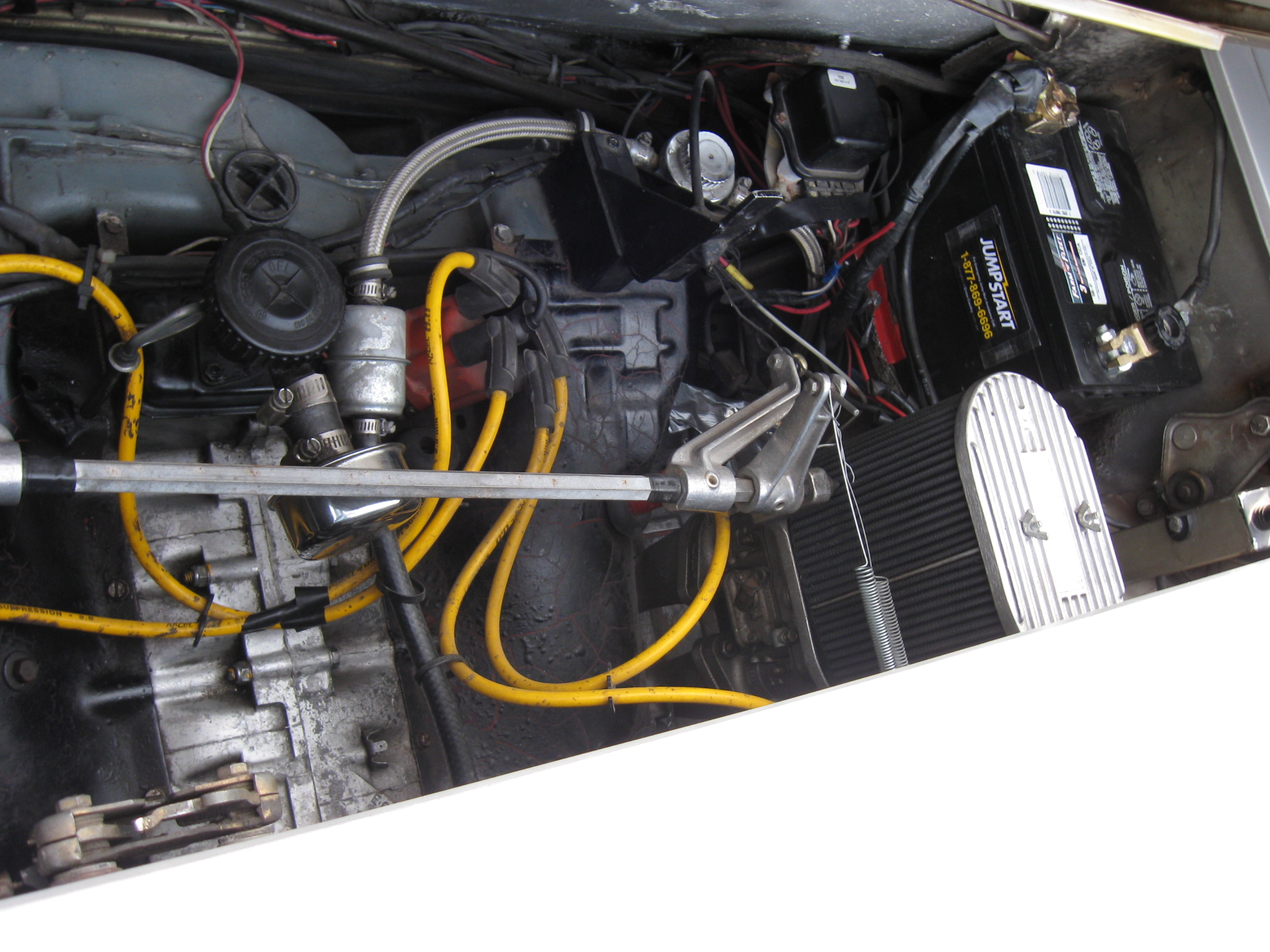

Engine:

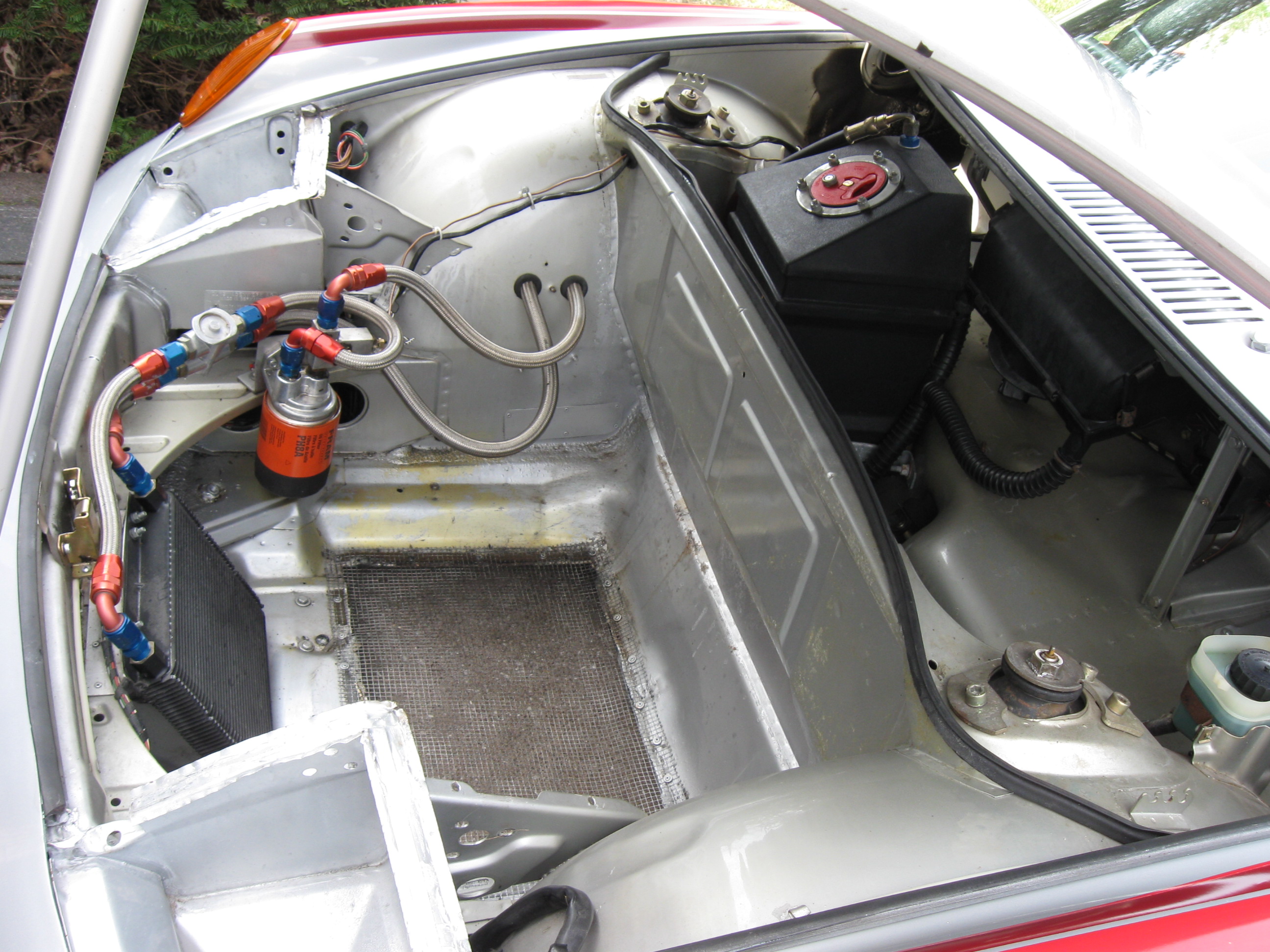

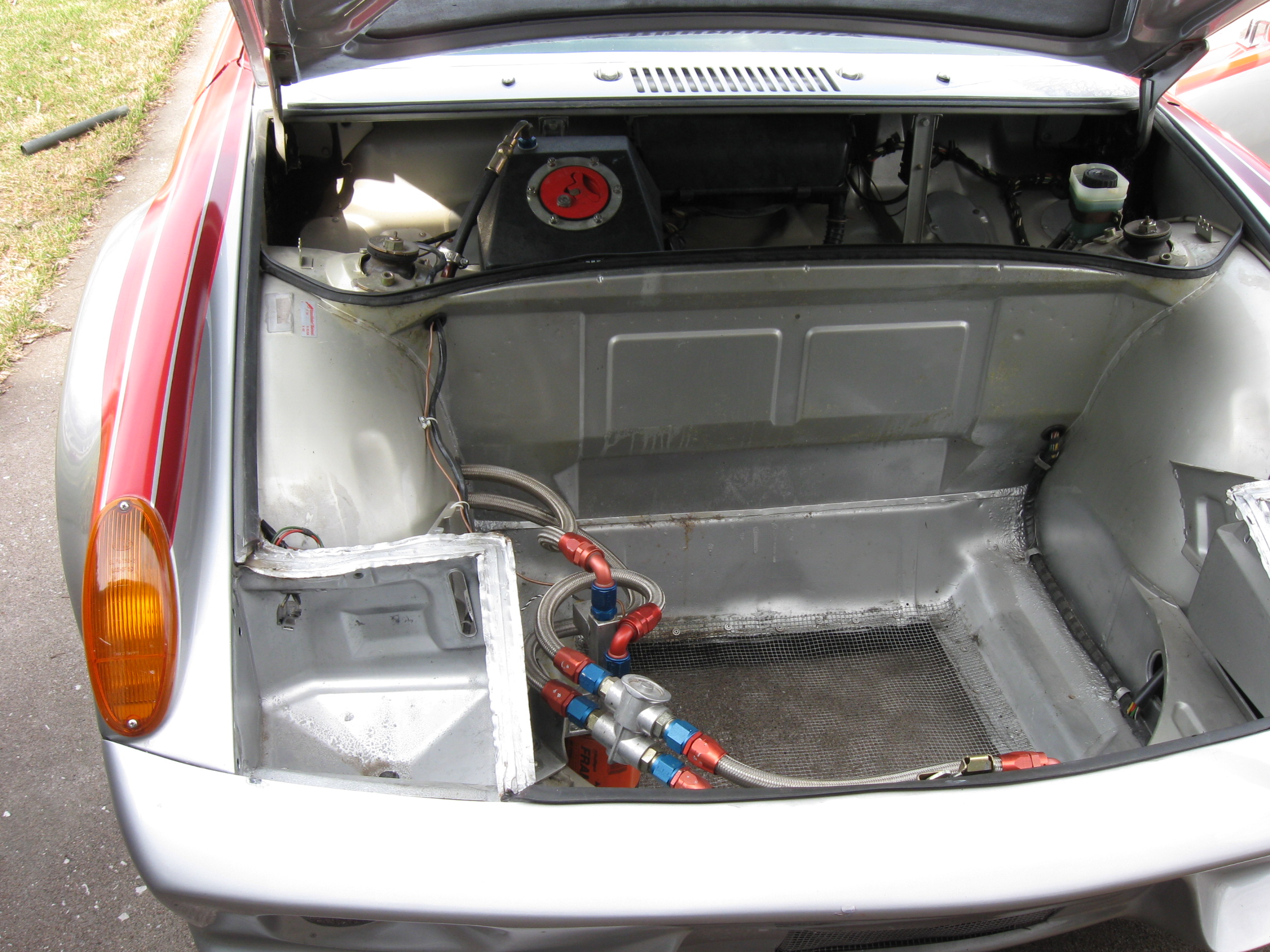

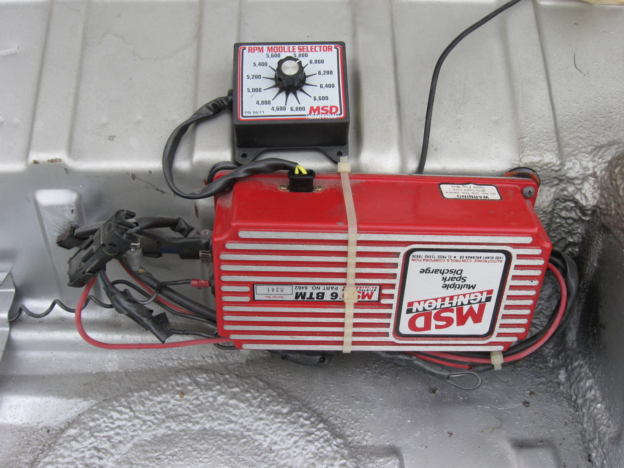

Trunks:

A few things I see:
Your header is way too small for a 2.4L.
I guarantee it's holding the engine back - a lot. There's at least 10 more hp & 10 lb-ft torque available just by replacing the exhaust.
You should have 4 EGTs to monitor the fuel mixture of each cylinder at WOT.
Single O2 sensing doesn't have much value on a race car.
I don't understand why the oil thermostat would be placed in the front trunk so close to the cooler.
It should be closer to the engine to shorten the route when the oil is cold.
Also, IMO hoses that long should be -12, not -10 (definitely not -8).
No tuna can, or accusump? The engine won't last long once you start pushing it around at a competitive event.
You should consider moving up to a dry sump oil system right away.
5 gal fuel cell isn't going to get you far. Fine for an AX toy but not big enough for even one on-track session.
I'd lower the rear another half inch.
Where's your adjustable brake bias control?
Front anti-sway bar is too small.
Stage 4 clutch is overkill. Your leg's gonna get a work out.

If you start doing much in the way of track events the cage will need to be updated. You need a modern main hoop with SCCA/NASA legal Diagonal and cross brace. You will also need legal door bars as well. Best bet is to have a custom cage built if you intend to seriously track the car. The four cylinder will put you in the virtually unlimited classes and you will really be running against some full out well sorted race cars. You can run the car in SCCA ITU/ITO/ITE. That is a catch all class that requires a DOT tire, but beyond that its mostly free.
You could build the car to run in HSR. Most of the mods you have minus the engine could allow you to run in the 2.0 Challenge class. You would have to swap in a 2.0 six, but you could at least show up and run for a while until the 2.4 gives it up. No one will complain because you will still be down about 50+hp. But you will have tons of people to race with in 914s and 911s. Plus they run a treaded vintage tire.
Looks like you could have a good trackday package to start out with. That would at least let you run some open track events to decide if that is what you really want to do. Chris makes good suggestions. I would add to that:
Get some ducting for that oil cooler.
You need to exhaust the air properly to ensure efficiency.
Also toss the clutch and get a decent clutch. No sense in destroying the thrust bearings on the engine with a massive clutch. Your not making enough torque to warrant anything more than a stock pressure plate, maybe an aluminum S pressure plate for racing. I would use a sprung hub clutch just to help keep the transmission alive.
Get a proper breather can on there and toss that crappy filter stuck on the side of the oil filler neck. It will keep the oil off the engine and engine bay.
Your fuel cell is not legal for anything beyond autox. You will need a road race legal fuel cell to run head to head and maybe even some time trials.

QUOTE(Racer Chris @ Sep 29 2011, 02:00 AM) *
I think I am at least going to keep the headers for now, but need to be thinking about upgrading to better flowing. I know you are biased, but are there any other high flowing header systems out there besides yours?
What would I use EGT data for? just determining which cylinders were lean under load?
I am planning on getting an Accusump system ASAP, what is the preferred size for this application? 3 qt? I had heard some talk about the front trunk being the best mounting location for an accusump for weight distribution, which would only work with a front mounted thermostat. but then you have some excessive pumping distance.
If i were to relocate the thermostat, where would the preferred location be?
I have switched the 5 gal race tank out with the stock tank since 5 gal on this engine isn't worth much anywhere but autoX.
I have not seen any adjustable brake bias control, so I am operating under the assumption that it has a stock proportioning valve.
I have cam specs somewhere and will post later. the heads have stiffer return springs so I place the true redline around 6500.
