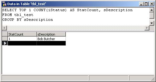

QUOTE(Cloudbuster @ Jul 22 2004, 12:18 PM) select top 1 count(iStatus) as StatCount, sDescription from {tablename} group by sDescription order by StatCount nope, that just returns the first row in the table ... Attached image(s)

SELECT TOP 1 COUNT(*) AS 'Number of repeats', rowName AS Number FROM dbo.tblName GROUP BY rowName ORDER BY COUNT(*) DESC It will return how many times the number occured and which number. You can then pull whatever you want from the result; the actual number. |
| SirAndy |
Jul 22 2004, 01:38 PM
#7
Resident German ![]() ![]() ![]() ![]() ![]() ![]() ![]() ![]() ![]() ![]() ![]() ![]() ![]() ![]() ![]() ![]() ![]() ![]() ![]() ![]() ![]() ![]() ![]() ![]() ![]() Group: Admin Posts: 42,533 Joined: 21-January 03 From: Oakland, Kalifornia Member No.: 179 Region Association: Northern California |
QUOTE(Deluxe247 @ Jul 22 2004, 12:28 PM) To get the mode do this: SELECT TOP 1 COUNT(*) AS 'Number of repeats', rowName AS Number FROM dbo.tblName GROUP BY rowName ORDER BY COUNT(*) DESC It will return how many times the number occured and which number. You can then pull whatever you want from the result; the actual number. perfect! that worked ... (IMG:style_emoticons/default/pray.gif) thank you very much, you just saved me a ton of work! next (IMG:style_emoticons/default/beer3.gif) will be on me, Andy |
