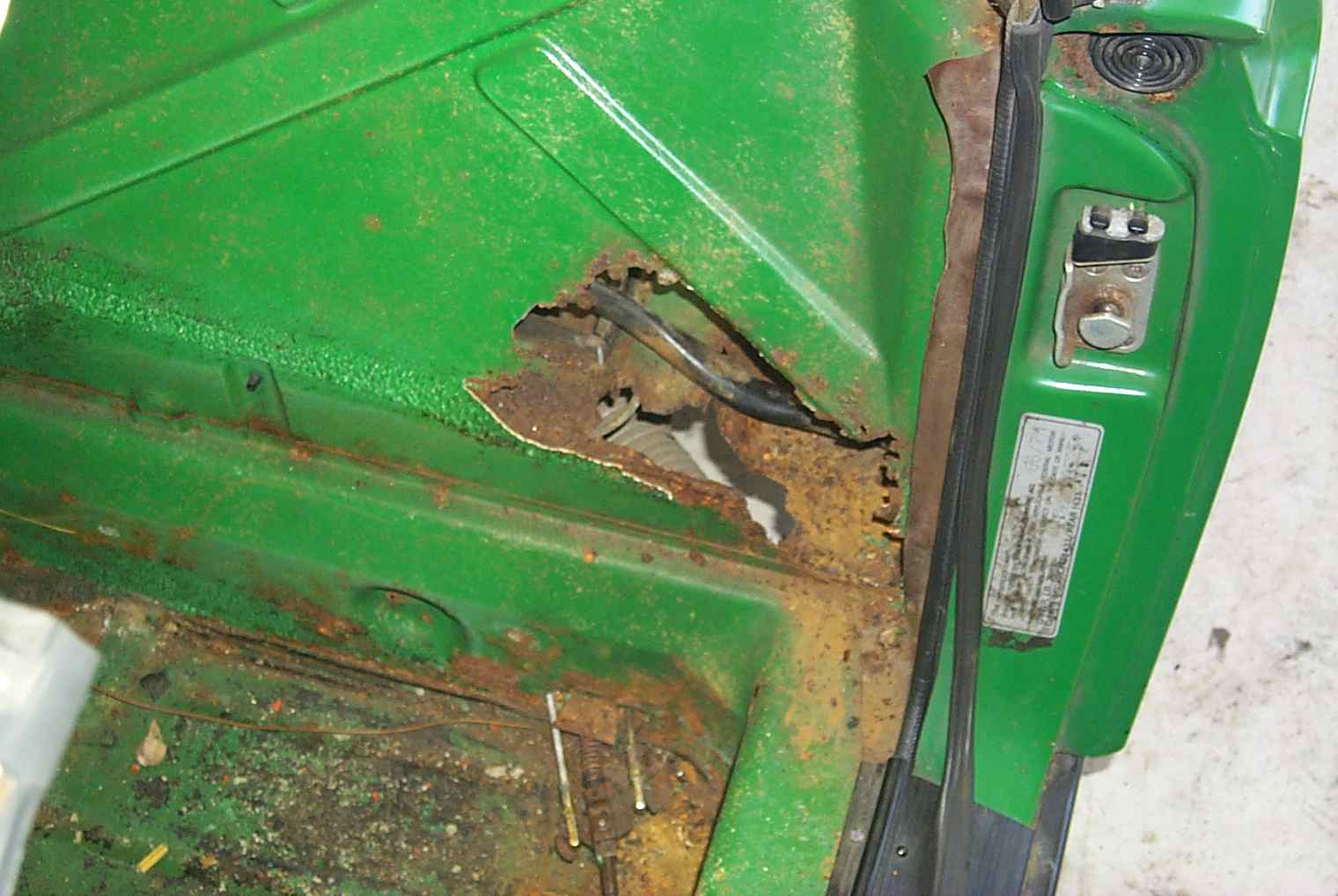

Joe.D
post Jul 23 2004, 04:46 PM
MCMLXXIII MCCM
Posts: 132
Joined: 16-June 03
From: Southern Maine
Member No.: 830
"not bad" could turn out like this. (IMG:style_emoticons/default/sad.gif)
