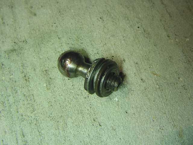

In addition to this there were 2 thin washers under the pivot ball on the transmission. I guess the flywheel has been resurfaced enough times that the DAPO decided to raise the cup height on the fork to take up the slack. The new clutch fork doesn't have the raised cup so now I have to add more washers under the pivot.
The problem is, I added a bunch of washers, and I am running out of thread. There still isn't the suggested 20mm of clearance between the fork and the transmission housing when I install the transmission!

I need to add MORE washers to get the 20mm (0.78in) of clearance on the fork with the tranny installed.

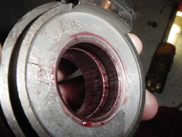

Another issue is that now the TO bearing is getting pretty close to the edge of the sleeve it rides on when I pull the fork all the way to the back of the transmission. With the transmission off the car, it even gets a little bit "stuck" on the lip inside of the TO bearing, and I have to jiggle it to get it to retract again! This can't be good but it must have been like this before also.
This pic shows the lip inside the TO bearing that is catching on the edge of the retainer sleeve on the transmission.

Ok. So that solves the problem of the fork hitting the housing. What about the TO bearing running off the edge of the sleeve it rides on? When I fully extend the TO bearing it gets caught by the edge of the sleeve and does not want to retract without a little nudge. Ever seen that problem before? Maybe it is a non issue if the clutch disc holds it in place during normal operation, but if it goes crooked it may not slide back to the retracted position again.
