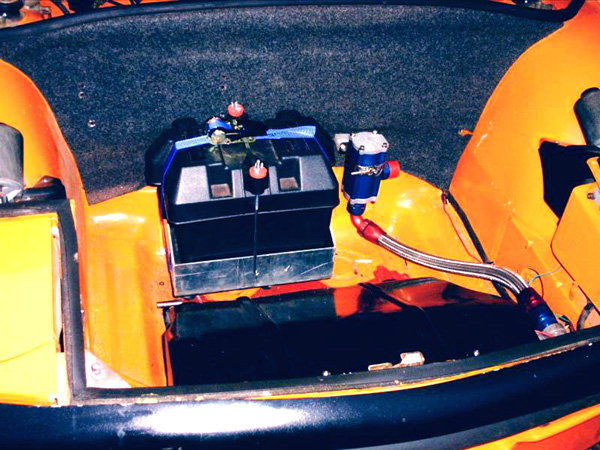

Here is an older pic of my setup.
Mounted up front,down low.
A couple weeks for of frigging around to get it all to my own satisfaction.
Ron

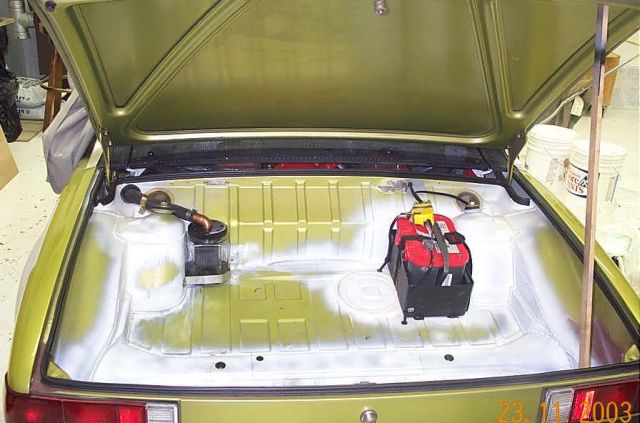

This came with my car and It's great, I don't carry too much stuff so storage space isn't a problem.

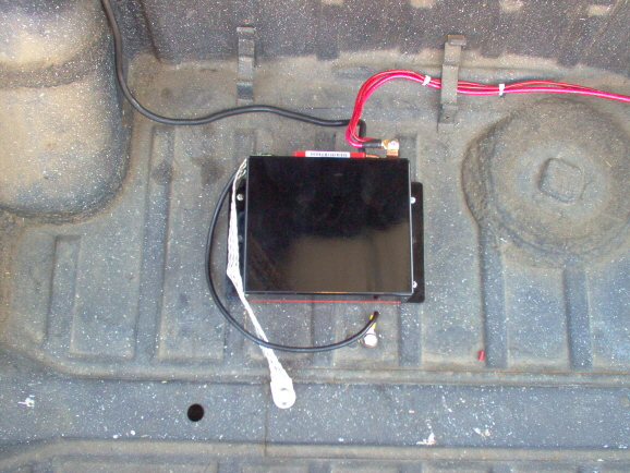

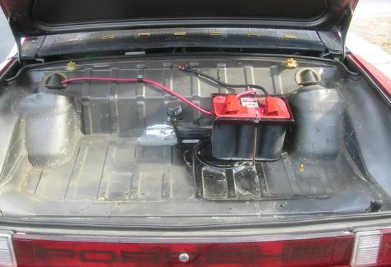

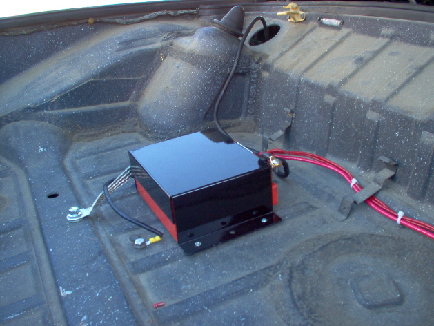

I put this in mine. Odysee 680, 680ca 270 cca 370 hca works good for me. As soon as I take out the tray then I will mount it back in the engine compartmenrt down low. Thanks Mark
MXMARK
post Jul 30 2004, 01:43 PM
Posts: 205
Joined: 15-February 04
From: Riverside, Ca. the new (951)
Member No.: 1,656
Another picture. No header or heat exchanger on that side.

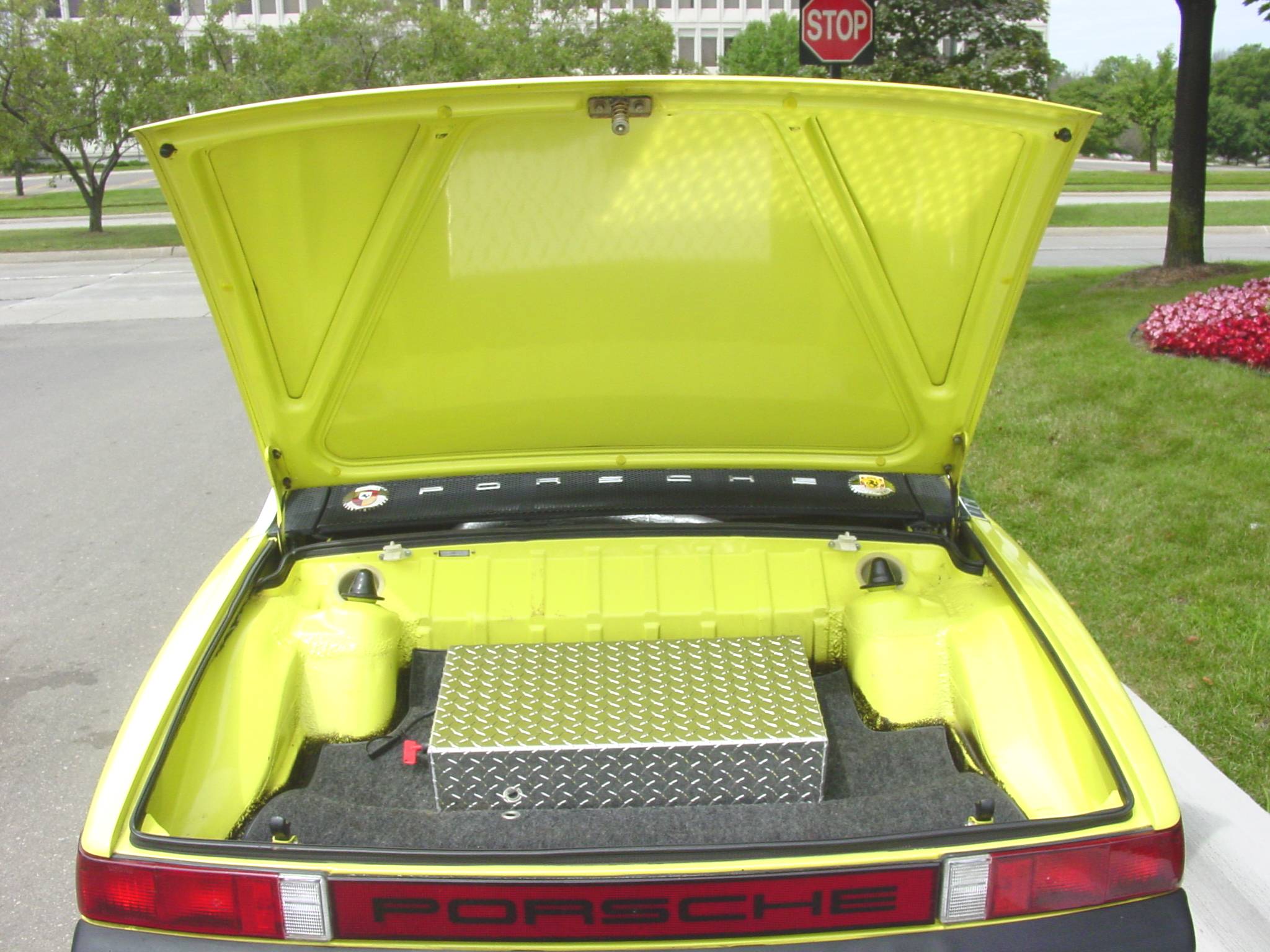

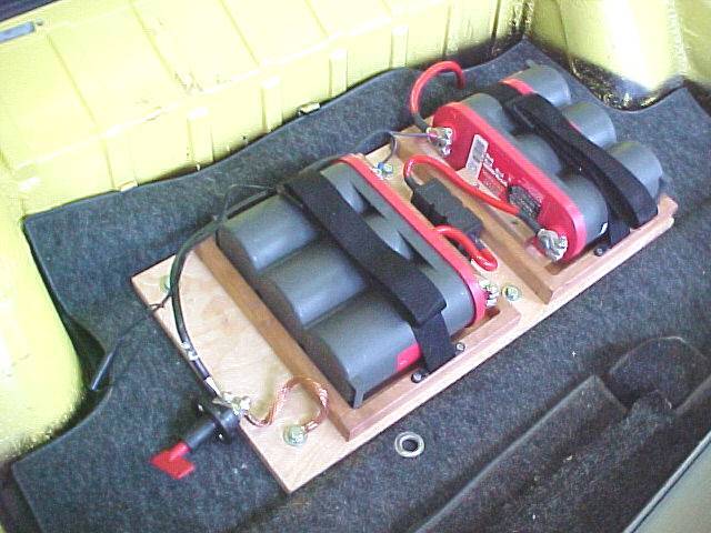

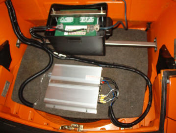

Here is a pic of my rear trunk set-up. Two 6v Optimas on thier side. No problem with top storage.
914rick
post Jul 30 2004, 09:24 PM
Posts: 102
Joined: 4-July 03
From: Detroit, MI
Member No.: 882
Finished product.
