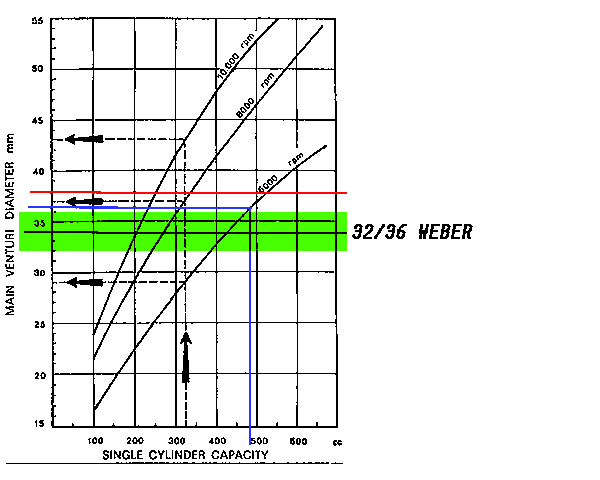

DCOE's are side drafts. They work great for watercooled cars because the intake port is on the side of the head. IDA's and IDF's are down drafts. The aircooled heads have the ports pointed up perfect for a down draft application. Unless your going to turbo it why would you increase manifold length or add a 90 degree angle in the mix to screw up flow?
Here's the venturi chart I reference. It's only a guide. I'd go with Jakes real world experience.
