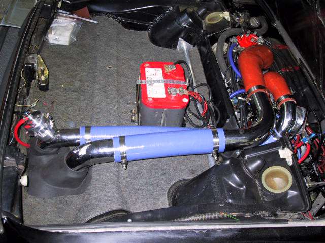

I have a brace between the shock towers in the back as you can see and a camber truss in the front, they came with the car when I bought it, along with a lot of other reinforcing.(The car was set up for Willow Springs)
I am using a 901 with Quaife lsd and short gears (M,S,Z) a Kennedy stage 2 clutch and pressure plate which will slip a little when I am running through the gears WOT. I plan on upgrading to a stage 3 like the v8 guys use.
I am still wrestling with a turbo oil scavenge problem using a Tilton oil pump that is unable to keep up with the flow from the turbo but have sourced out a 930 cam driven scavenge pump that should, if I am unable to restrict the flow enough
for the Tilton to scavenge properly.
The 959 paintings were a few I did as samples while doing commercial artwork for National car rental. Prints are available.

pictures of the front truss and hood fuel door
