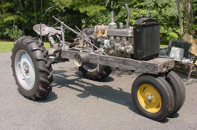

Yes. I have seen pictures of an Allis Chalmers Farm tractor done that way.
You don't even need a pool, these guys will dig a hole in the ground, line it with plastic and off they go... Electrodes need to be placed effectively, so rust located between your rockers and longs would take forever to come off unless you had a long electrode stuck in there. You would need alot of electrodes for a whole car and probably change the solution several times.

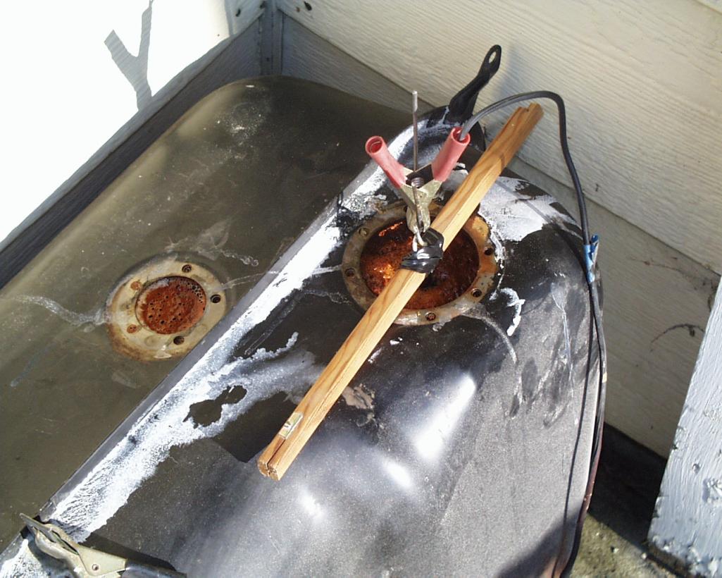

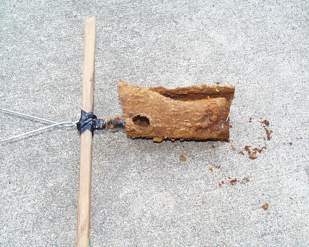

Here's a couple of shots of my tank in progress
The tank
The electrode (a rolled piece of heavy gauge sheet metal)

I did it for a couple of days, I switched out the soda solution several times and put in fresh clean electroded.
Side note... If you have any pin hole rust this will find it as the holes will start leaking as the process cleans out the rust

I've separated a 1/8 thick strip of mild steel in 6 hours, so some use rebar for longer life. Stainless lasts for a long time.
This process is line-of-sight. With the reserve gallon cylinder inside the tank you may be cleaning the inside of it, and missing the parts of the tank outside of that one gallon cylinder. Think of the process as creating electrical or magnetic field lines, as that is what is happening. I have etched field lines in one electrode.
Time varies for the process. For me, it's a week because I remove all the rust in the pits, and move the electrode around due to the line of sight restrictions. If you have a part with that grey zinc primer that the factory used, the time can really go up.
