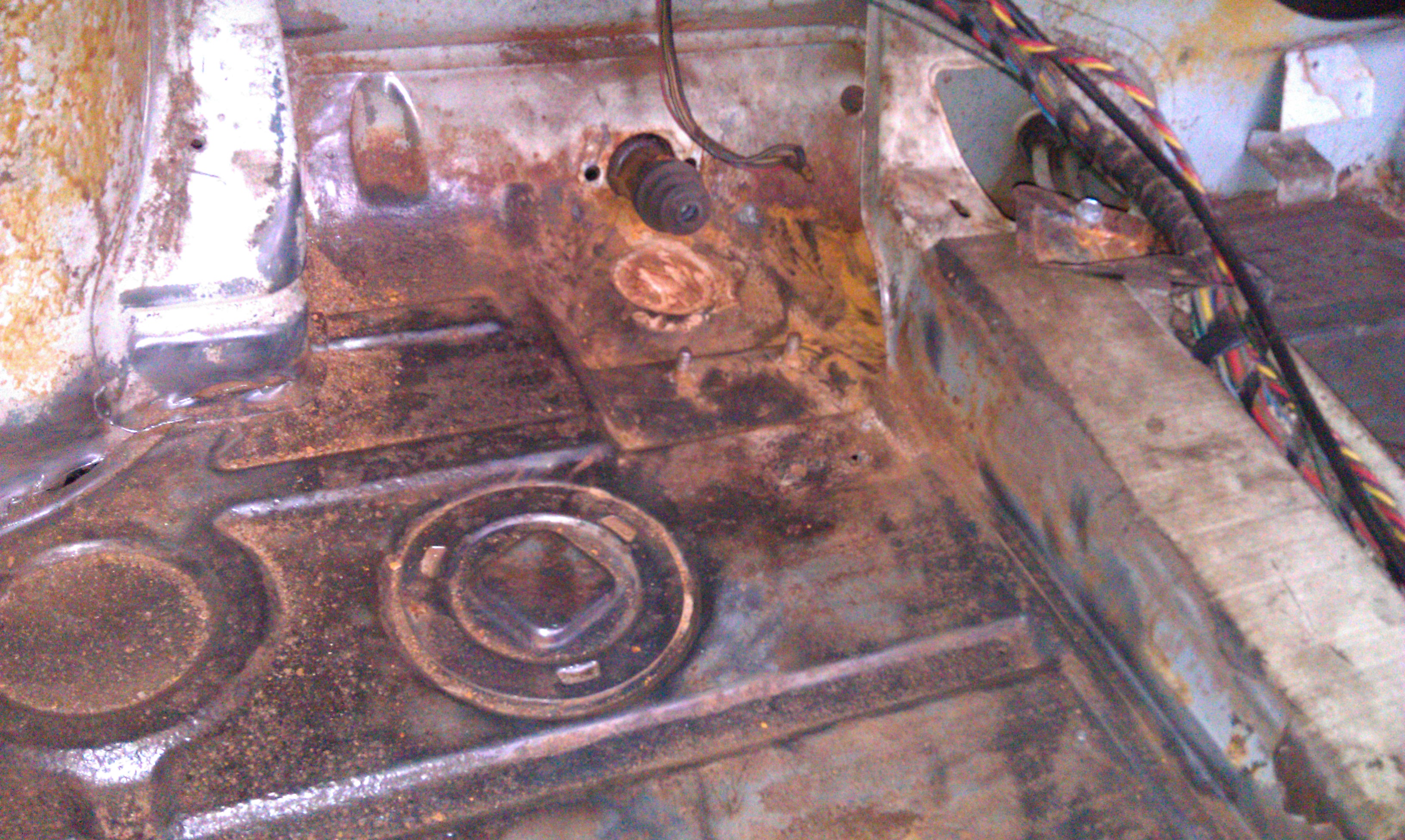

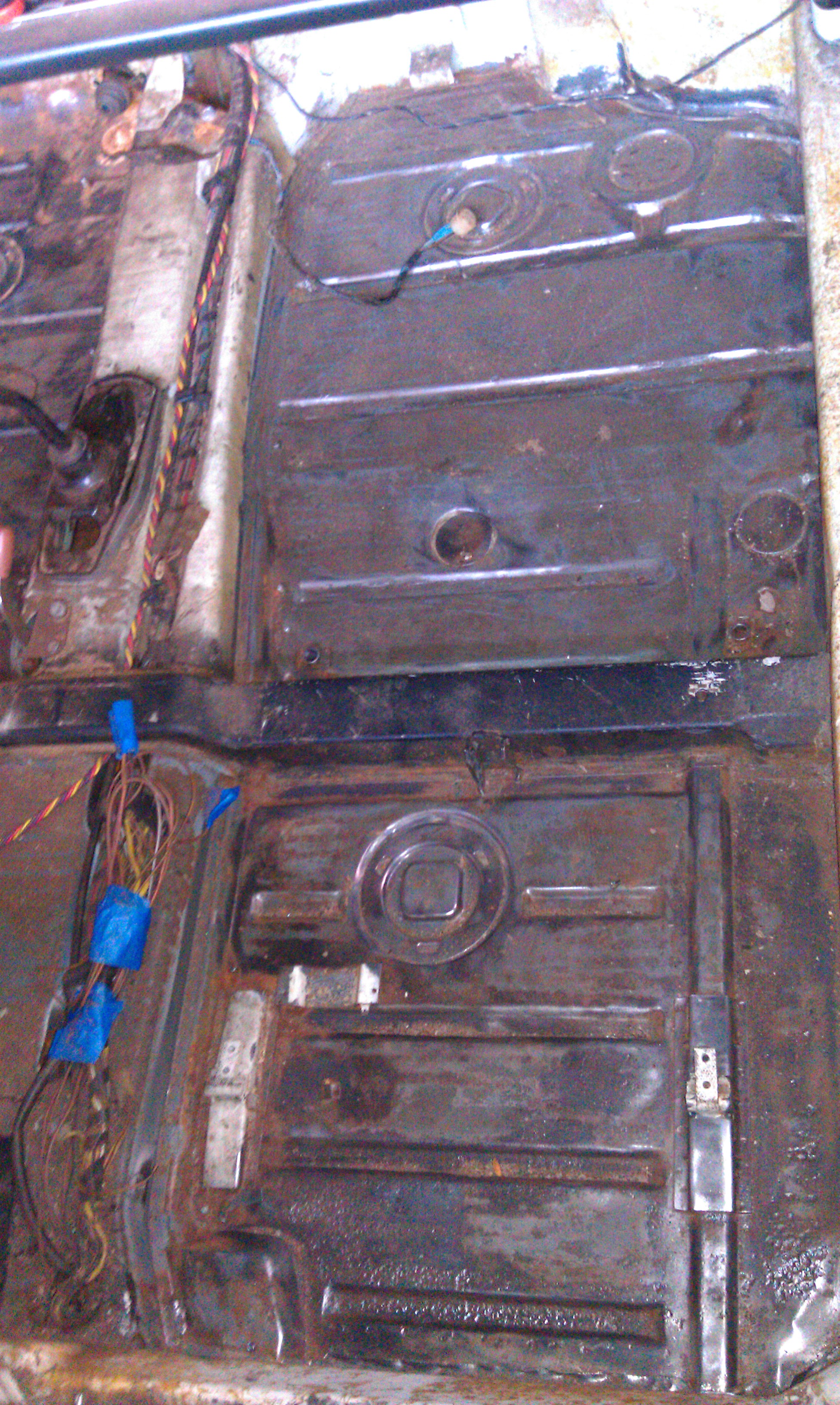

Last week I delivered the car to Sean at SD Autosports in San Diego. There's been a few leaks in the last couple of years and I infested rust into a relatively rust free car (IMG:style_emoticons/default/slap.gif) .
The pics are: under the driver's seat, under the passenger seat, and the same area before removing the tar. I thought that the passenger side looked OK, but it appears much worse once the tar was removed. It's actually not as bad as it looks, wirebrushing, rust treatment and new paint and that area will be good to go. The driver's side might need some new metal...

water sat in the pedal area. its already a fun car to drive but you would be surprised how well those 911 brakes hold back even 300 ponies. the brake pedal is so rusted it sticks like a line lock on a drag car.
used an air chisel to remove tar, scaling gun AKA needle vibrating gun on chinky rust
seam sealer removed with air chisel, finness, scaling gun, wire wheel use a face mask!

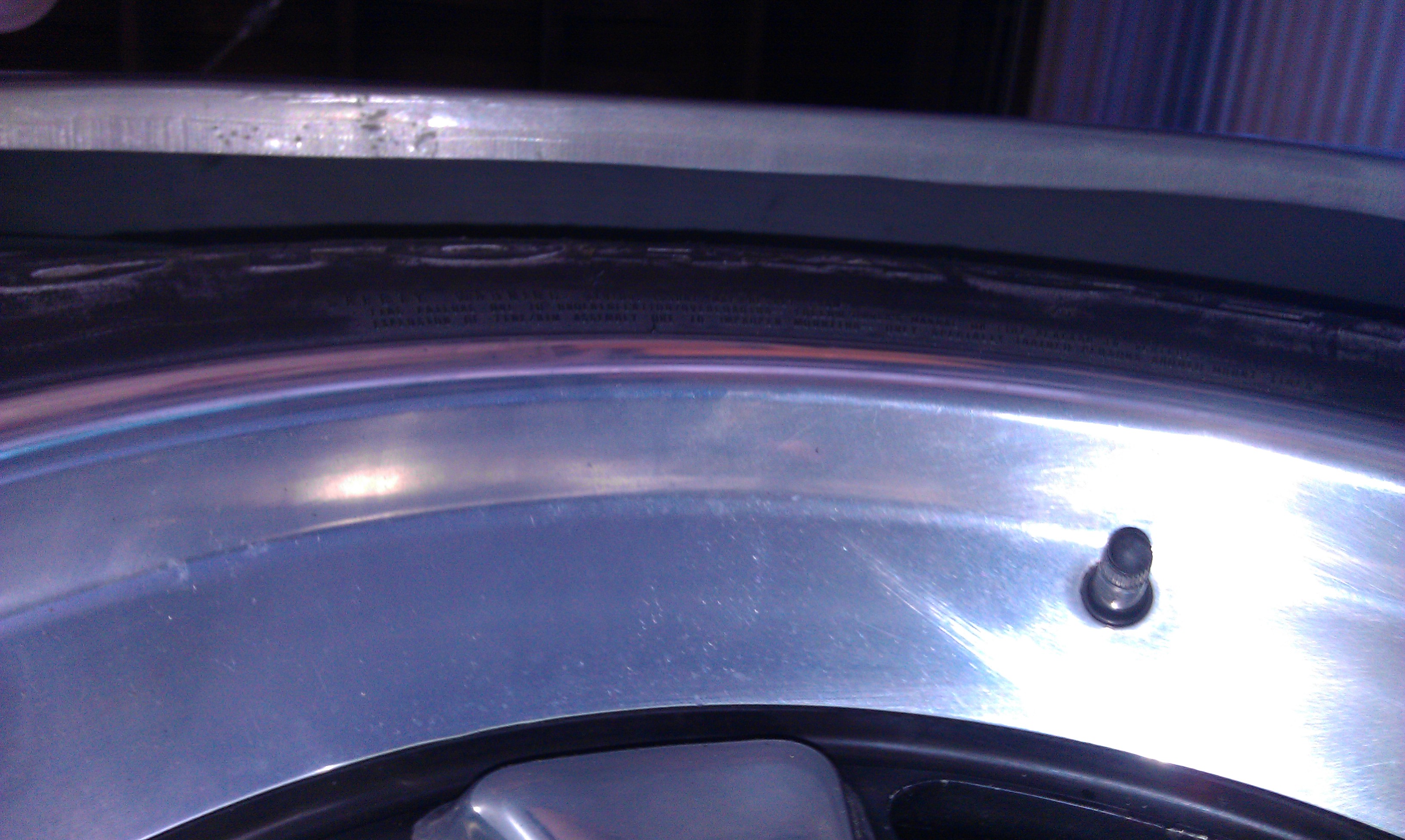

before I Gt it up. I checked and set the rear toe and camber so any referece clearances are more true around tire area.
bolted up the 16 x 9s and checked inner tire to inner trailing arm clearance

right is too tight to the arm. must investigate why the rt hub rides deeper.
car looks straight, lets tape em on and see where they land

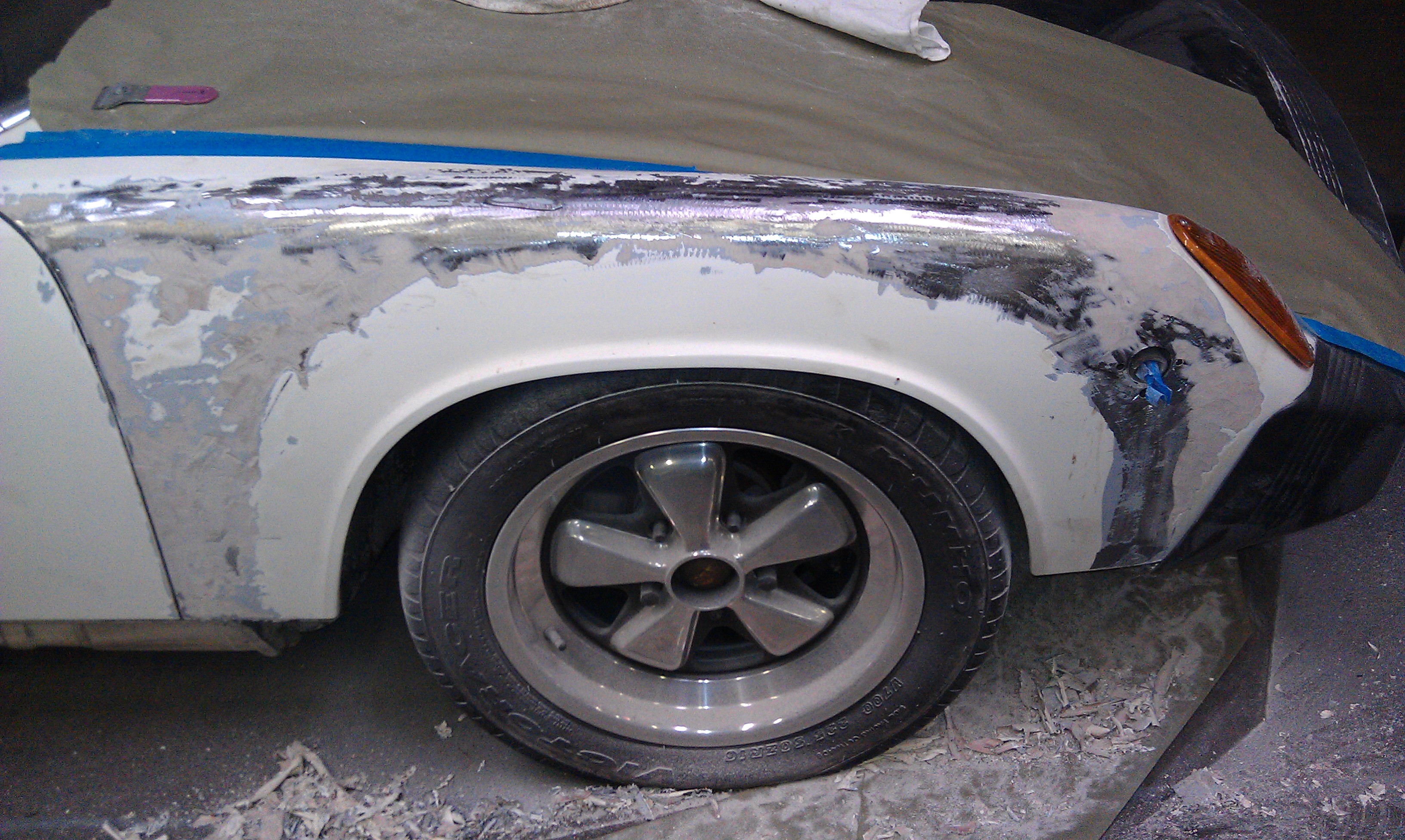

once I quit drooling, I marked them off and applied stripper
oh look, a 914 with a hidden treasure...golden bondo
heavy mid to low in front of A pillar at the base
mid to heavy around teh rt turn signal bucket

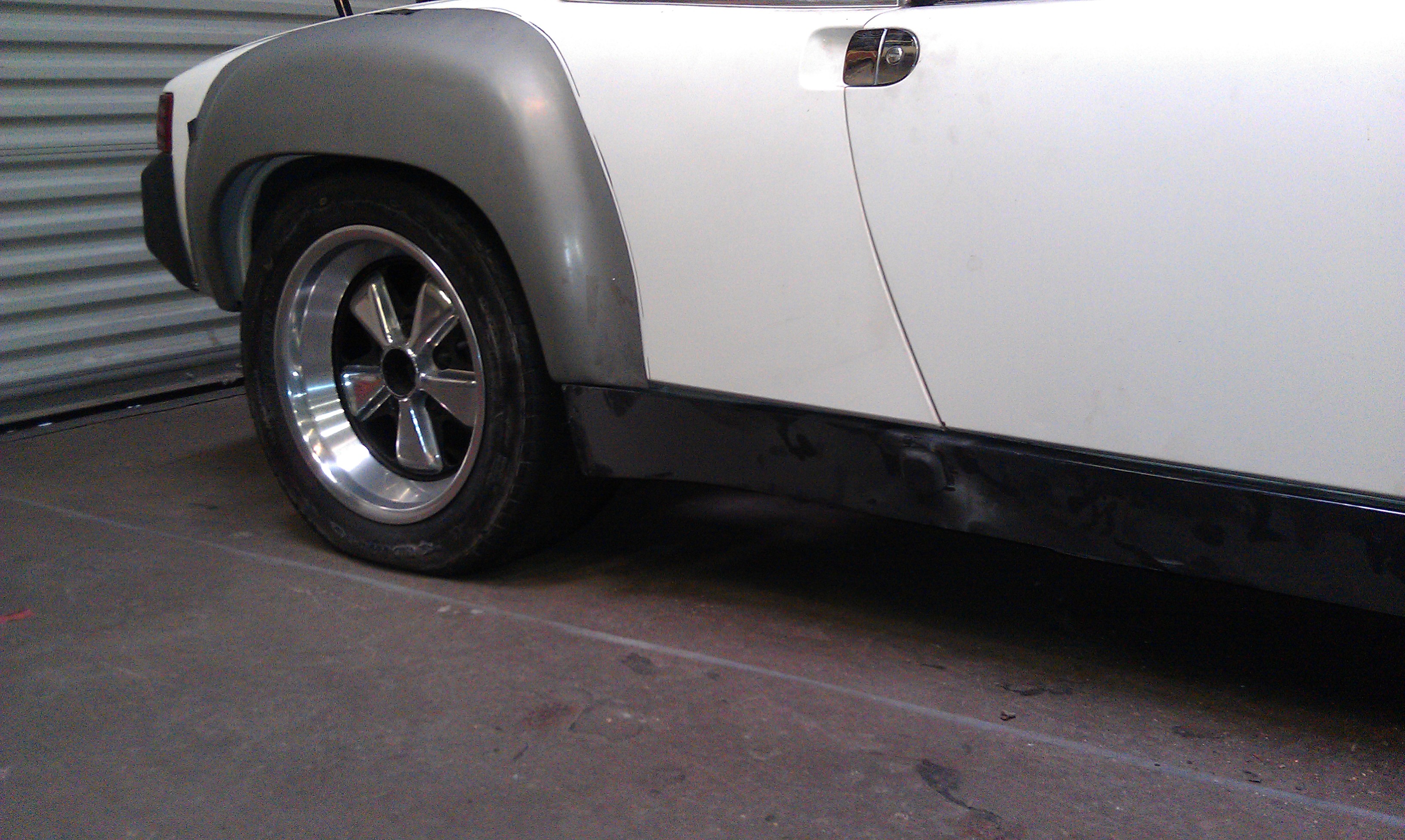

those fronts will get spaced out to fill the flares and back track width will increase to balance this out. as a bonus I cure teh terminal closeness of teh tire to teh rear trailing arm. once I measure, Ill post #s

original white car with only one red fender...hmmm? replaced.
