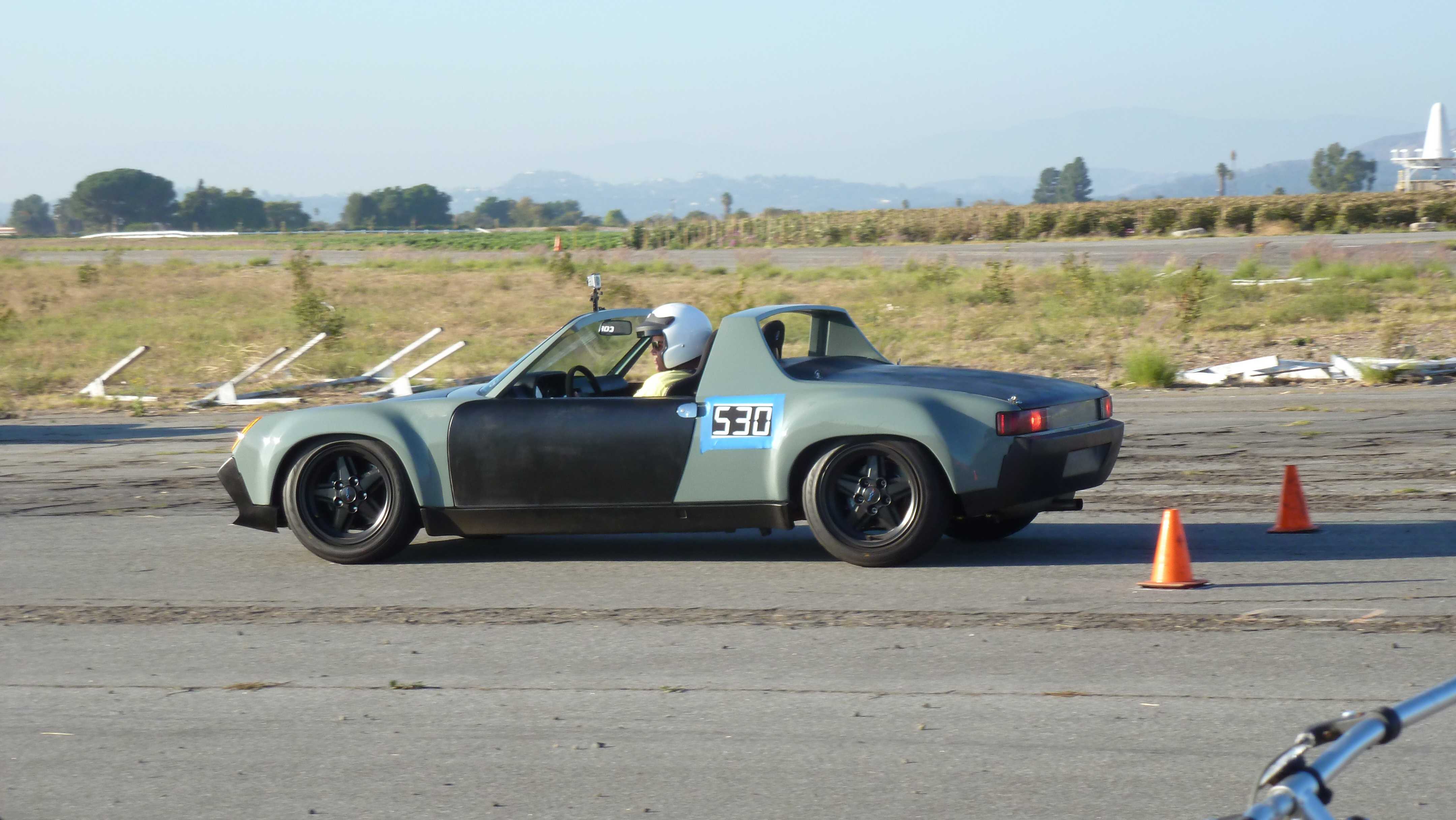

Junk is a kind assessment on that picture you posted of the T parts.
I have a working 2.2 with Zenith's from THOMAS. I would use those parts to hold down my day tent in a strong wind.
Keep your money warm in your pocket.
BTW, a T motor was not my first choice, but THOMAS did such a GREAT job on The Dark Knight, that I hardly had to do anything to make it scream on the 16th at the PCAOCR AX.
He did the tensioner upgrade and it does have an early Marelli (retard only vacuum). No Problemo!
Here are some pics. FLAT in the turns, and I was banging third gear to 5.4K rpm.
That is a lot for an engine that has basically 6 hours on it. Again, a 72 T with Zeniths.
