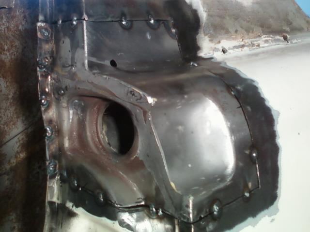

That's definitely one of those "tip of the iceburg" situations. I thought mine looked crappy when I started removing the paint. Once I got the whole section including the tube cut out, I realized how weak it was. Heck, even the solid good sections I got from another member here had a couple pin holes from old surface rust sides that I had to address before installing.
I welded in the driver's side section 2 wknds ago and last wknd I spent grinding the back sides of the welds, priming, seam sealing, and top coating the area. Lot of work, definitely, for a section of the car that would normally seem insignificant.

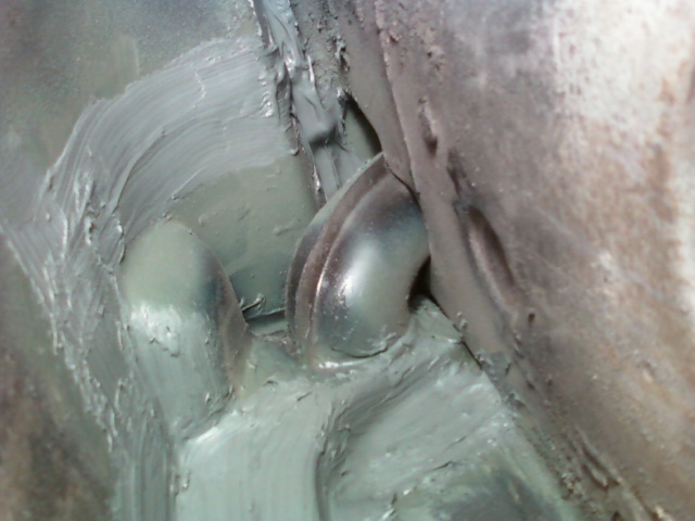

Maybe you can get rid of them--somebody else would have to offer advice on that. Supposedly they relieve pressure for two reasons: 1) to allow your ventilation system to work when the top's on and windows are closed; 2) to allow your doors to shut right without blowing your framless windows off the seal at the top when the glass is up. You could probably get away with closing off the door jamb end of the tube but then you'd still want the passenger compartment vented somehow. And if you opted to hack off the tubes inside the fender, you'd need to come up with a way to keep the moisture flung from the rear wheels from getting into the car. Always something.
Did I mention it's a tight place to work in?
This first pic was shot with my phone which was about all I could fit up there (IMG:style_emoticons/default/biggrin.gif)
