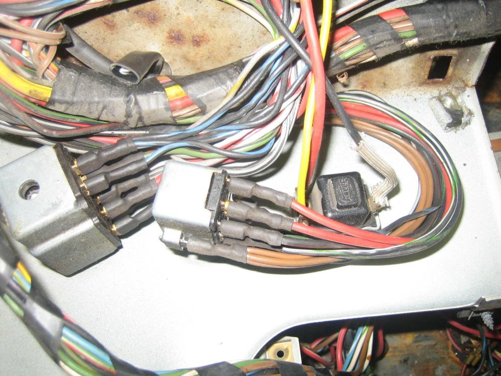

These exit the harness behind the dash to the left of the steering column. Black/Blue, Red/White and Brown.
Any help much appreciated!!

Fog lamp switch?

Ditto.

One of the switches maybe? Foglight switch?

QUOTE(kg6dxn @ Jan 2 2012, 07:57 PM) *
Fog lamp switch?
I was wondering but the PO had connected some other wires to that switch, I also could not find the switch in the wiring diagrams.

http://www.pelicanparts.com/914/parts/Elec...lectric_73C.jpg
http://www.pelicanparts.com/914/parts/Elec...lectric_73D.jpg
(30) - Fan Switch

Here is what used to be connected to that switch, the black went into the front trunk and was unconnected, the yellow was piggy backed onto the cigarette light ground and the red to the fuse box.

Thankyou, it is on sheet A
http://www.pelicanparts.com/914/parts/Elec...lectric_73A.jpg
Why did they go to current diagrams for the 75? Will use the 73, much easier.
