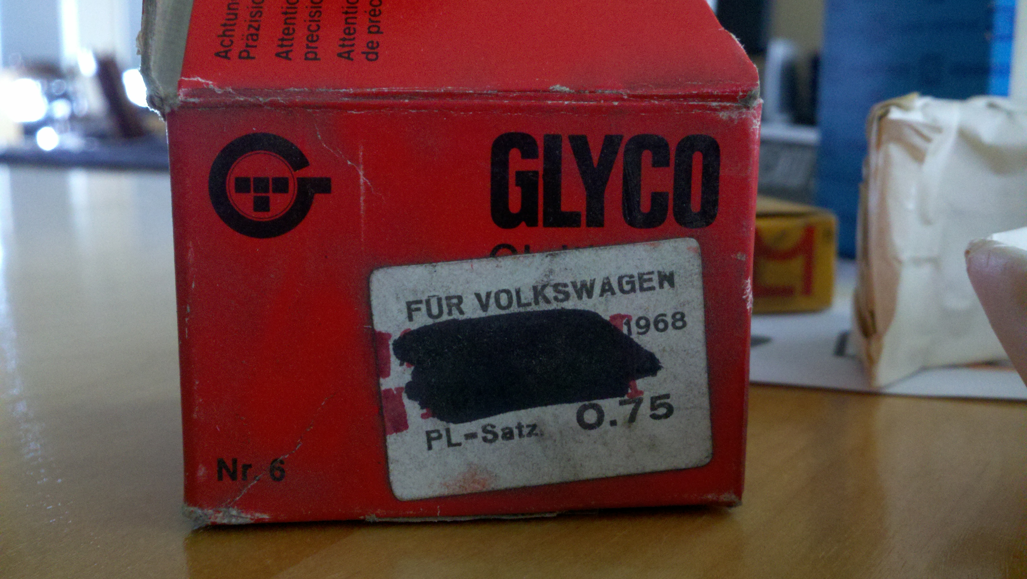

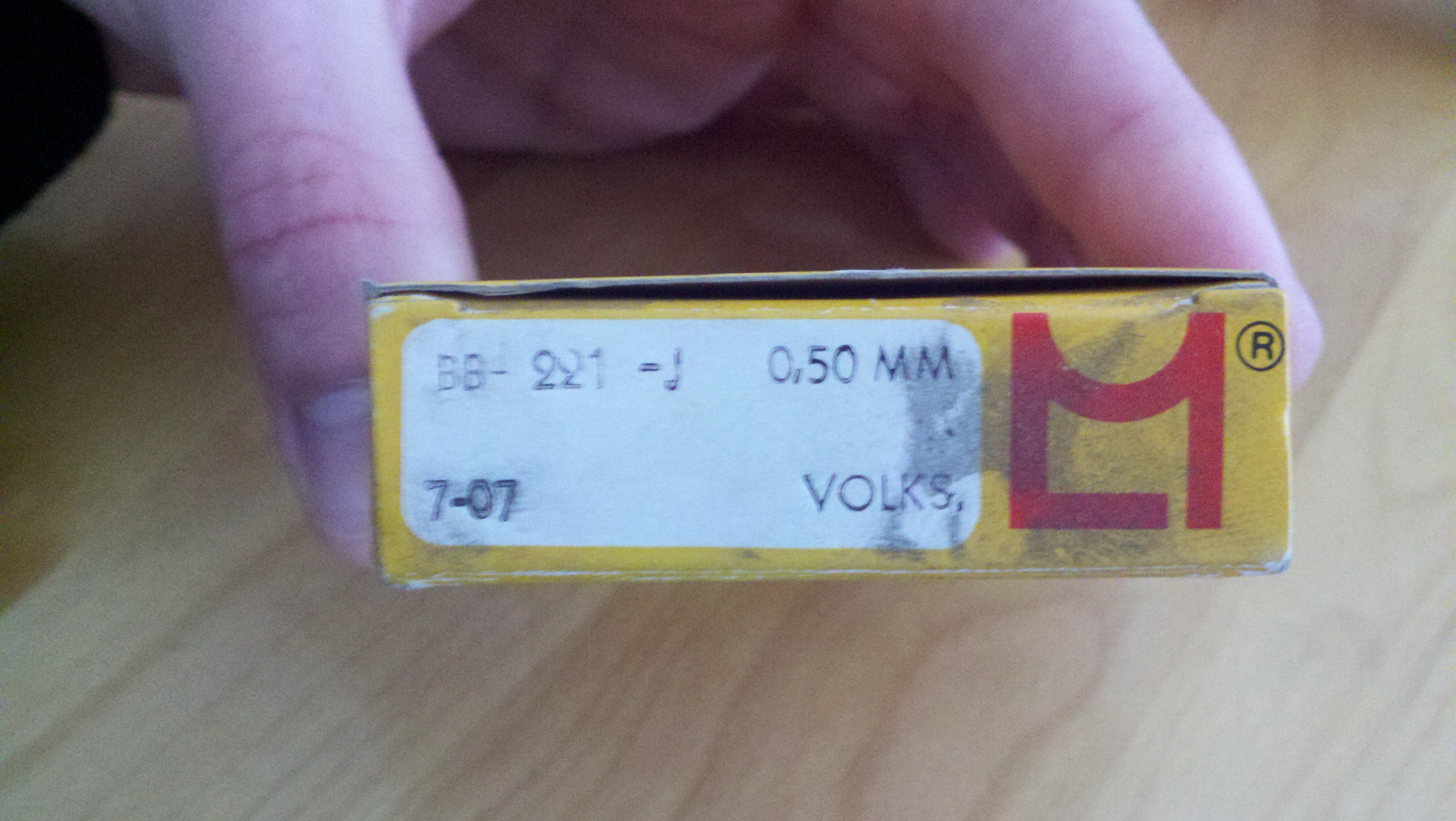

First, I have a set of connecting rods that I was told had been re-sized, but I do not know what size engine they are for. The only marking they have on them is an Orange Dot.
Second, I have two sets of connecting rod bearings that I cannot identify. I have pictures posted below of each. The set in the red box has "0.75 U. St. and 71 2793" stamped on them.
And I also have two sets of main bearings that I have included pictures of.
How can I identify which engine size these will work on as well as if they are standard size or if they are for crank that has been ground to accept thicker bearings, etc.?

021 105 713 ABR .... VW 411, 914, Vanagon 1.7/1.8
111 198 479 .... 1200 - 1600 cc ... Type 1 '61 - '79 / Ghia '61 - '74, Type 2 '61 - '71, Type 3 up to '73
021 198 485 A .... Bus '72 - '79 1.7/2.0, Vanagon '80 - '83
0.25 mm = 0.010 undersize
0.50 mm = 0.020 undersize
0.75 mm = 0.030 undersize
