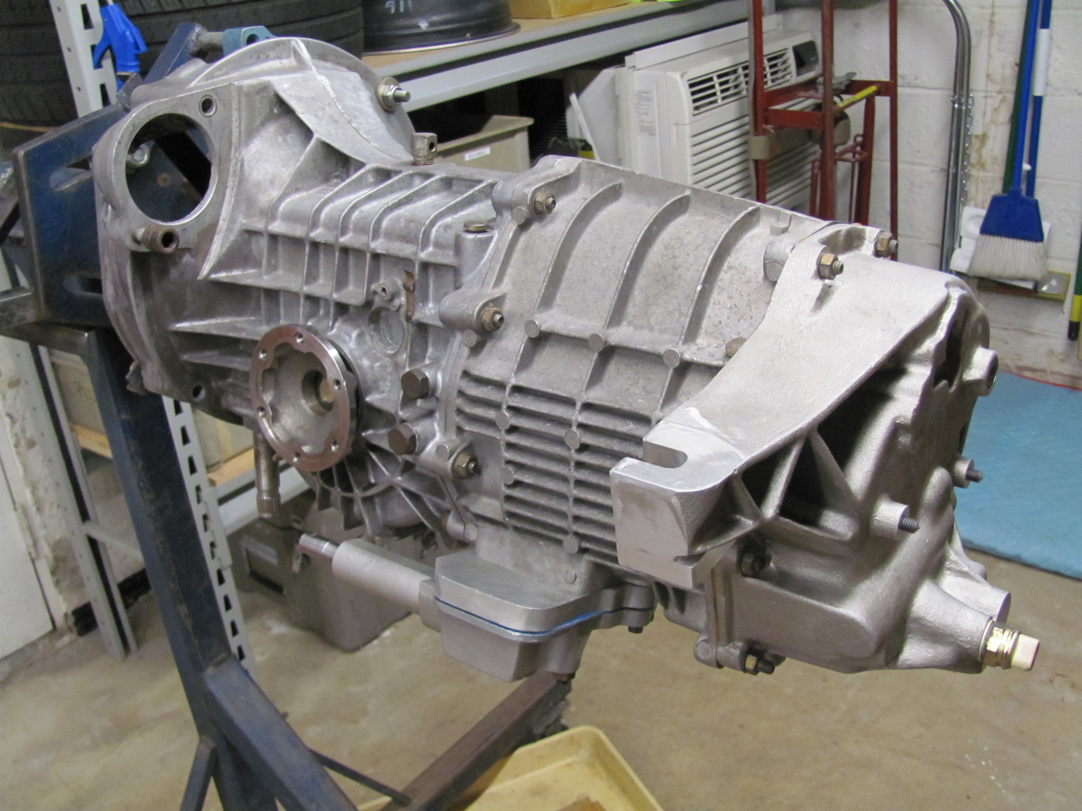

QUOTE(914dave @ Jan 7 2012, 05:52 PM) *
I'm using the 914 rennshift, I've used it for years with my 901. You can rotate the top 180 degrees for use with the 915. The problem I have is the early type Vellios is a copy of the 916. Which reverses the shift pattern. You can divise a cable system or buy some that are out there. I have a shop available to me and the Rennshift already, so I"m just solving the problem this way. Here's a pic of the shifter console coming out of the 915.
That intermediate section does not look like a 915 intermediate section, it looks more like an actual 916 transmission intermediate section. The tail section may be Vellios. I looked at the picture at full resolution and see that there is a plate bolted onto the intermediate section that I did not see without zooming in on the picture.....
I am wondering what kind of muffler you will use with the reverse light switch where it is. I would assume you could use megaphones or something similar.
Can you please post more pictures of that transmission? (especially where the shifter exits the intermediate section)
Thanks

"I am wondering what kind of muffler you will use with the reverse light switch where it is. I would assume you could use megaphones or something similar " John
John,
I have a triad muffler with GHL heat exchangers. Haven't trial fitted them yet. If it's too close I should be able to put a spacer between the exchangers and the muffler to move it rearwards. We'll see. I'll get some pics in the car with less in the background.
Thanks again for your help with the reverse engineering of that Vellios lever.

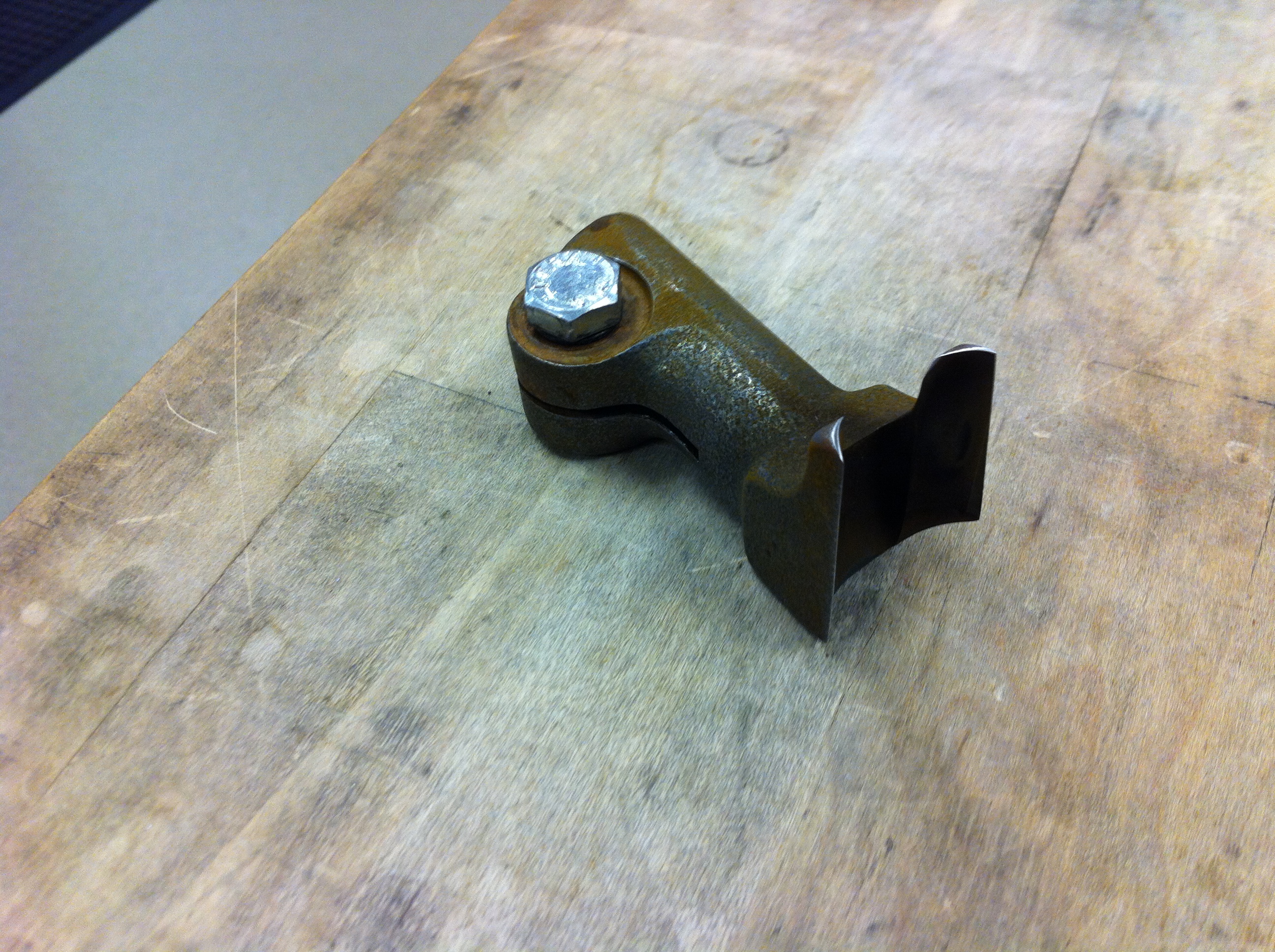

You're right about the later Vellios kits, they had the sideshift style console. The early ones had the 916 style console. I used pic's of Bott's kit to fabricate the internal bracket for my kit that was missing. My kit was also missing a shift lever and was the end case was machined incorrectly. John ( here on World) lent me a lever out of his Vellios to reverse engineer. Thanks again John! Chris Foley helped me out with pic's of his Bott installation for mounting the internal supports bracket. I made a fixture with my 901 to check the mounting alignment of the Vellios and machined it accordingly. My kit was very cheap and I didn't know it was missing parts. I found it at a Porsche race shop swap meet, I didn't have time to check everything out before I bought it. I'm just lucky that people here helped me out and I have a machine shop at my disposal. Here are pic's of the internal shift rod support that I made and some of the shift console that John wanted.
here are pic's of the shift lever that John lent me to fab
Attached Image]"
Attached Image]"
Glad to help! The parts you made were by far nicer than the original Vellios part.
I'm glad that you are getting closer to putting it all together. One thought on your shifter question would be to find out how is the German guy (who is making parts to clone a 916 box) is shifting his.

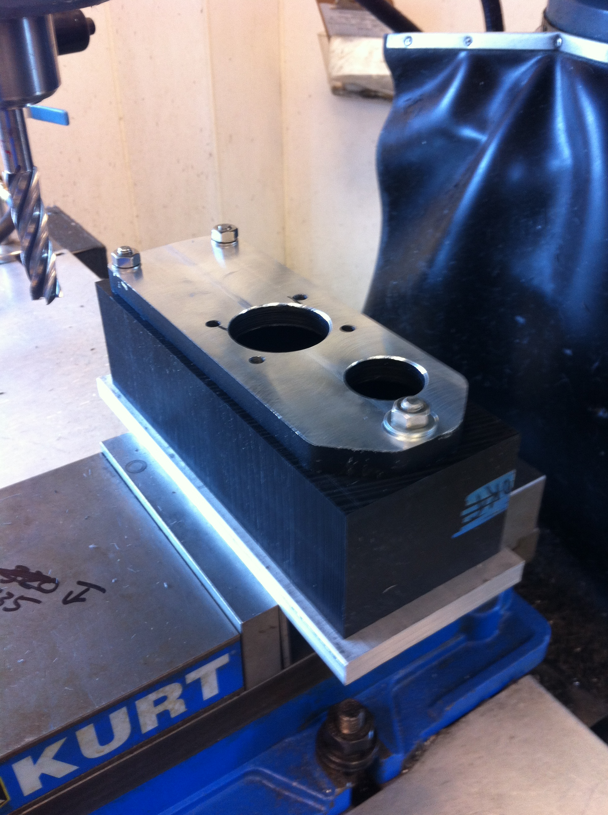

OK guys. I know it's been a while. Went to some serious overtime at work, been trying to squeeze some shifter work in. The first thing I made was a riser for the shifter. It's black delrin.
The machining process with the shifter base mounted to it.
The inside view.
I've run out of space for the pix, more in the next installment.

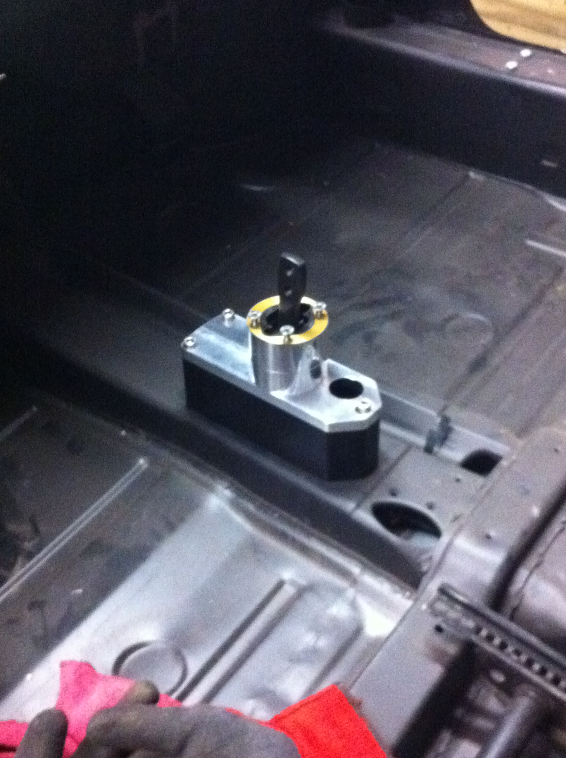

Here's a pic with the shifter mounted in the car.
