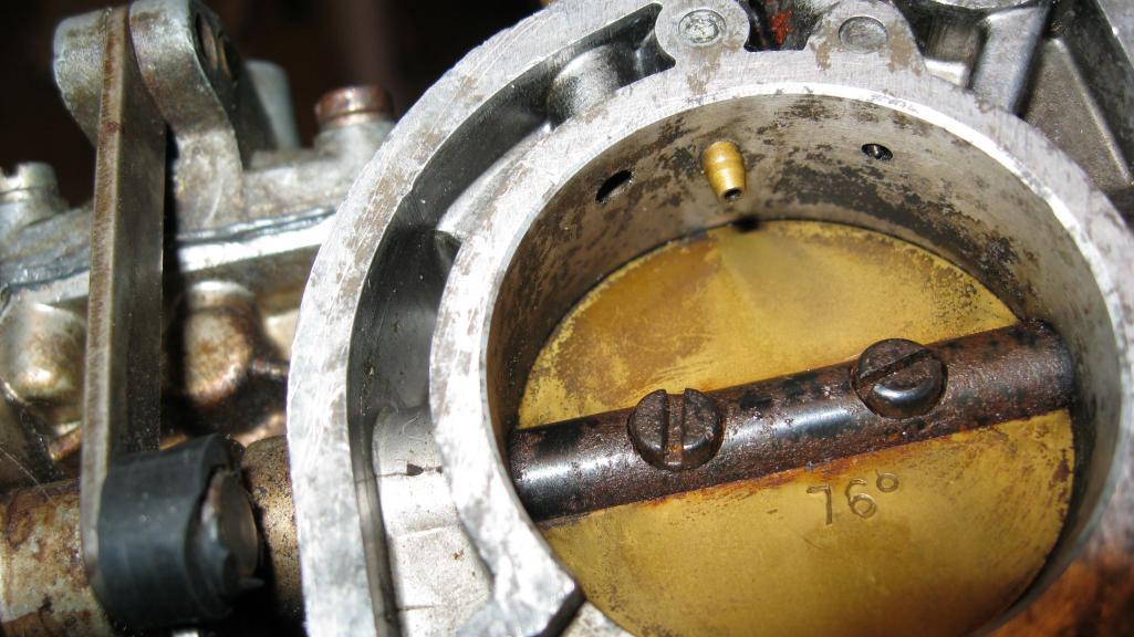

So while I wait to finish all the metal work on this car, I thought I would begin to get the carbs and distributor straight so that I can start the thing up and go when its ready. I've got a set of Italian Weber 40 IDFs that I'll probably just go ahead and rebuild while I'm at it. Also, a Bosch 034 SVDA dizzy with vacuum advance. So, the dilemma I have is that these carbs don't have a vacuum advance port already drilled. I know this has been covered ad nauseam in other threads, but I hope that this will be the final one and potentially a "how-to" for others.
By following the Weber diagram that was posted awhile back on the Samba, we can see where the later models included a boss for the vacuum advance port, directly above the brake/manifold vacuum tube. That diagram is below, but unfortunately I do not have any photos of a later Weber 40 with the actual boss from the factory.
If you look at the Webers I have, there is no existing boss to be drilled. The best you can do is look at the diagram and try to use it to mark a hole to drill. The problem is, all references that I have read say that the hole should be drilled just above the throttle plate (butterflies) so that your source of vacuum is throttle-controlled, not the brake/manifold signal, which is on ALL of the time. I have confirmed this with three different carburetor shops in the area, but all of whom did not want to drill the port for me. I was told I could do this myself. Attached Image
So, I am going to give it a shot. I'm looking for final confirmation from anyone here before I do, however. In the image I posted above, the hole I marked to be drilled is just above the throttle plate, but it differs from the later factory location. Did Weber put their vacuum advance boss in the right place, or am I missing something?

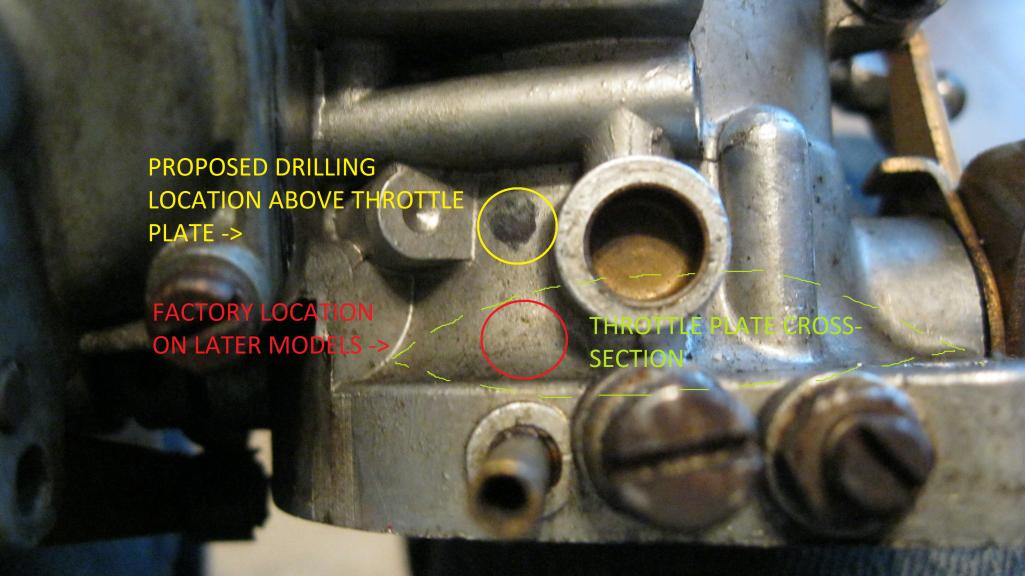

Here is one more picture, showing where the throttle plate intersects the throttle body. Again, the potential drilling sites are marked.
I have used a micrometer to verify exact locations of specific components. The bottom of the throttle plate is about 5/8 of an inch from the bottom of the carb, and the plate itself is 1/16th in thick. I have mic'd the hole for the existing manifold vacuum and its a 1/8th inch hole and the tube is 5/32 OD. That means if I were to drill the hole above the throttle plate that it would need to be a minimum of 0.75 or 3/4 inches above the base (5/8 + 1/16+ 1/16th - half the diameter of the hole). I'd probably add a little for comfort.
I'd like to hear what everyone thinks. From what I read, this should be correct. My biggest concern is diverting from what the factory did, but since I cannot find a picture to verify that they drilled below the throttle plate, this is my best estimate.

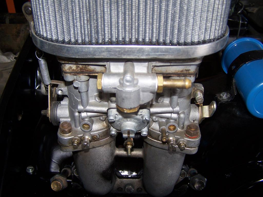

You have obviously done research on this (far more that I did). I am not questioning what you are doing, just passing on my experience. When I bought my car it had a poorly built “high performance” 1.7 that was punched out to over 2.0. It had stupid high compression and was running an 009 POS dizzy. I tried for 2 years to get it to run right. It finally dropped a valve seat.
I replaced it with a factory 2.0, but kept the Webber 40’s on the car. The shop that did the final set up used the stock 2.0 distributor and ran the vacume line to the existing factory port you already have (next to the mixture screw). That car ran fantastic. It started with no effort, It stayed cool, had zero hesitation and pulled great. Only really cold weather or a once in a blue moon clogged idle jet gave away that that it was not fuel injected.

For vacuum advance you want unported vacuum. This means that the vacuum must come from a source prior to the throttle plate.
Make sure that you drill above the throttle plate.
Vacuum from the manifold is not good.
Vacuum from the air filter chamber is fine but not best. You could use this to check the general performance improvement before you drill the carb.
One port form any of the carbs is sufficient and recommended. Don't connect the vacuum ports from different carburetors as there is no advantage in doing so.

I knew to drill above the throttle plate - thanks for affirming this. I was also told I only needed to drill one carb, since the vacuum is so small it won't really change the airflow much. I'll try it with one first, and if for some weird reason it won't run right, I'll tee them together.
I'll be posting how I did all of this and show pictures at the end, in case anyone else needs to do it. Hey, maybe I'll even get a sticky!

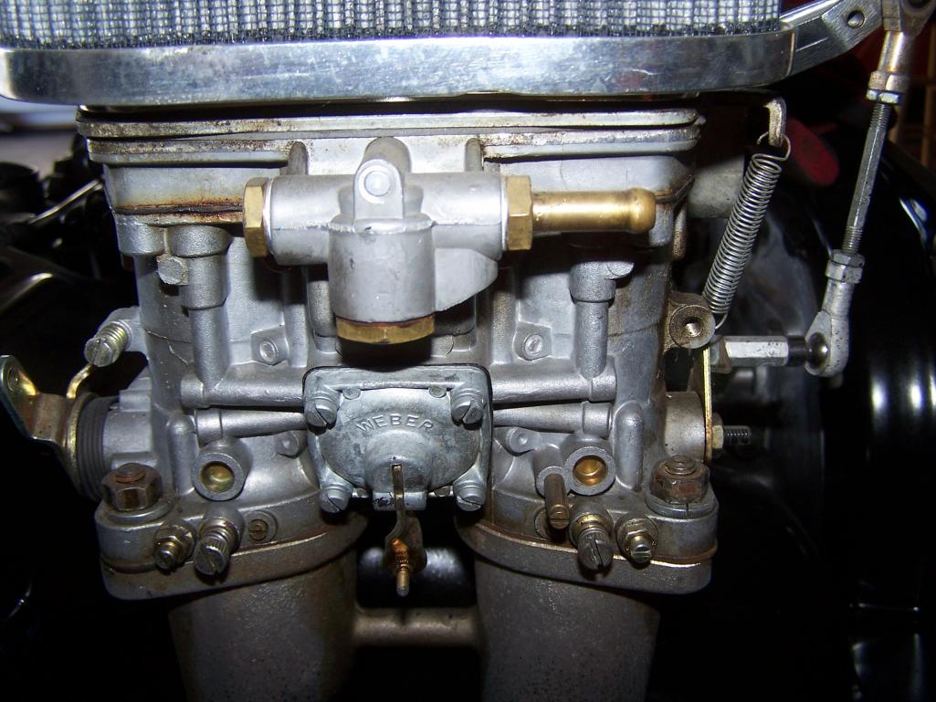

Here you go. Weber 40 IDF 70 stamped on both.
On the left carb note the vacuum tube with the small screw plug. On the right carb in the second pic, you'll see a vacuum tube in the same location that is not plugged. That's where the dizzy pulls vacuum from on this motor.
Left carb:
Right carb:
