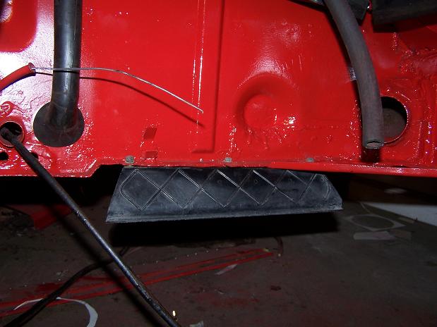

This piece of plastic was mounted on the rear edge of the floorpan at the engine bay on the drivers side. The one on the passenger side mush have fallen off due to rust.
Not looking for a concourse car here, but don't want to omit any pieces that will cause me problems down the road.
Anyone run their car without these plastic flaps?

Unlike my time here on the world site, the flaps are there for a reason.
If you are in colder climates, you are probably fine.

I can see the flaps making a difference in cooling. With the bottom of the car being so flat, the air just goes right by. With those there, the turbulence slows the air down and moves it about along the cooling fins below the engine. I'm going to install some on my early car, actually. Seems like particularly on the freeway, when head temps are higher and the air is going by faster that these would come into play.

Think they were put there by the Porsche engineers to create air disturbance over the cylinders to enhance cylinder cooling. If they are not there, then the air just flows straight past the cylinders.
I run them on my race car.

The pair of these parts introduces turbulence to the air flow under the car, aiding engine cooling. You should have them. The Cap'n

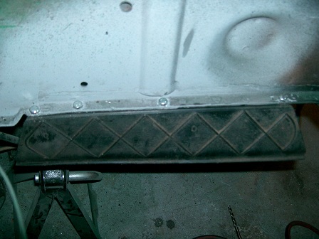

Here's my 71 retrofitted with air dams.

I made sure they were on my build. They create a low pressure field under the engine allowing more air to be pulled through the grill.

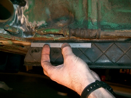

The plastic air dam itself is threaded on my car. Find the parts, drill four holes on each side where the rear firewall meets the floorpan. Shouldn't be too bad if nothing is in the way. (IMG:style_emoticons/default/biggrin.gif)

3 M5x.8x10 with nuts, washers and lock washers per flap. Drill the rear edge of the floor pan where it extends into the engine bay.

Have one on the way from a 914world member. Thanks for all the info. Measured the drivers side placement, drilled holes yesterday & mock fitted air dam on the passenger side:
