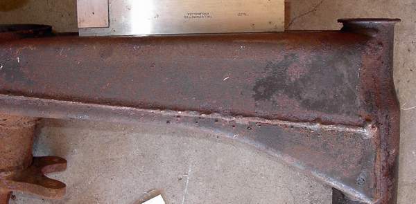

Here's a pic of bent arm with straight edge on it.

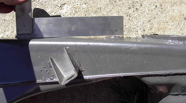

Heres an unbent arm.

cool thanks for the pictures...
you mentioned a kink..
Is there a kink.
what I'm getting at is could there be a chance that the arms are shapped different due to build tolerances or is it definitely bent.

That picture of the bad arm is the straight edge on top of the bulge, kink, whatever you want to call it. Thats definitely not a factory thing build thing. That is suppose to be the flat side of the arm.

I'm with Brant on this, here's my theory...
When bent, one surface of structure must stretch (same amount of material, more distance) and the opposite surfuce must crumple.
The face you are checking is the outboard side of the arm, right? The most likely way an arm will get bent is by sliding into a curb, an outside-inside motion. Therefore, the outboard side must get longer, the inboard side will get shorter. Bending a structure like that would cause that face to pull in, not push out. Unless there is some interior member.
Check and compare the top and bottom faces of both arms too. They should be tweaked as well. It looks as if the seams started life out straight, are the still straight?
eeyore
post Aug 31 2004, 12:23 PM
Posts: 889
Joined: 8-January 04
From: meridian, id
Member No.: 1,533
Here's what I'm saying, with a picture. (Granted the trailing arm is more complex)
If you take a piece of channel and bend it, the face of it will want to stay as close to the green line as possible. That causes the face to become convex between the top and bottom corners, and the surface never protrudes beyond the edges. Therefore, although there could be curvature, the bump indicated by your straightedge shouldn't be there if the trailing arm was bent in an accident (normal use?).
Also, the corners of the trailing arm don't seem to indicate the same level of (or any) distortion that the straightedge shows is going on at the face.

Not the way I would check for a bent control arm. I would make a two bushings to fit in the front of the control arm (where the rubber bushing are now) and insert a straight steel rod theough the bushings. Then bush the axle bearing surface and put a straight streel rod in it. Then check if the two steel rods were in the same plane. Anything else seems like guessing to me.
That looks like heat distortation from welding on the controll arm to me.
