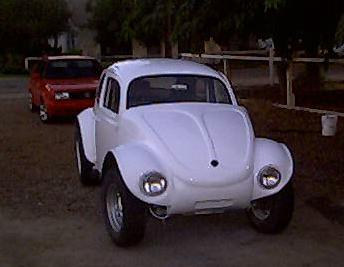

Mr.C
post Sep 10 2004, 01:04 AM
Easy does it
Posts: 612
Joined: 31-December 02
From: Central Cal
Member No.: 61
Looks good! I painted my baja bug last weekend in a friends dirt drive way. Guess what I used. I bought a gallon of Rustoleum and a gallon of Acetone! I figured it was going to get beat running through brush anyways so who cares as long as it is one color. It actually turned out pretty good.
