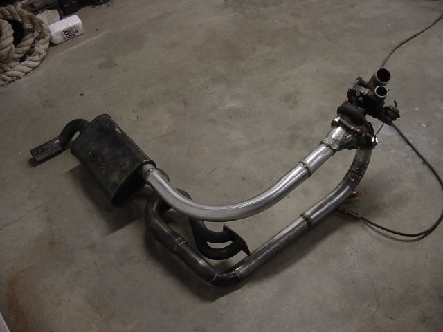

Ok, here's the one some of you already saw - the completed exhaust from Friday.

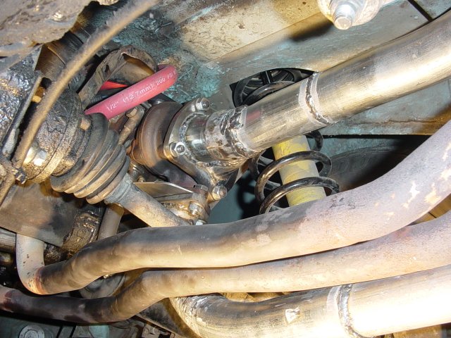

Here's the best shot I could get of it on the car. It's on the passenger side tucked up there right at the front of the tranny. The intake side just peeks throught the engine tin enought to get the intake plumbing into the engine bay. Oil return drains almost striaght down with a little 'L' where it goes into the pass-side valve cover. The orange hose is for cooling air to the bearing housing. I'm running a 1/2" hose from the vapor-canister port on the impeller housing on the engine to the water-jacket on the turbo bearing housing. It's definitely not as good as running water through it, but has to be better than just plugging it off. There is a decent amount of air-flow out of the hose anyway.

I think you can improve your engine-turbo exhaust plumbing though - by running it all the way to the back of the car and then forward again you are allowing the exhaust to cool some, which means it is shrinking and hance it takes more of it to push the turbine around. That's a little fab project that you can do later though.

You are exactly right. This was my biggest concern and the subject of much debate (in my head). I had originally planned to chop up my heat-exchanger tubes and use them to make a header with the distance between the heads and the turbo as short as possible. I decided it would add at least 3 or 4 weekends to the length of the project. So I bagged that idea and did what you see in the interest of time. There is a good chance I'll build up a decent header (really short) this winter.
-Ben M.
Ben,
I'd simply wrap the exhaust with header wrap and avoid all the extra header fabrication work. It'll really help hold the heat in, and I'll bet the turbo will come-in sooner too (2700 RPM is kinda high, but easier on the rods). How much boost are you getting and/or what's the waste gate set to? On my turbo 914 (circa 1975), I had to fab my own heater boxes on the Crown turbo headers, which wasn't a whole lotta fun; though they did work well.

Header wrap: That's exactly what my engineer Dad said. I said, "yeah, but the pipes are still long" and he reminded me that the pressure response between the head and the turbo is speed-of-sound, so keeping the heat in is really the only issue. I'm not worried about header-wrap rust. I don't drive in the rain, and being a turbo these pipes will rust from the inside out before header-wrap rust is ever an issue. (Dad asked why I didn't do the whole thing in stainless and I said "Because you aren't paying for it".)
Thanks for the west-side invites, guys. I cringe though at the thought of letting you look closely. he he. I plan to weld on the SC flares and paint the car this winter/spring. If I do that and tidy up some wiring ugliness maybe I will bring it over if there is a gathering next summer.
