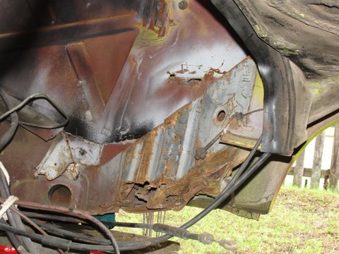

a few pics of hellhole and below

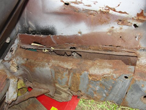

a couple more

Assuming that no other rust repair is needed (not likely), the sheetmetal alone needed to replace what is shown in the pics above will probably cost as much as a reasonably solid roller or tub. The time, labor, and parts that go into the rust repair of a 914 are really no cheaper than what goes into the rust repair of a 356, IMO.

Wow. It is doubtful that you'll be able to fabricate all of those pieces. At a minimum you're looking at #8 - $300, #10 - $230 from
http://www.restoration-design.com/Merchant...tegory_Code=914
The other stuff can be fabricated but you would probably want to buy it from them. Restoration Design makes great stuff. Optionally you could do what I did and find another member here parting out a car who could cut a console and frame pieces for you. I would say closer to $1000 in the necessary steel. Then multiple hours measuring, cutting, welding and priming/painting. From the looks of it, there is probably MUCH more rust in other places (in the long) that will need attention. Its not terminal, but as said previously, you are the only person who can determine that. I got away with only the metal work on my car, which was in almost the same shape for only about $300 bucks. But I bought a used piece cut out of a car and fabricated the other pieces. Not to mention buying a welder and other tools and the over 50 hours put into it alone. Very rewarding experience though.
