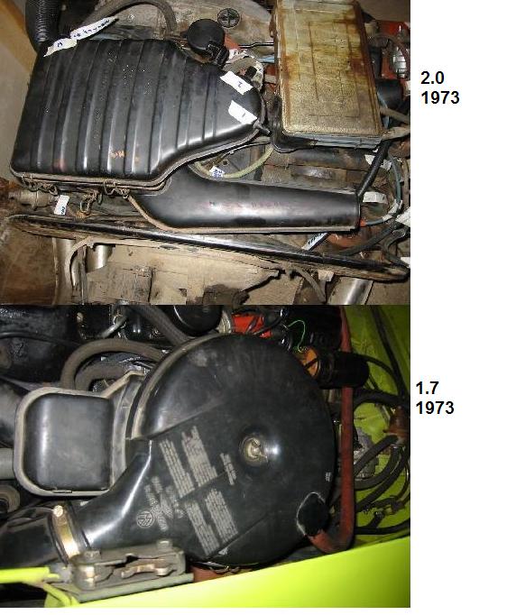

wilchek
post Sep 14 2004, 07:00 PM
Posts: 506
Joined: 8-June 04
From: Eastern Pennsylvania
Member No.: 2,177
Just look at the air cleaner see below
wilchek
post Sep 14 2004, 07:40 PM
Posts: 506
Joined: 8-June 04
Member No.: 2,177
1.8 L-JET BELOW
