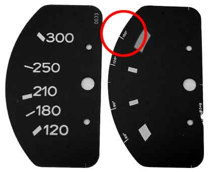

All of the talk about 1/3 or 1/2 of the way up the gauge or 5mm from this white line etc is pretty useless. What you need to know is what the actual temperature of the oil is. With 30 year old gauges and senders that have been mixed and matched in a variety of ways, there is no way of knowing what the temp is unless you correlate it to real oil temps.
Easiest way is if you have an infrared temperature sensor. Shoot it directly at the sump screen plate for an accurate measurement of your oil temp. Do this for a variety of indicated temps on your gauge. Then you will know what temp corresponds to the indicated levels on the gauge.
If you want, you can even take apart your gauge and label it (although not so easy with a center console gauge).

Demick
That is really cool. I get temp ranges like Andy but I want to be a little more precise with the new engine since I'll be on the edge of needing a remote cooler. Your solution looks great.
Dave

The outer edge of your gauge has numeric markings in deg C. Get to know your gauge and where the motor runs. Or you can buy or make a new gauge face.
Demick

Very scary that Porsche considers the red line for oil temp to be 300F!!
