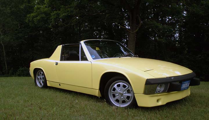

I have painted with both. The PPG DBC was thicker and would allow you to lay down a thicker first coat. After that I could not tell the difference. I had to almost lay down a tack coat of the Omni, it would run if laid on to thick. Omni is actually less then 1/2. I paid $66.00 a gallon for it. I'll post two pictures, the completed car was painted with DBC, the partial car is with Omni. I would paint with Omni again. Painting is all in the prep! 90% prep, 5 % skill and 5% luck! (IMG:style_emoticons/default/biggrin.gif)

Here is the Omni. I actually liked the way the Omni clear layed down. I would never paint single stage, it is not as forgiving. MHO

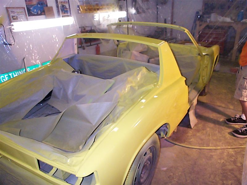

I like the PPG Delstar, doesn't need a clear coat. Color sands and buffs out real nice. Also, real easy to touch up the paint chips you get from all the uncovered dirt trucks running on the freeways.
I use a 2 part epoxy primer, then shot a tack coat of PPG, then a couple of full coats, or until I run out of paint. Once you add the hardener, gotta shoot it. When I did my 6, I did one panel at a time, took 3 1/2 months, but then black is a bitch to shoot, panels have to be perfect. Attached image(s)
