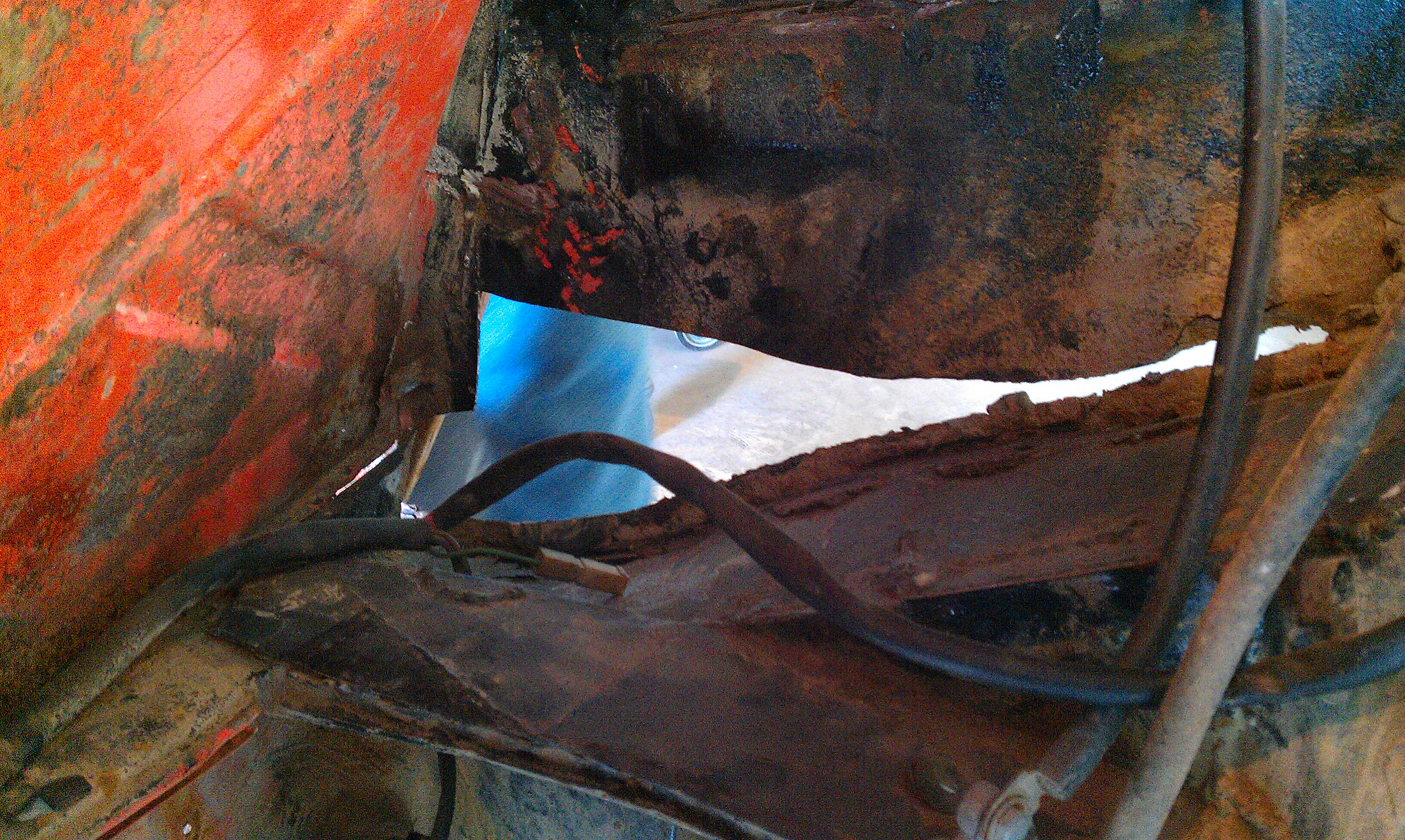

Here's the left side longitudinal opened up.
The muffler was in perfect condition.
