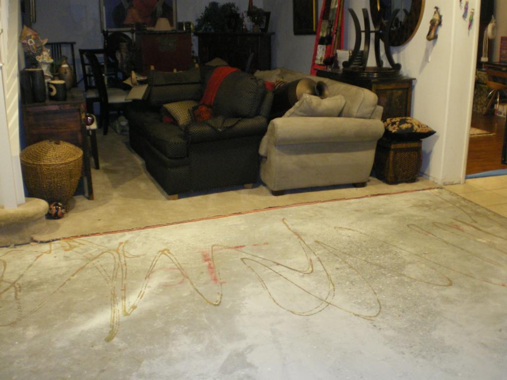

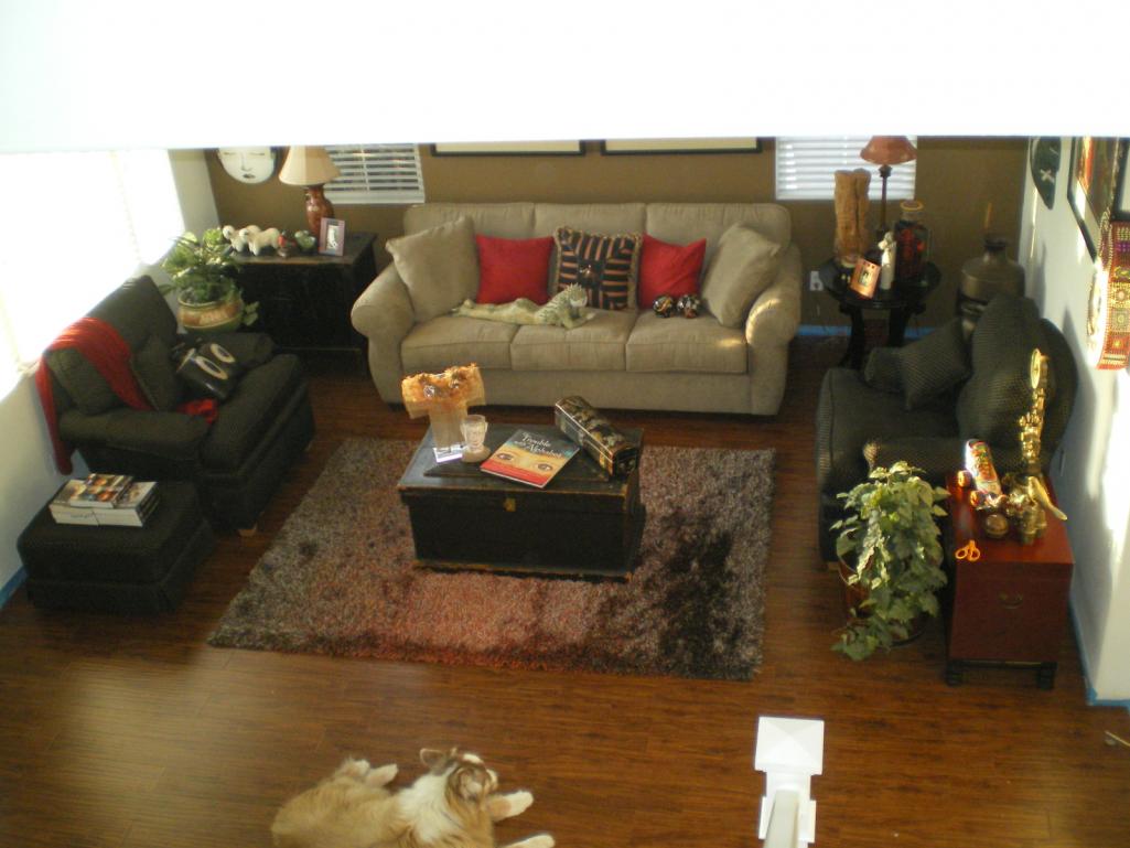

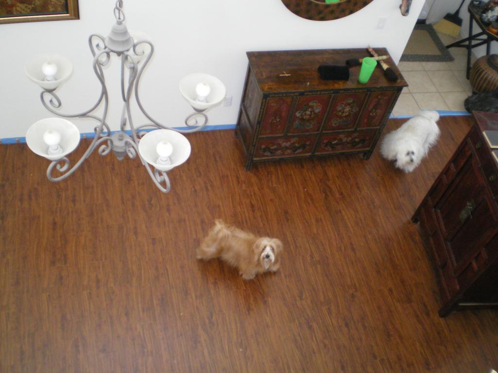

So what in the Hell was I doing the rest of the time.
Wood flooring for my wife. Just the down stairs for now. Appx. 1500 sf. The car was easy compared to this. (IMG:style_emoticons/default/lol-2.gif)

Wood floors SUCKKKKKK! I had to do a whole downstairs in bamboo tongue and grove once. My knees and back have never hurt so bad (no sick jokes)
