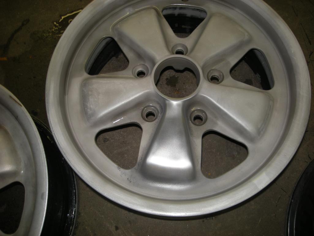

So I'm doing the RSR treatment to my straight but cosmetically challenged Fuchs.
First I stripped the anodising from one wheel using a caustic soda (also known as lye or Sodium hydroxide) solution, it takes off the anodizing like a champ, but hardly touches the old paint. Bottom left rim first pic has been in the caustic soda . So it was off to the hardware store for some stripper.
The stripper worked, but I had to take off the paint leftovers with the bead blaster (last pic).
They are going back into the caustic soda solution again tonight to get rid of the rest of the anodizing.

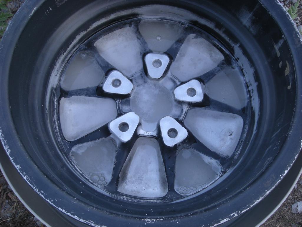

I'm using a very weak solution, 4 heaping teaspoons to about 2 gallons (10L) of water.
Takes about 30-40 minutes to strip the anodizing. I could add more and speed up the process but this is working for me.
BTW if you did forget about your rim, say overnight, you most likely would find a puddle of goo the next morning. Even this weak you can see the aluminium coming off.
This stuff is caustic so use proper safety gear and have a good supply of water on hand.

Here you can see the smut rising (that's aluminium) and a bit of bubbling action.

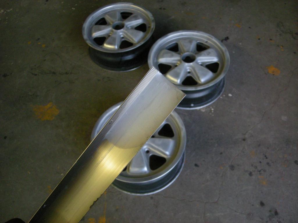

This is my stir stick/test strip, a scrap piece of stair bullnose.
You can see the anodizing is gone.

Fuchs rims are not just aluminium they are an alloy and must have copper in them, so when you do this they come out stained darker than normal. A few minutes with a scotchbrite pad will fix this.
Hard to see, but I did a quickie scotchbrite job on the bottom petal.

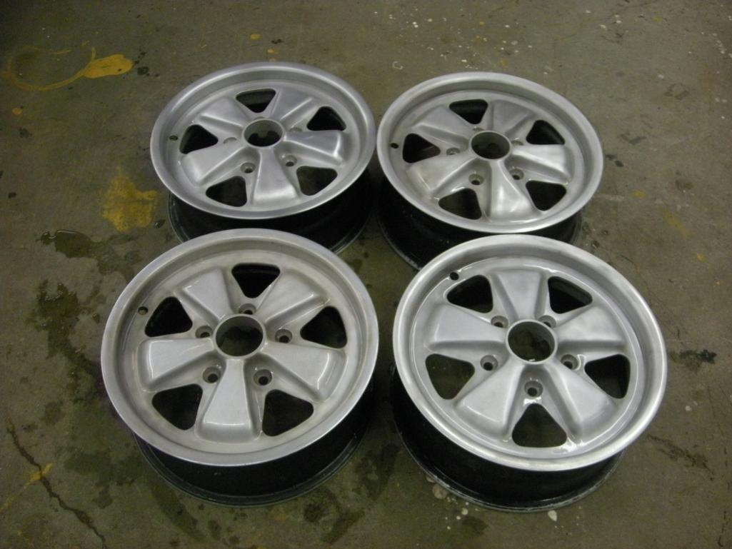

This picture the rim on the right you can see how dirty it looks straight out of the solution. The one on the left was just as bad, I only spent about 5 minutes with a scothbrite pad under running water scrubbing it.
At this point you could polish it if you want or bead blast it for the RSR frosted finish.
For the frosted you want very fine bead or since I'm a CSOB I have old beads that I'll be using.

Below is a pic of the now raw aluminium rims, cleaned and ready for finishing.
