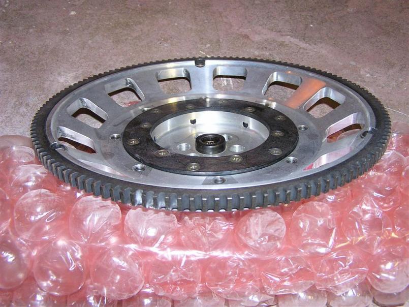

We are using this flywheel currently with an F first gear and a tilton
(similar to an on/off switch)
this makes getting started from a dead stop difficult.
