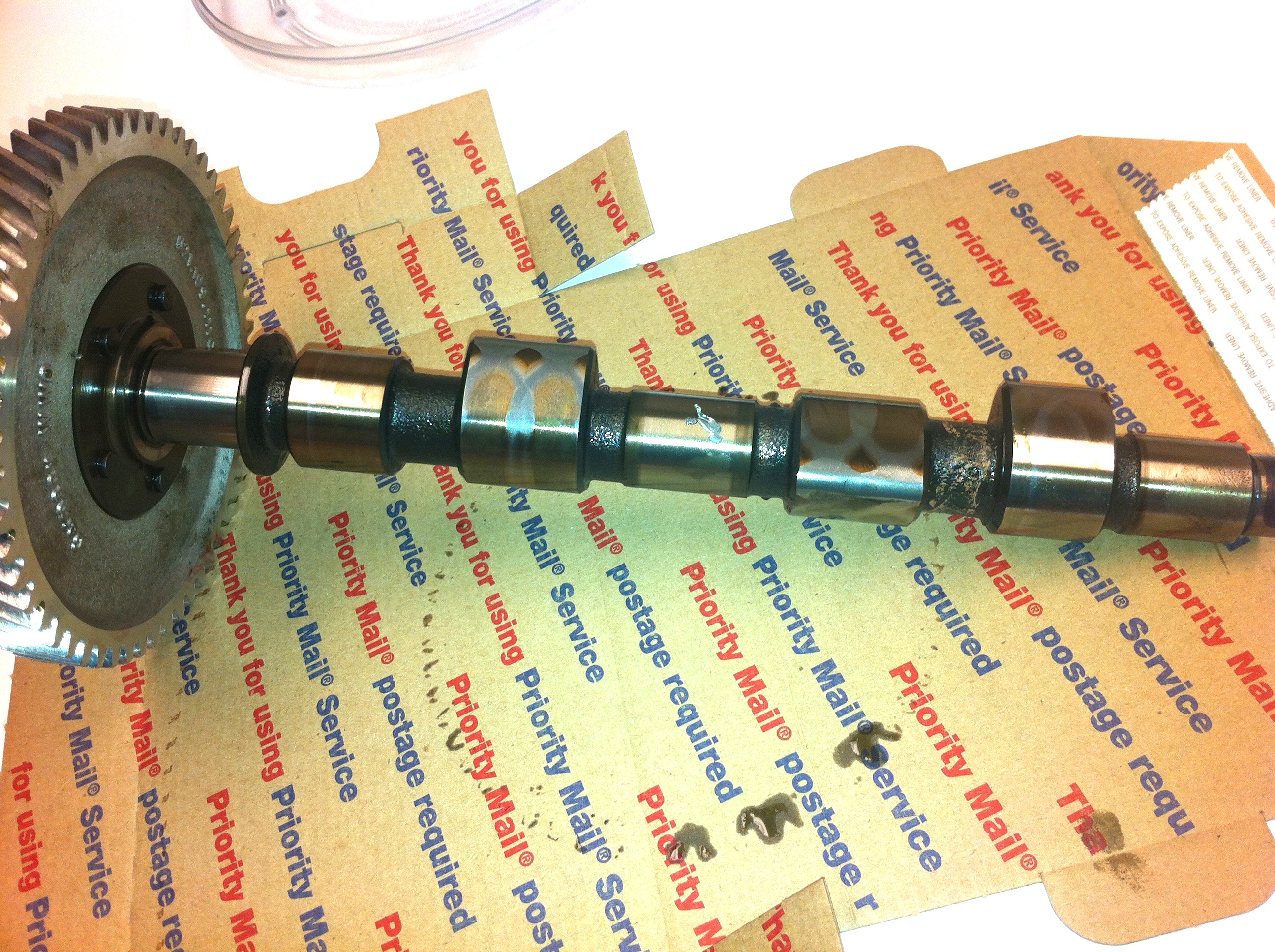

Camshaft and bearings.....

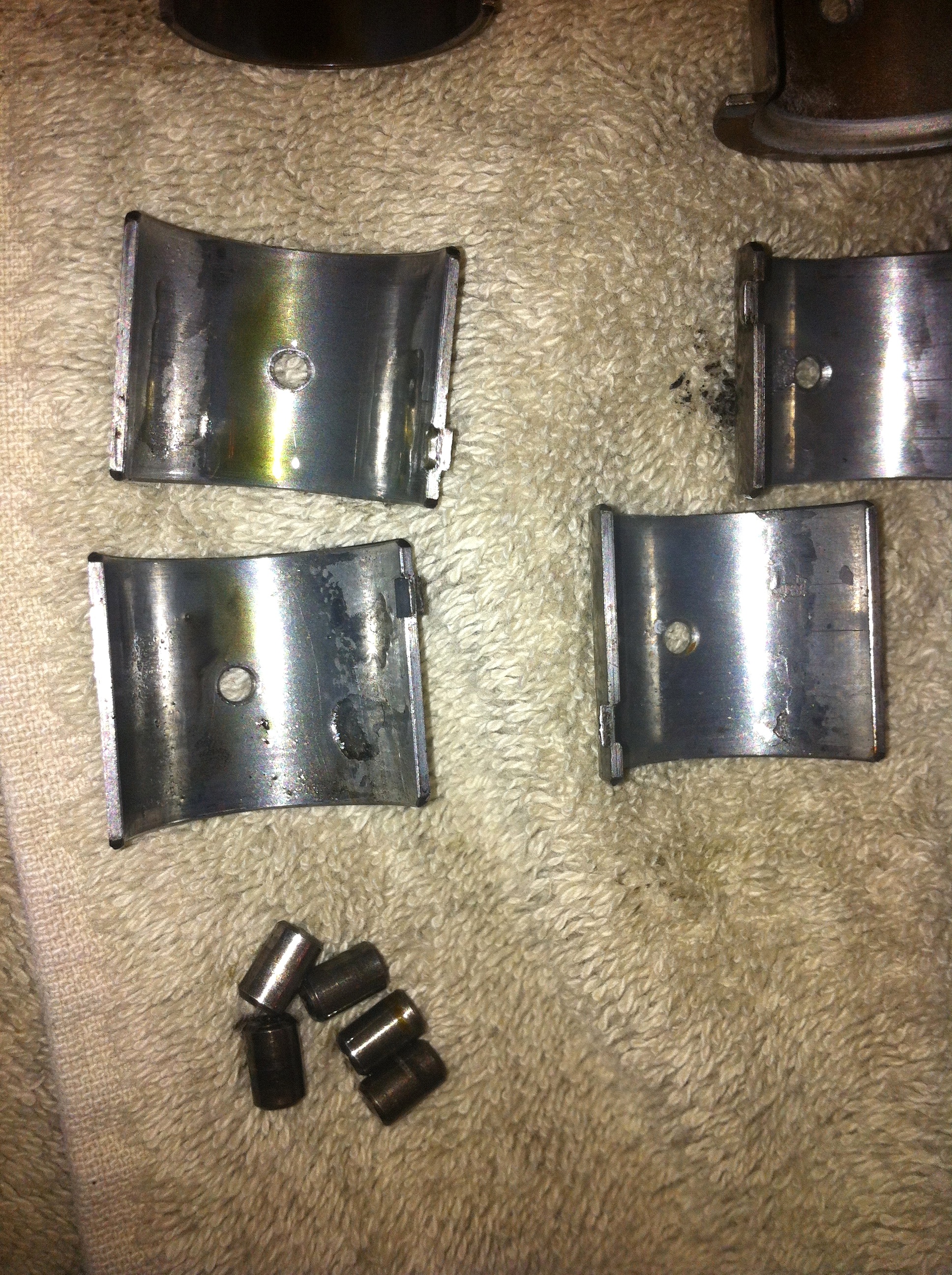

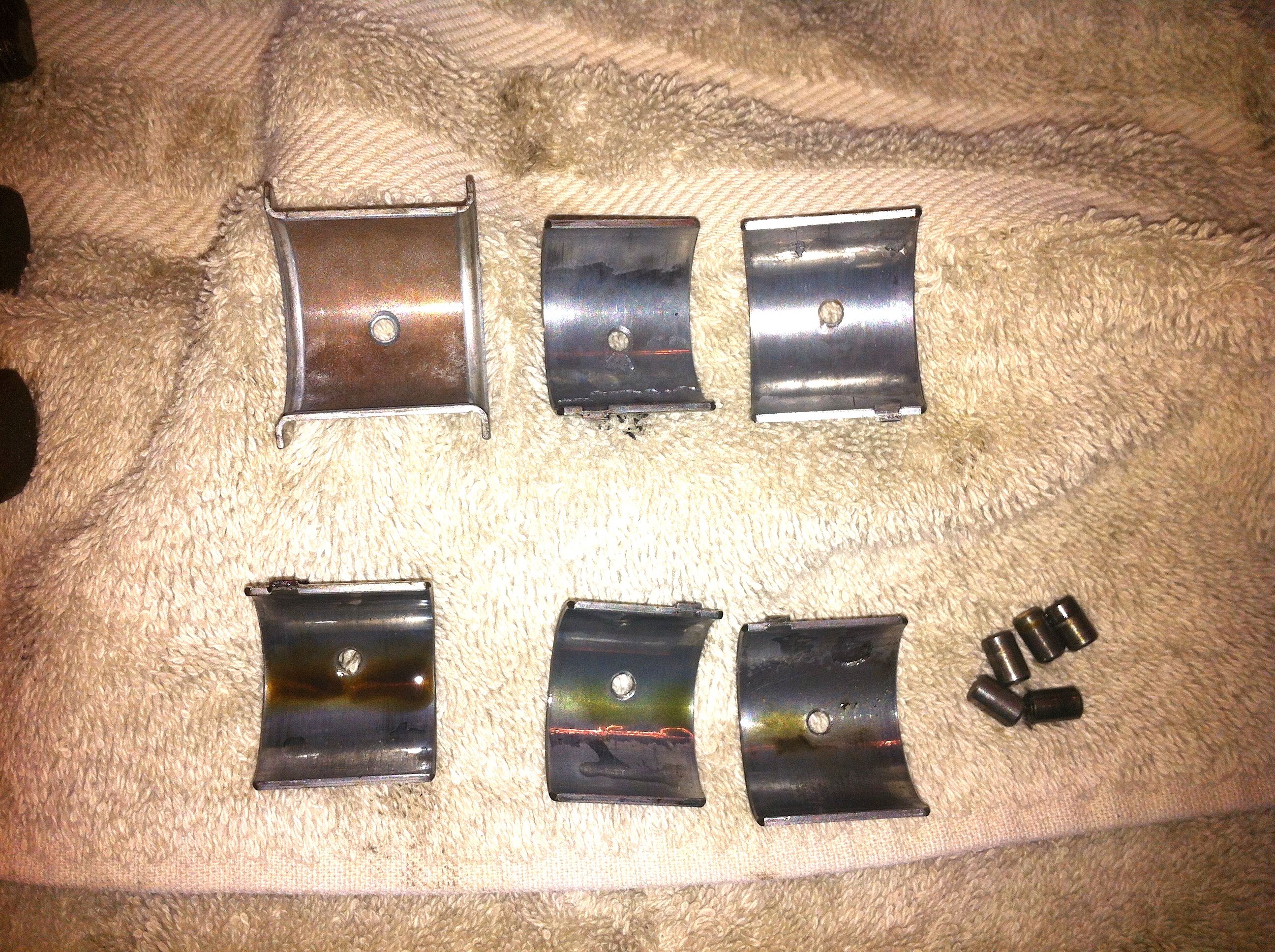

More closeup of cam bearing damage....this engine is from a 1975 car and was installed by Jim T. He also added Mahle euro pistons...
I don't know if the engine was overheated and oil starved or what; I don't know the history before it was put in the car so who knows. Also, the lifter that wouldn't come out of the case was being held back by a slight ridge or burr in the lifter bore.

Those bearings look, umm.... Not good. The cam lobe wear looks to be of the typical kind, but there's a whole lot of it. And if it's not a funny reflection, that journal on the cam has a piece completely missing!!

Hi Dave - actually, what you see on the cam journal is a hunk of bearing metal!
The cam, other than hard wear on the lobes, is surprisingly unscathed considering
the wear on the bearings. I guess that's how it's supposed to be though....
