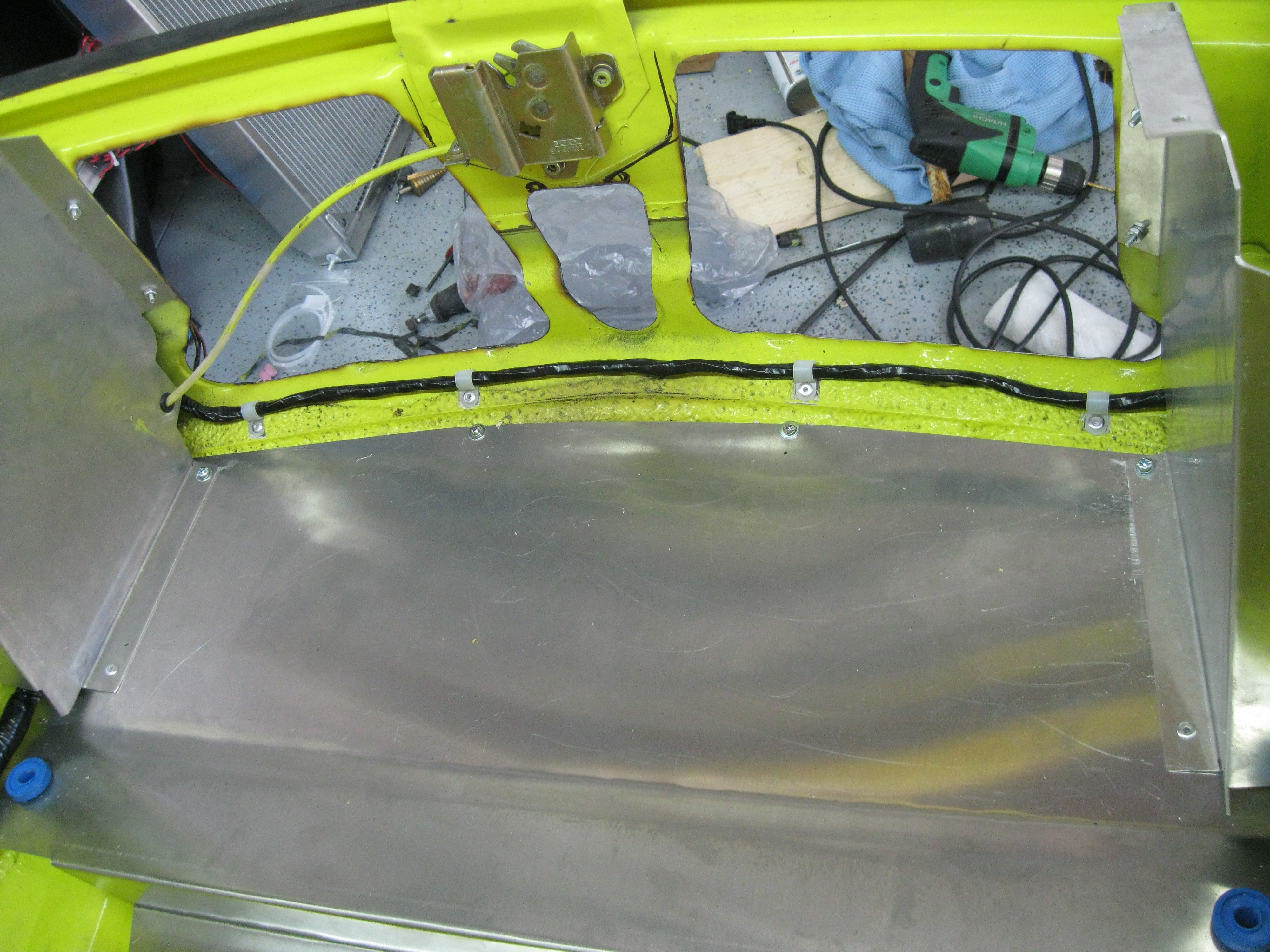

I've got the Renegade system also, and I'm very satisfied with it. The radiator has a couple of pegs welded to the bottom that fit into special grommets in the aluminum floor that's provided, so that locates it on the lower edge. I elected to secure the floor on the forward edge of the trunk compartment in a couple of places, so the springiness of the rear edge of the floor (where those pegs are) allows the radiator to float nicely.
I kept the battery in the stock location and ran a 10-gauge wire up front for power. It seems that the dual fans spike the current draw at right around 40 amps when they kick in (somewhat less when they're running), so you'll want about 50-60 amps' worth of fuse protection. I had a 40-amp fuse in there for quite a while, but it ultimately blew, so that seems to be the threshold. The Spal fans are pretty quiet for the amount of air they move!
Here's a couple pics showing the aluminum trunk floor, some of the side shrouding, the grommets (blue) and the re-routed wiring harness.
mittelmotor

second pic:
