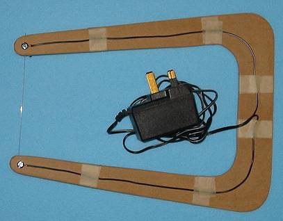

heres the best way that reasonably priced if you make it :
a hot wire cutter. it is basicly nicrhome wire and an adjustable power supply, the wire you can pick up at a hobby shop, the power supply can be a 2 amp battery charger hooked to a dimmer on the 120 v side.
simply a wooden frame making a large C shape with the wire across the open side. then hook up the charger to the ends of the wires. you can make it feet wide or as small as you want. but it does take some playing with to get the right amperage. it will do a real nice job once you get the wire taught and the amps right. could be made for less than 10 bucks if you have the wood, charger and dimmer.
more flash backs from hobby days paying off

Scott - thanks for the idea and explanation for a wire cutter. Does someone sell a small, cheap version commercially? That build would be a project unto itself (for me). That said, I may try anyway.
Doug C

a project ??? you could just nail 3 2x4 together and wrap the wire, clip on the charger. now hooking up the dimmer could be as esay as spliting the cord of the charger taking the hot side wire ( the wide prong on the plug is the nuetral ) and hooking up the two wires to the dimmer. and then lots of tape. when finished take the dimmer out and wire nut the wire back together
if i had the wire i could make this in 20 mins granted it would last as long as the project but who wants this laying arould

Look what I found with a small search.
Doug C

makes it look easy.... oh it is
