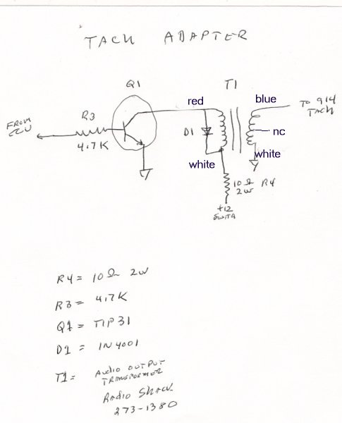

#1 Tach
Convert the 5 volt output signal from the Subaru to a high voltage pulse that the 914 tach requires.

QUOTE(strawman @ Dec 3 2012, 11:28 PM) *
I was able to chase down most of the needed parts for the tach adapter from two different RatShacks in the area. However, it seems like the Audio Output Transformer (Part #273-1380, $2.99/each) is not drawn correctly in your diagram. See the image below for details from RatShack's website:
Here is also a picture of the back of the Audio Output Transformer package:
I am assuming the following:
1. The Q1 collector wire goes to the BLUE 1K-Ohm input on the transformer.
2. The Center Tap (BLACK) wire from transformer should intercept the cathode side of the diode on its way from the BLUE 1K-Ohm input wire (anode side) to the Green 1K-Ohm input of the transformer.
3. 12V ignition power goes to resistor R4 to GREEN 1K-Ohm input on the transformer (at the cathode intercept).
4. The RED 8-Ohm output wire on the transformer goes to the 914 tach signal.
Where does the GREEN 8-Ohm output wire from the transformer go? I am not familiar with the "triangle" symbol that you used; does it signify ground?
Also, how important is the wattage for resistor R4? RatShack only stocks 1-Watt 10-Ohm resistors in the store, but I can order 2-Watt 10-Ohm resistors (10 for $1.86 from RatShack online).
Another question: what wattage is necessary for resistor R3? The local RatShack store only stocks 1/2-Watt 4.7k-Ohm resistors, but I can order 2-Watt 4.7k-Ohm resistors online (10 for $1.86 from RatShack).
Finally, where does the emitter signal from transistor Q1 go? Again, I am not familiar with that triangle symbol you used...
Thanks in advance!
Geoff
My mistake heres the corrected drawing. The triangle is a ground symbol. R3=1/4 watt R4 must be greather that 2 watts. You can use 4 47ohm 1/2 watt resistors
connected in parallel
\Attached Image

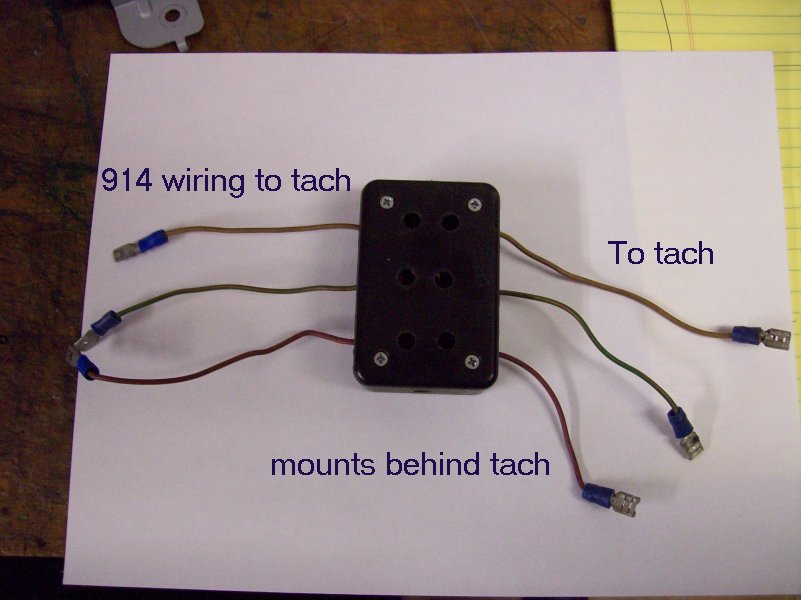

I mounted the circuit in a small case and installed it behind the tach using he factory wires

Tach adapter in first post has been change to use Radio Shack Parts with numbers

post Jan 1 2013, 02:29 PM
Posts: 892
Joined: 25-January 08
From: Los Osos, CA
Member No.: 8,624
The tach converter works! Be sure to follow the directions to the letter (I originally had the Collector and Emitter connections backwards on the TIP31 transistor). Thanks again Larry! (IMG:style_emoticons/default/pray.gif)
