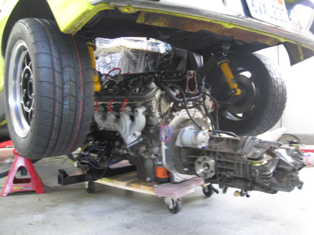

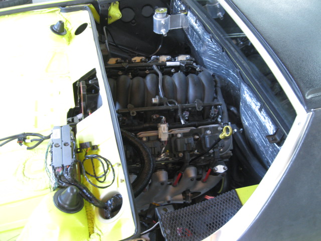

How about a narrow-body LS1 car? Sleepers are fun! (IMG:style_emoticons/default/piratenanner.gif) Fit an R-compound 205/50-15 (Toyo Proxes RA1 is my choice) and you'd be surprised how well it hooks up, being a light car, having the weight over the driving wheels, rearward weight transfer when accelerating, etc.
I fit 225s on 15x7 wheels (with some minor fender pulling and major lip flattening) on mine, and it works fantastic on the street, even with an open diff.
$5K-$6K of conversion stuff (basic kit, monster CVs/axles, radiator kit, redone wiring harness) from Renegade, and you're good to go.
--Doug

If you like the flared look and they're free, that's awesome! No clearance issues, and you can stuff in a wide tire.
As for hooking up with the narrow tires, it's not perfect, but a lot better than you'd expect with R-comps. Also, versus a C5 Vette, there's about a half ton less weight to accelerate, which makes an enormous difference when putting the power down.
As I prefer the narrow look, I considered getting some rear flares from Tangerine Racing that are very subtle, not the boxier 914-6 GT look.
If you decide on the LS1 route, feel free to PM me with any questions. I have a ton of build photos. Funny, one of the most challenging things on the LS1 was relocating the oil pressure sender...as you have to flip the intake manifold around 180 degrees, it doesn't clear the manifold. I used a series of 1/4" brass NPT fittings to get it to clear both the throttle linkage and manifold. Most everything else was pretty straightforward.
--Doug

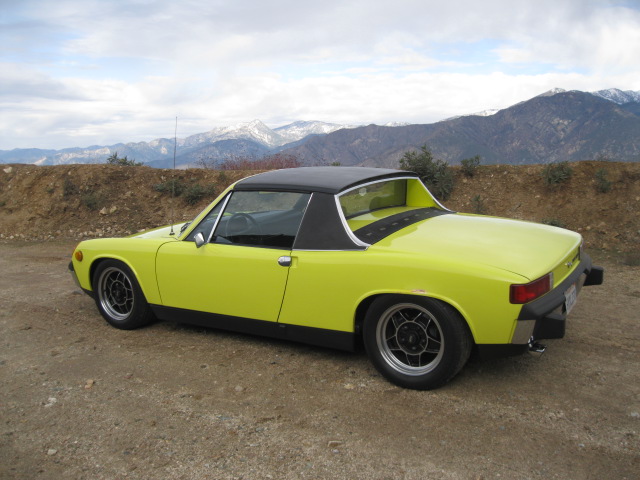

I sold my C6 Vette to finance the 914 LS1, and it's the best decision I've ever made. Vette was too bulky & steering too numb for my tastes; handled quite nicely with 265/305 Potenza RE-11s and some decent negative camber (-2.5 degrees up front). But I really missed the agility and uniqueness of the 914, and now I have the best of both worlds. As a bonus, I now don't have to mess with the fussy dogleg 1-2 shift, as 2nd gear works beautifully as 1st gear with the V-8.
Another aspect of V-8 fun is the element of surprise, provided you stay with the narrow body...mine's muffled down, has a single exhaust tip in the stock location (and a hidden dump pipe behind the valance for a dual setup) and retains the "2.0" badging. My front air intake is really not all that noticeable, as it's tucked in between the bumper tits. Other benefits: no more 3000-mile valve adjustments, better access to just about every component of the engine, easy parts availability, and the reliability/driveability of modern fuel injection.
I don't need to outrun 930s, but I do like to amaze/berate an Audi TT or BMW M3 once in a while! (IMG:style_emoticons/default/piratenanner.gif)
