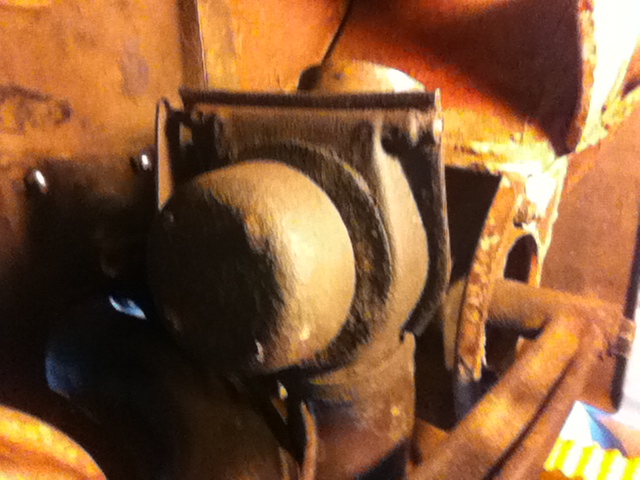

QUOTE(rhodyguy @ Jan 5 2013, 02:10 PM) *
you need a barrel nut on each of the control valve arms to secure the wire.
thanks for the reply - I think I know what you are talking about - but it seems the cable is too short and the flapper will be fixed open -
here's the thing I'm talking about - pic

with the elbow and valve (arm on the bottom) in place, how much too short is the wire? 1", 2",...

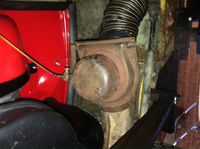

HI guys -
OK< have the drivers side hooked up as well - and both sides are about 2" short.
the reference pic I'm using has the arms on the top -
so, does the barrel of the wire - fat part - fit into the connector on the lever of the flapper box? held in place by a barrel nut?
here is a pic of mine installed, the crappy looking one. the ohter photo is a reference car that was on the hoist at mcMark's the other day so I grabbed a pic so I would know what I was shooting for. I 'think' I have mine in correctly.....
but the wires are about an inch short on both sides....
story of my life, always an inch short! ratz
sigh.
td
rhodyguy

arms to the bottom. haynes, p.15 fig.3.4. try switching them side to side.

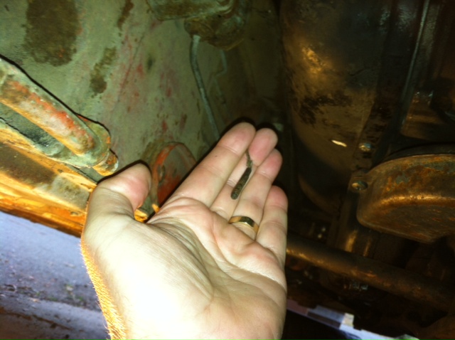

Now I'm not one to doubt Haynes - - - uh, but, wouldn't that move the problem further away not closer?
I've done a bit more poking around and while on my back, rain water running beneath me, under the car, etc etc etc - I've determined that the wires JUST BARELY TOUCH the brackets on the flappers....
sooooooo - maybe with a really long barrel on the nut, it might just work?
I'd love a pic of one that is installed correctly - but I hate to ask any of you to get into the position that you could take one! LOL Having spent the majority of the day under there - oh my. Maybe someone has a scissor lift and could just saunter out there and show me the way the Germermans want it done?
