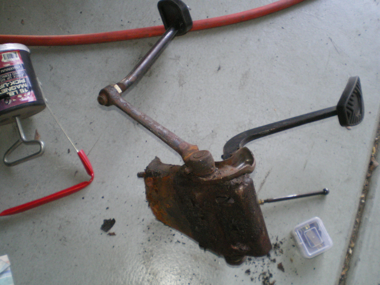

The pedal area had a little surface rust but it's a bitch to grind in that area so I phosfo'd it after a light brushing and then shot some primer/sealer on it.
Attached ImageAttached ImageAttached Image
