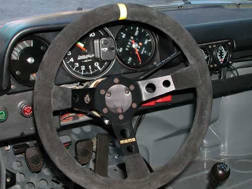

I went thru alot of trouble to extend the rpm range on my stock gauge, i really wanted to keep all the gauges with the silver point at the center.
Unfortunately I could not get the stock tach to work with my motor. Has CD box, tried the tach lead from that, the trigger lead from the dizzy, and the coil trigger but still couldn't get it to work.
Ended up getting this autometer at the local flaps, fit the hole and I have to say that the modern movement of the tach is really nice. Also has rev lite. Think the call it an air-core.
It would be great to have modern internals in the stock case.
