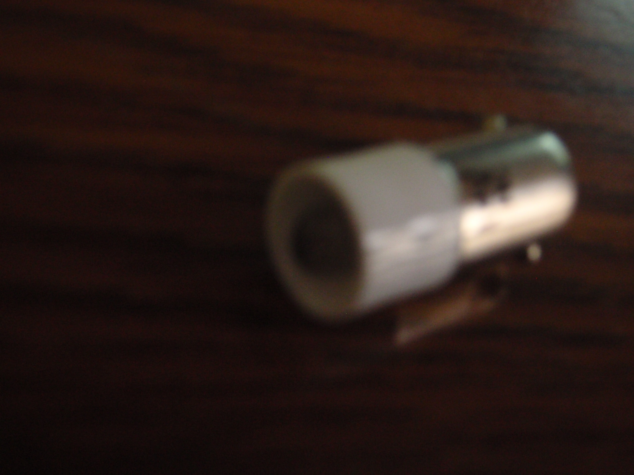

Or,
You could just do this.....
Little Ones Too......
I work for an LED Manufacturer, so I ordered these up for the car, I haven't tried them yet.
Sorry for the crappy photos
John

I've been looking at these bulbs myself, and hope you can let us know how they work out. Seems like a nice, easy way to upgrade and hopefully make the car a bit easier to see (there's a reason that I like yellow for small cars - most visible color). You might want to put together a listing of the part numbers of the LED bulbs you used.
