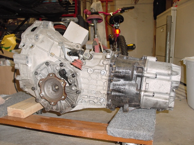

andys
post Feb 21 2013, 05:48 PM
Posts: 2,165
Joined: 21-May 03
From: Valencia, CA
Member No.: 721
I wanted to start by adapting the motor to the transaxle, which would allow me to do all my trial fitting of the assembly into the chassis. So, adapter plate, flywheel here we come!
I layed-out the transaxle bolt pattern using a surface plate and height gage with indicator. Did 'x', then rotated the transaxle 90 degrees, and did 'y' coordinants both about the center of the input shaft. The LS1 side was simple, since it has the same bolt pattern as a Gen I SBC, minus one of the holes. There are two bolt positions on the oil pan that some people don't use, but I chose to use since the oil pan is deemed a structural component. From this information, I made a master plate of 1/4" aluminum cast tooling plate (for its stability) to check the alignment.
Making the adapter plate is only part of the story, as you need to resolve the starter, flywheel, clutch disc, pressure plate, and TO bearing interfaces. Again, no one at the time made anything for the LS1, so I started from ground zero. After much research, I finally hooked up with QuarterMaster as they were so willing to field all my questions, and of course being race guys, they understood what I needed to get everything to fit up. Let me take a moment to gush at how great they were to deal with, typical Mid-Western stock car race guys that were very accomodating to all my needs; second to none in my book!
So after all the planning and designing, I started in on the fab work. I started with a 3/4" thick hot rolled steel plate and had the profile water jet cut, which I then sent out to get blanchard ground on both sides down to 1/2". I then drilled and tapped the necessary hole pattern on my mill. Final yellow zinc plating. To get the correct axial spacing, an additional 1" of thickness was required to clear the flex plate and accommodate the starter. I water jet cut a piece of 1" cast aluminum tooling plate as a spacer. I also made alignment dowel extenders to span that distance.
For the flwheel/clutch, I went with the QuarterMaster 8 1/4" button flywheel and bronze/ceramic clutch disc. The pressure plate diaphram spring that was recommended make this combo good for 450 ft-lbs. QuarterMaster does make a button flywheel with the LS1 crank bolt pattern, so no adapters were necessary. I did have to make a 1.1" thick spacer plate to move the whole clutch assembly to locate properly on the transaxle input shaft. I used a QuarterMaster spherical faced TO bearing which I adapter to the existing TO bearing carrier on the transaxle. This way, I could retain the stock TO fork and hydraulic slave cylinder.
That was long-winded....here are some photos:

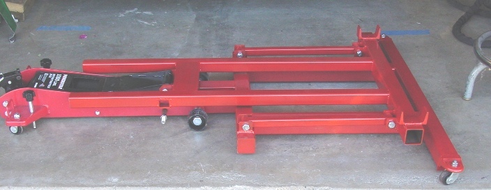

Bruce Hinds
post Feb 21 2013, 06:33 PM
V-8 madness
Posts: 764
Joined: 27-December 06
From: Port Orchard, WA
Member No.: 7,391

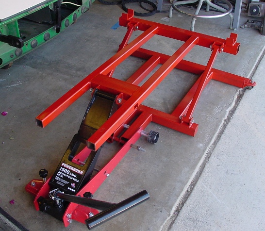

Tell us about that jack!
andys
post Feb 21 2013, 06:47 PM
Posts: 2,165
Joined: 21-May 03
From: Valencia, CA
Member No.: 721
QUOTE(Bruce Hinds @ Feb 21 2013, 05:33 PM) *
Bruce,
I spend 6 years on the car, and you ask about the jack.......... (IMG:style_emoticons/default/biggrin.gif)
Made trom an ATV jack, it colllapses down to 4". That allows me to get the motor under the car without having to raise it up so high. Handles the LS1 and trans just fine.

Bruce Hinds
post Feb 21 2013, 07:47 PM
V-8 madness
Posts: 764
Member No.: 7,391
ask about the jack!
Well yeah... the cars freak'n gorgeous and the trans setup is sweet. But that jack, that's a great piece of work.

andys
post Feb 22 2013, 10:27 AM
Posts: 2,165
Joined: 21-May 03
From: Valencia, CA
Member No.: 721
QUOTE(Bruce Hinds @ Feb 21 2013, 06:47 PM) *
ask about the jack!
Well done! On all accounts.
Did you make the hood vent, or is that from something else?
Bruce,
Yeah, I used the heck out of the jack; glad I took the time to fab it up.
The hood vent is a creation that was designed by an Art Center College of Design student, since I have zero artistic/creative skill. Modeled it out of foam, then covered in f'glass.
Andys

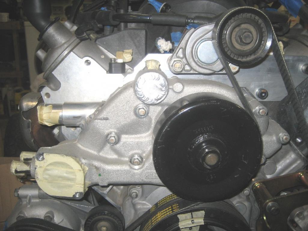

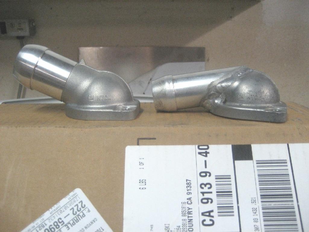

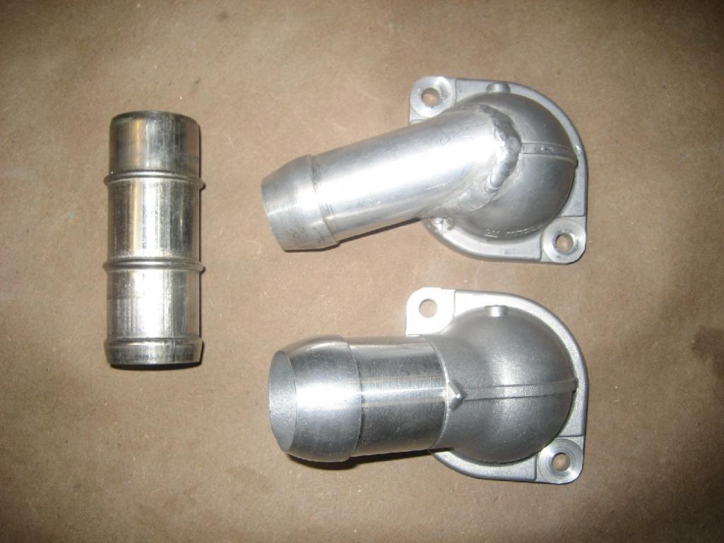

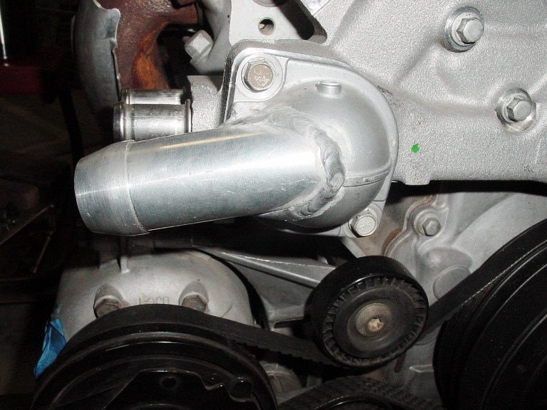

With the motor and transaxle coupled together, I now set about the task of fitting it to the car.
Initial fittng revealed that the motor damned near fits with the water pump in place, which means it still doesn't fit. After some measuring, I determined that if I use the LS2 water pump with the short pulley, I'll reduce the length by about 2" (from memory, which is not that great anymore). Found a brand new LS2 water pump on Ebay along with a LS6 Vette crank pulley (which is also shorted than the LS1 by some 3/4") to line up with the water pump. Fitting again revealed that I would only need to move the firewall hump into the cabin 1 1/8" to get everything to clear......well almost. The water pump outlet points straight forward into the firewall, so I needed to re-think that. Some of you may think why should I goof with the stock water pump, when a remote mechanical or electric water pump (Meziere) might offer an easier solution? Well, frankly I like stock components over aftermarket as they are properly engineered and designed for dependability. Another issue that led to my decision, was the need for a properly configured thermostat, and heater hose and valving. To resolve the water pump outlet, I capped the original outlet, drilled a hole pointing toward the passenger side, machined a new neck with barb for a 1 1/4" hose, and TIG welded it in place. I did a similar thing with the inlet side; I machined a neck with barb, and TIG welded it to the stock thermostat housing in a more favorable position.
