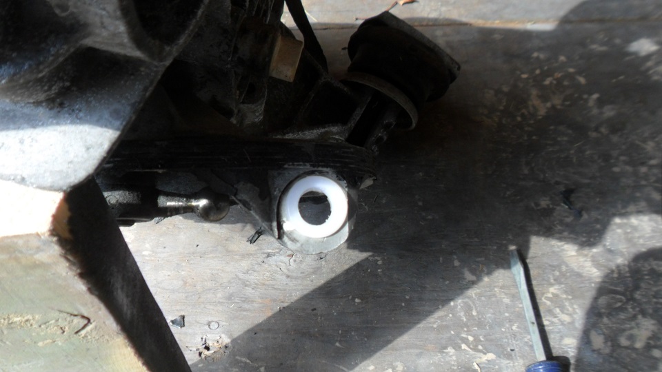

Bought a shifter bushing kit and started installing them. Firewall and "180 degree forward linkage bushings" that connect to she shifter to the linkage have been installed. My question is, where does this one go? Thanks!

I think that this is the one on the firewall

Pretty sure that goes into the console on a side-shifter. The firewall bushing doesn't have the four "tabs."

I concur with George.
Scaling to your fingers, too small for firewall.
Plus I think the firewall has a solid inside ring.

(IMG:style_emoticons/default/agree.gif) with the concurer above ...

Just installed all bushings in my car Friday night. Those guys are correct, goes in the rear.

Once it stops raining, I will venture to the shed and check out the console on the transmission.

Correct - it goes on the tranny under the cover. Boiled it in hot water and fired it in:
