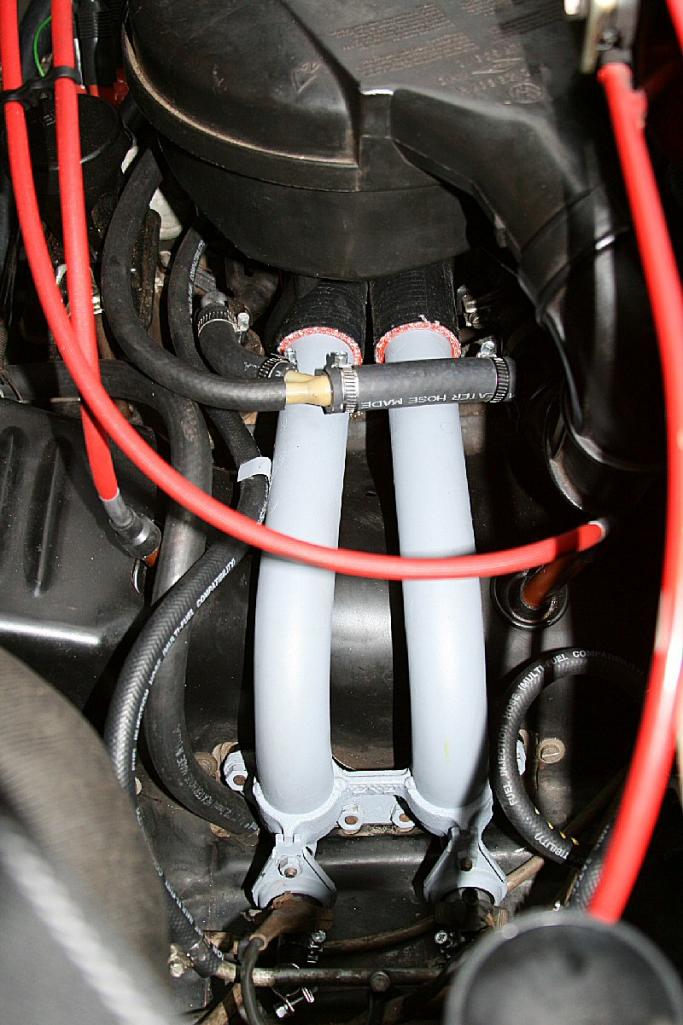

If the intake hoses are 40 years old, they probably need changing. Don't forget the Intake Manifold Gaskets too. Pelican Parts sells both. At least you will eliminate this potential vacuum leak source. Sounds like you are on the hunt. Keep it up, you will eventually find the leak.
While you have the air intakes off, sand and spray paint them. It will really dress up your engine. See picture.
