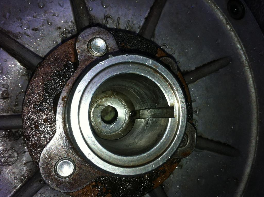

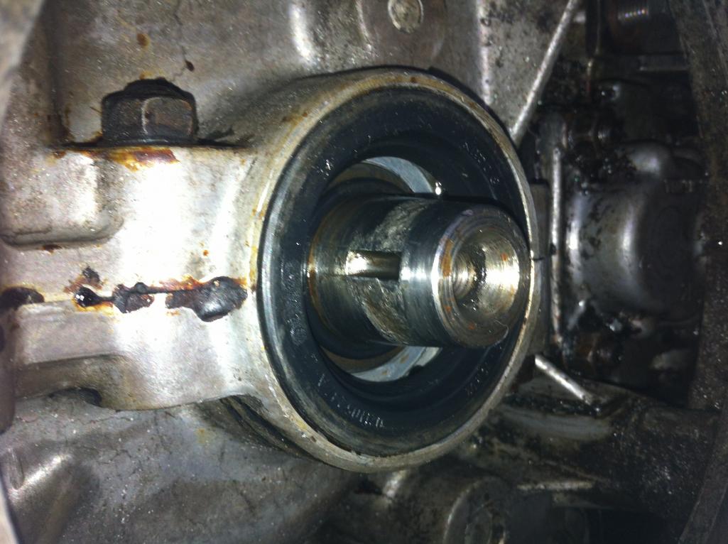

I'll post pictures later this evening (I'm shipipng now). It's amazing. the keyway is still good and the crank slot is still true. I'll put it togetehr and check, but Taylor may Have go Lucky!

Amazing this was simply able to bolt back together with a new Key.
