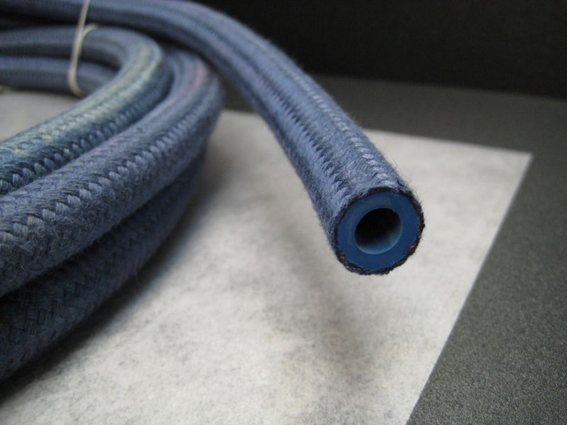

This is the VW brake line that I used:
http://www.ebay.com/itm/VW-Volkswagen-Blue...b1e&vxp=mtr
Here is a pic of it:
