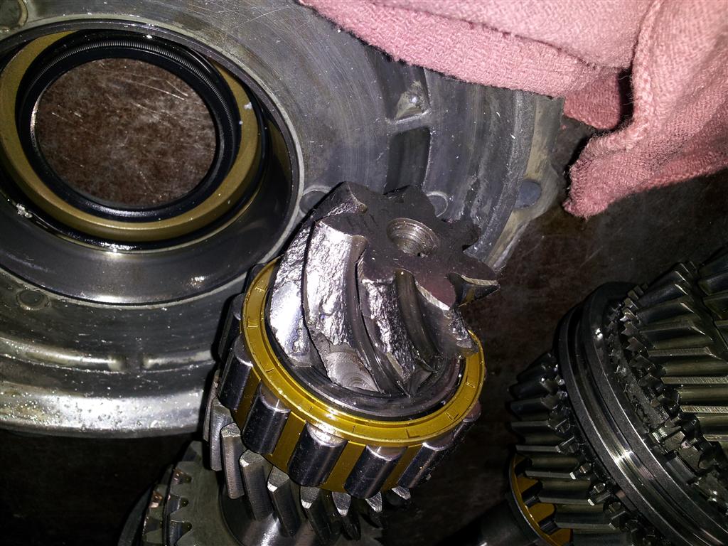

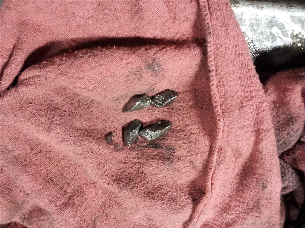

(IMG:style_emoticons/default/agree.gif) The backlash and contact pattern go work together to make the (sliding) contact area large enough and in the right place. It doesn't have to be dead center but that's ideal.
Years ago I broke a pinion tooth by setting the proper backlash and the wrong contact pattern. Bad juju that.

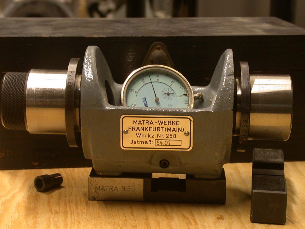

QUOTE(Dr Evil @ Apr 16 2013, 10:58 AM) *
I use the factory tool, or at least a clone of it.
Photo below of factory tool, P258, with all accessories.
This tool will only measure pinion depth; other tools are needed to determine ring gear backlash and differential bearing preloads.
I'm curious to see the clones being made.
Jon B.
Vista, CA

QUOTE(Jon B @ Oct 8 2013, 12:49 AM) *
Jon B.
Vista, CA
Mine was made by a machinist and has the same dimensions as the factory tool. I only have to use it when replacing R/P for failure of inspection or traumatic failure. Most of the time, and I have covered this extensively here and in my DVD, I instruct people to measure gaskets and maintain factory set specs. The vib issues is not much of a concern in the small increments we deal with. It is mainly a nuisance. Many other manufacturers do not do the finite test in leu of just matching patters with dykem or other indicator to a visual pattern.
